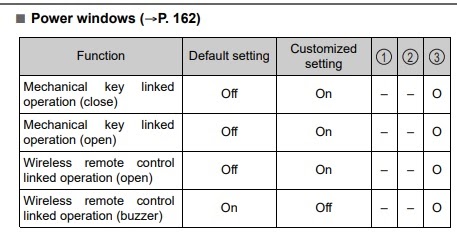

roll up and down windows from key fob
Thanks, but these are all old posts.
Any new changes with 2020 , and do you really need the dealer to program it ?
Can you also program to auto close from remote.

You have to go to the dealer and they will program you unlock button to open all windows except for the hatch

Any such option can be changed via the headunit now. Normally there is no option to close with the fob but there is to open.
Edit: Not window options. Read your manual.
Page 554 of the manual that no one reads...you have to go to the dealer or get a Carista or similar OBD2 dongle to change these settings. That's what the O in column the 3 means. These are you only available options with the door windows.

Ok, so it seems that there is a way to program to open windows, but not close them from fob. Someone please confirm....
