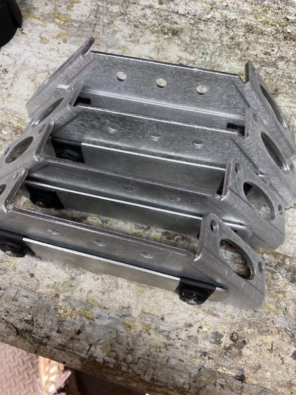

Started with the rack legs, they come with all the hardware. Only took about 4 days to arrive from NiseRack. Great job there.

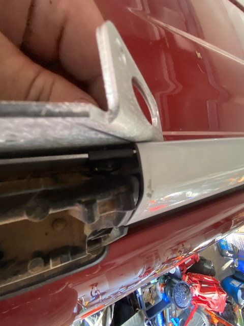

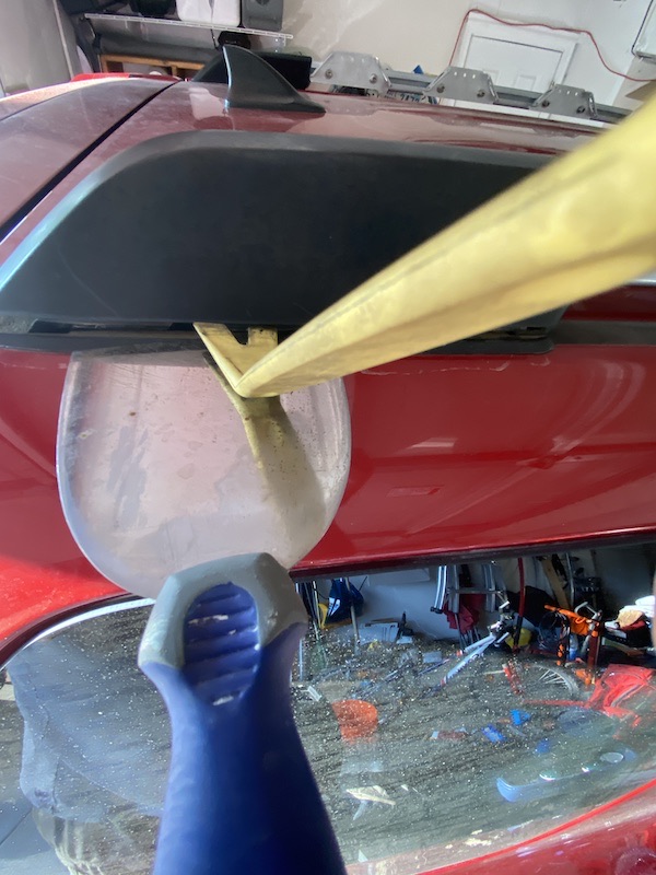

Pry the end cap off of the roof rails. I used a wide scraper to distribute my wedging load, so as to not dent the top of the truck. Worked well.

Then the brackets just slide into place. I ordered 4 "sets" of brackets, which will give you left and right brackets for 4 rails. I found if you loosen the bolt a little at a time, while you insert into the rail, it goes in well, and then you can tighten a bit by hand as soon as it is slid in.

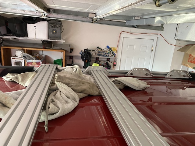

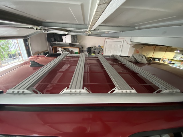

After all brackets are on (I had 8 for 4 crossbeams) , slap the covers back onto the rails and then attach the crossbeams. I used an old sweatshirt to hold the far side while the first went on.
Once everything was on, I tightened everything up and was good to go. Great rack. Entire rack system was less than $300, so a big saving over a custom full or 3/4 rack.

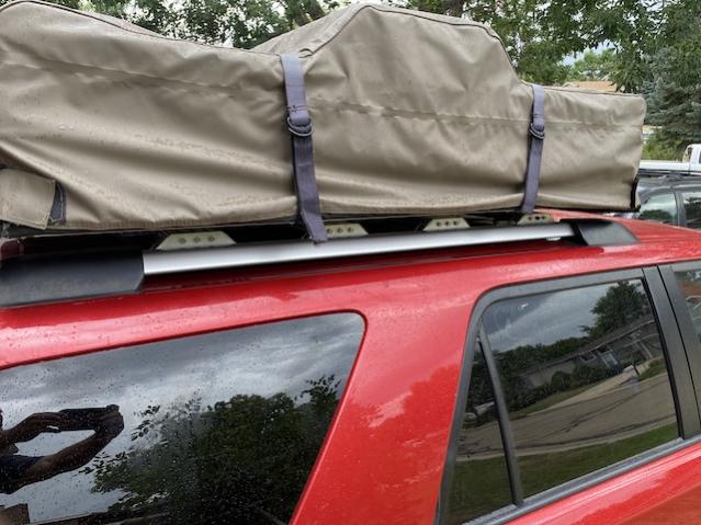

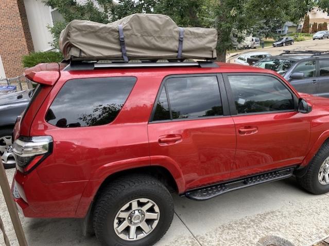

Rtt
Final piece to the job was the Roof-Top tent. I have a 23zero tent, soft shell, and absolutely LOVE it. Has been a great way to camp, get yourself off the ground and get some great sleep. Brackets fit really well over the 3' wide crossbeams and are solid. Tent pretty much goes from end to end of the factory side rails, so does not look out of place.

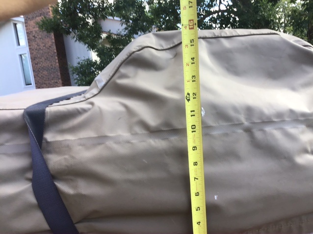

Looks great! A couple questions. 1. How hard was it to bolt the tent onto the rack? I'm thinking clearance under the tent to attach the hardware. and 2. How high is the top of the tent from the roof of the runner? I'm wondering if it will fit in my garage.
Tent bolts were about a 1 hammer difficulty on the “outside” bolts and about a 3 hammer difficulty on the “inside” bolts. Helps to have a family member with small hands and limber wrists to get the nuts started.
Tent sits about 16” above the rack. No way mine goes in the garage, but my 4R is also lifted with 285s.
