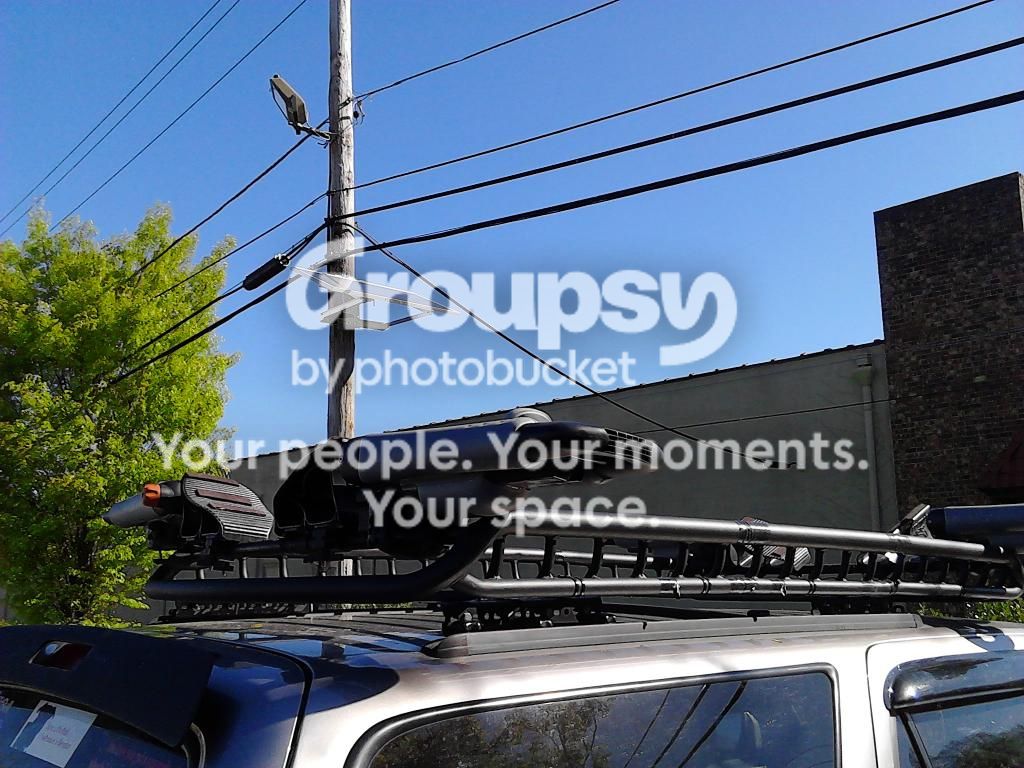

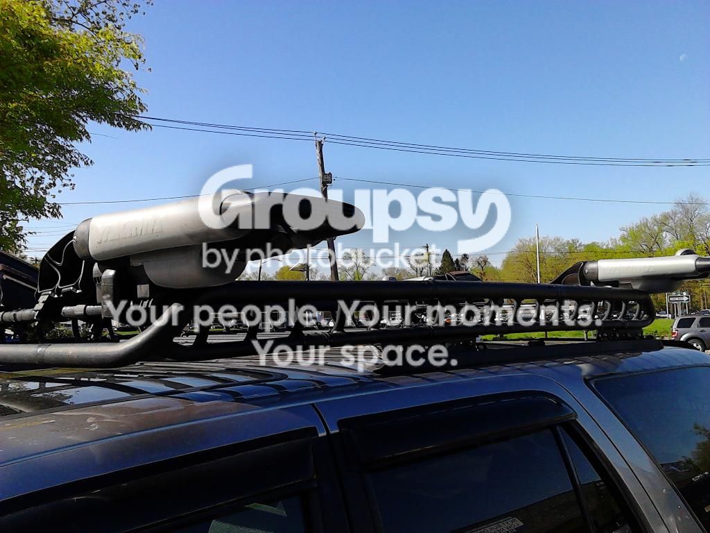

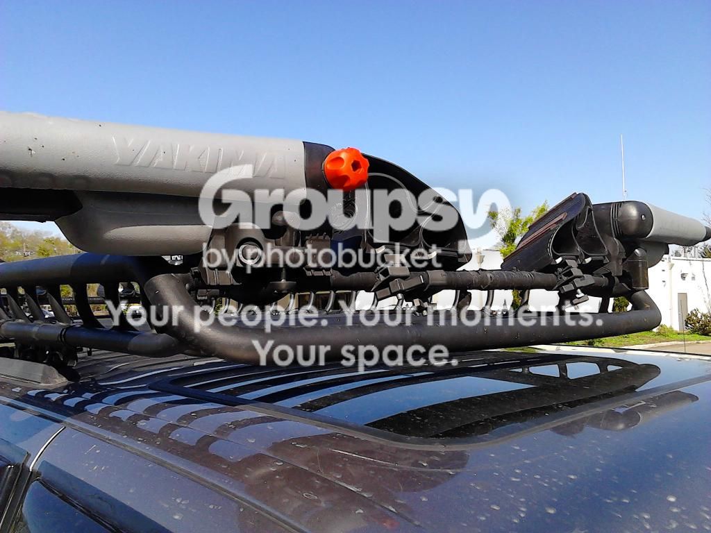

So I need some opinions here. I have the Rola roof basket setup with extension installed on the truck now. Since the time I installed it I became more into kayaking and carry a few kayaks up there. This unfortunately has presented a problem since the Rola rack is bending down with lack of support over the sunroof since the roof rails end behind the sunroof. Im afraid one bad bump and the rack could smash my sunroof. So I have some options here....

What about some weld-on adjustable feet to add leading edge support?
I believe the Whitson rack employs this concept? However, care would certainly
need to be taken to ensure wherever it contacts the roof there is at least
a modicum of structural support underneath it.

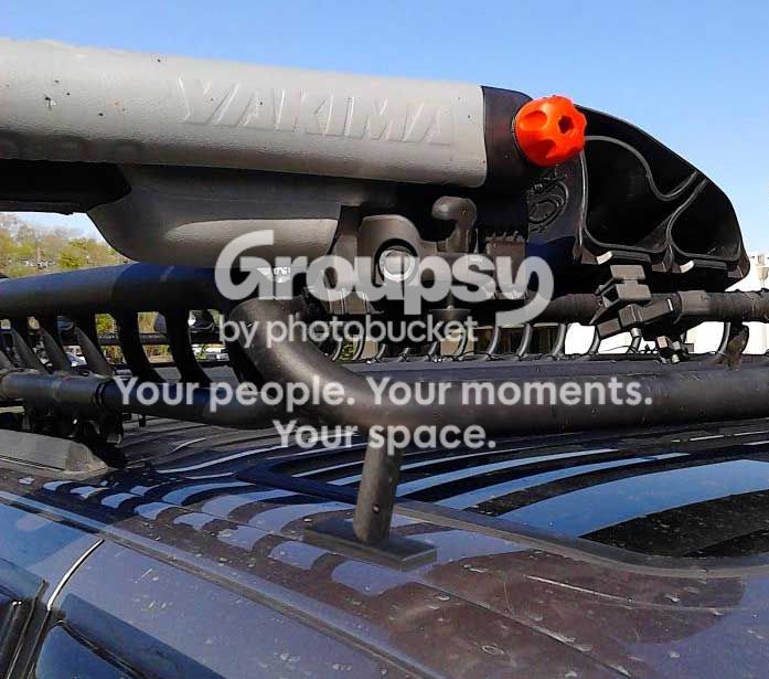

Similar to this:
rola_zps59c1f278.jpg~original
Also - is you Rola welded together, or still just screwed?
I was thinking of doing a foot setup like that however I figured I would have to strip the powdercoat off and find someone to weld it so I was going to try and screw something in. The rack is screwed together which is partly why I think its bending.
