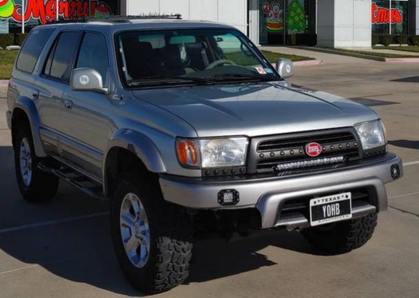

I just took off my tall crossbars. I am going to paint the rack silverish to blend in more with the roof. I thought about deleting it, but again, the strips are discontinued. Another idea I had was some Flat Aluminum Strips painted silver gray or black, drilled to bolt in the OEM spots.
