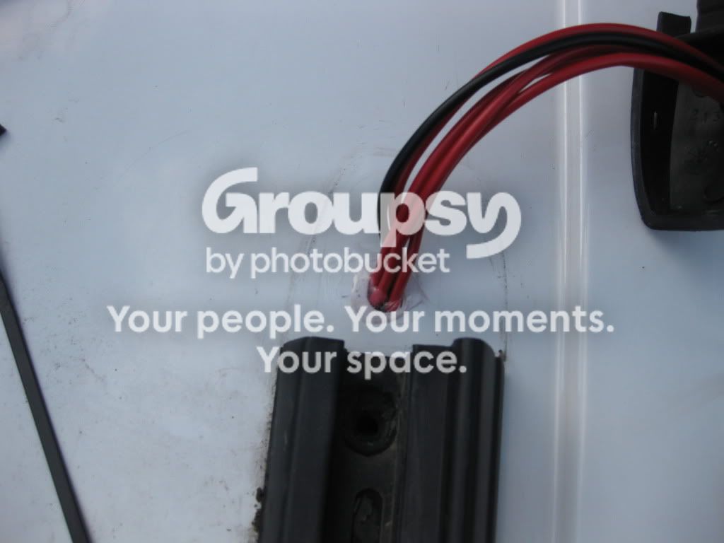

I ran mine through the hole underneath the factory rails that [MENTION=46329]blcktpgsr[/MENTION] is referring to.
IMG_0007.jpg~original
Also, here is a link to some more info about how I wired my roof lights up.
http://www.toyota-4runner.org/accessories/121387-yakima-loadwarrior-build.html
which clear silicone did you use to seal that wired hole, and how well has it held up so far to the elements?
Hey I used Seal-All, a general sealant and adhesive that you can buy at pretty much any home improvement store. I only had it on for about a year because I ended up switching to the better plug/receptacle, but it help up great during the time I had it on there. Never leaked and held the wires in place without an issues.
