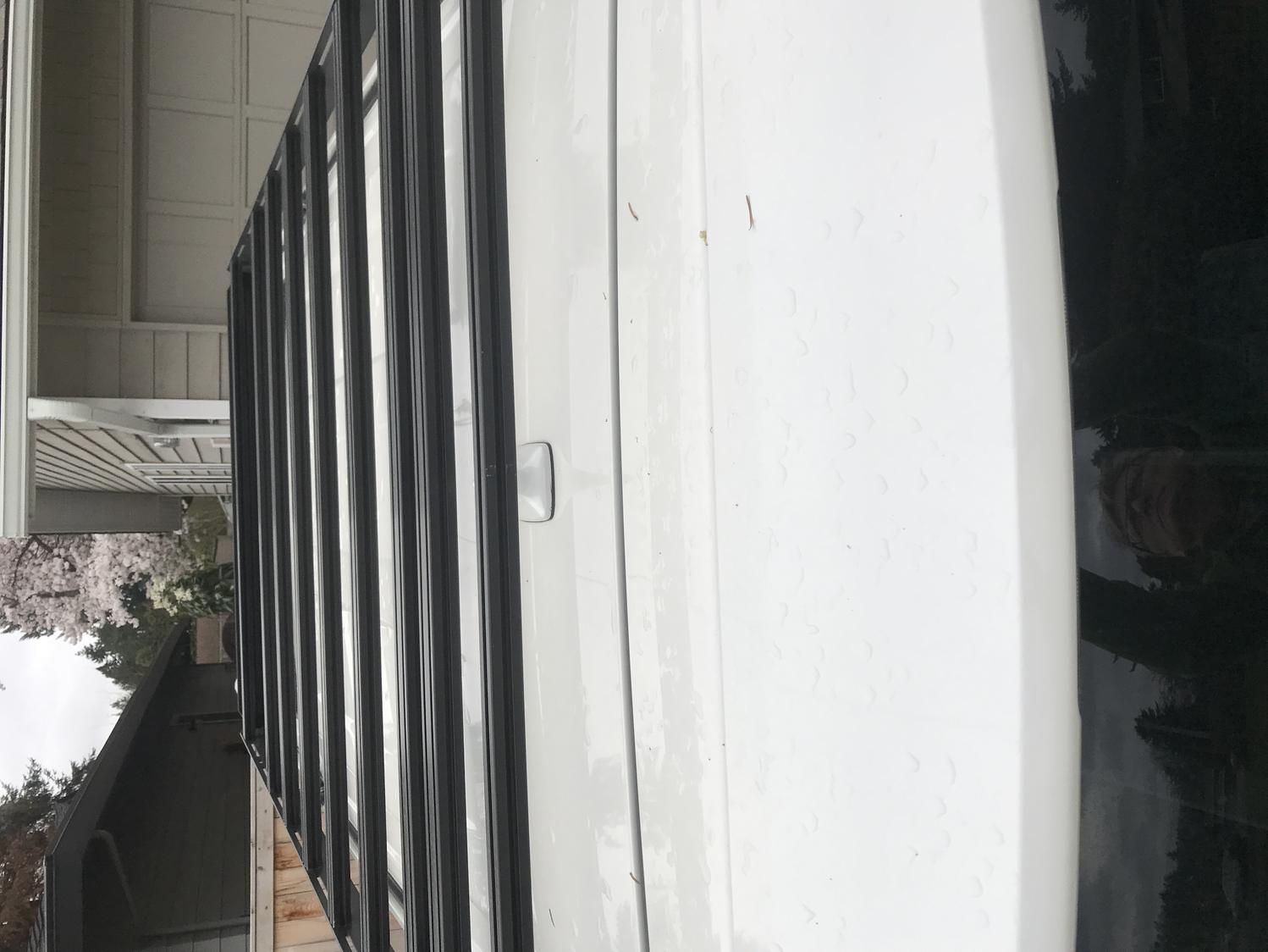

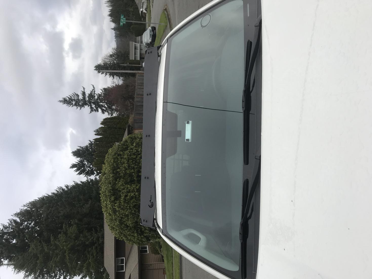

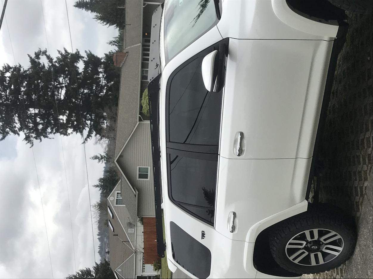

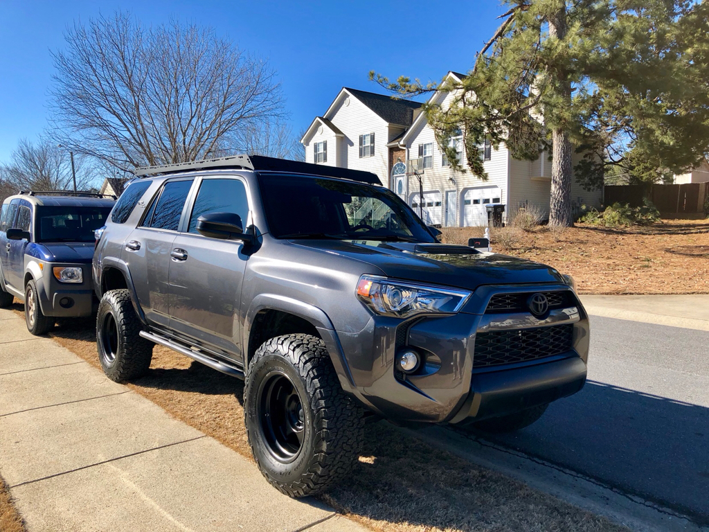

Here are some pics. Best to check with Prinsu for the load capacity of the cross members. Then check the weight of the tent. Devise a mounting strategy to distribute the weight correctly. Camp at will.

Thanks for the pictures. The rack looks great! I also like how theres an option for the light bar cutout on the wind deflector. Ill definitely get the weights for the 2 RTT I'm debating on getting and check with Prinsu about load capacity.

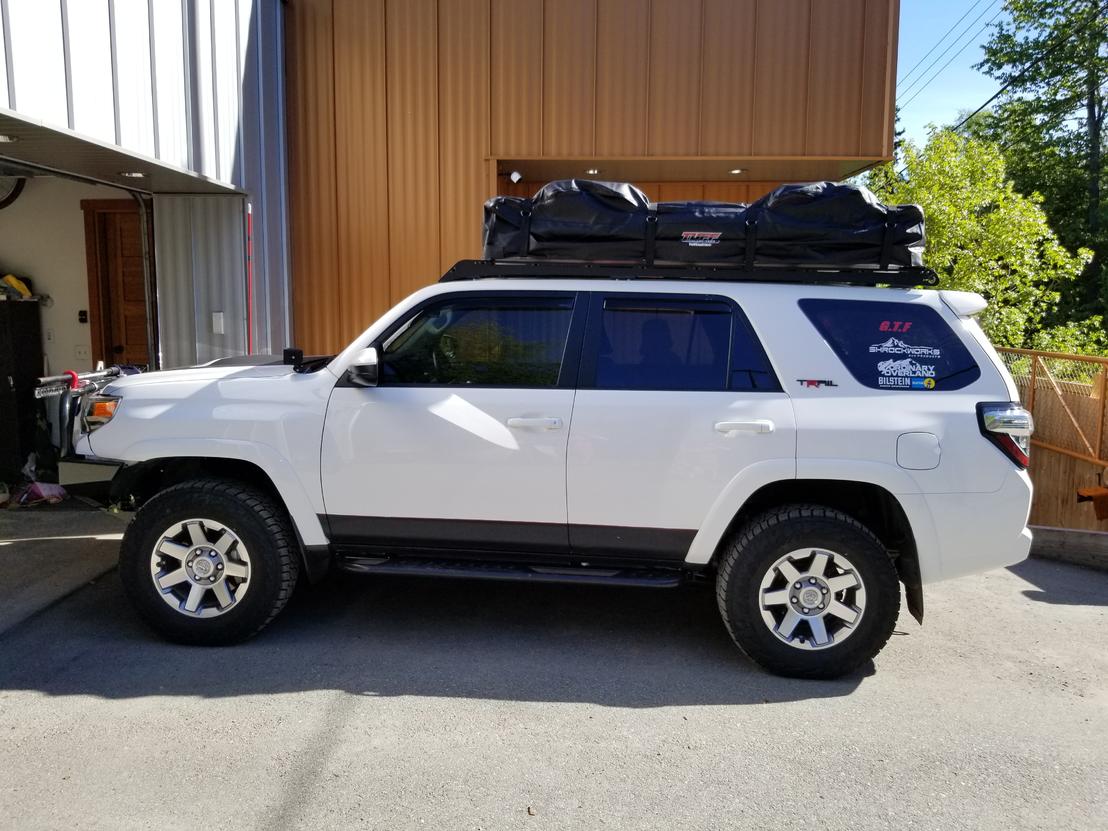

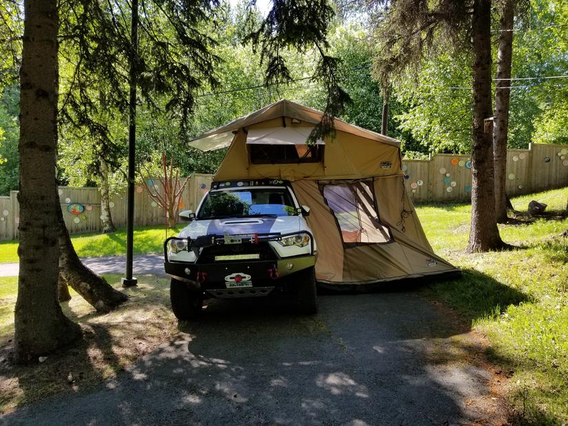

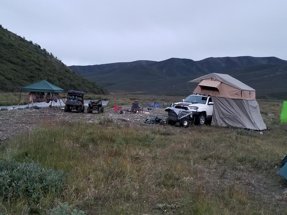

This is the tough stuff elite 5 person tent, I have used this with no problems with my wife and 2 kids sleeping in it.

It is a pain to try and fit your arms in to tighten the attachment bolts so I taped a wrench to a paint stick. when I took it off for the winter I just unbolted the cross members that it is attached to and removed the tent with them attached. There are plenty of cross bars so they were not really missed.

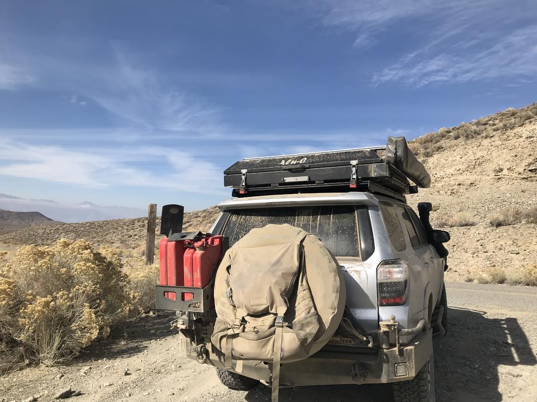

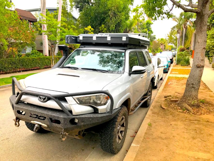

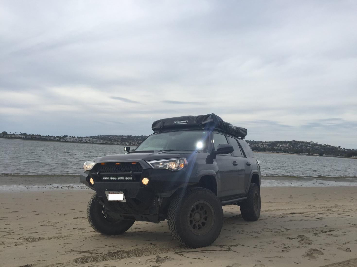

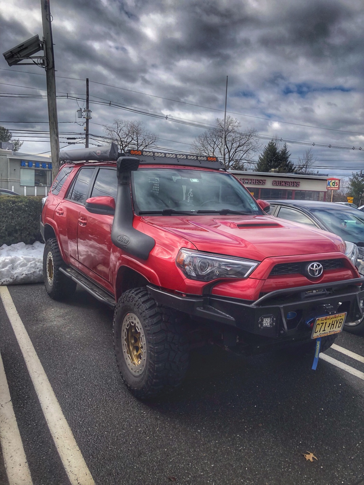

I have a Prinsu and a FSR Adventure series tent.
Individually they are awesome. Together they're a pain in my a$$.
I have to remove my tent every time I get home because I don't fit in the garage. I'm looking at other options to raise the tent in order to get my hands/arms in positive to reach the screws every time. I can get my hands in through the back just barely with a ratcheting wrench. The front I have to remove the windscreen from the rack.
I saw someone on instagram who bought and used the extra mounting foot for topracs:
www.prinsudesignstudio.com
They have model that could raise the tent up 1.5". That and the approx. 1" channel from the tent may be enough for me to reach the nuts. At $120 a pop though, I almost feel like I should just cough up another 180$ and get the frontrunner quick connects:
https://www.frontrunneroutfitters.c...gs/quick-release-roof-top-tent-mount-kit.html
I also removed my awning b/c I thought it would be great to just remove the cross bars with the tent, but that was a mistake. Don't do that.
I'll let you know if I actually spend money and do something about this.

Great information...and pictures. Almost lost my train of thought looking at your front bumper lol. Ill save that for another time. But yes, if you do anything to make things easier for you, please let me know. The mounting foots for topracs look good but if the quick release from Frontrunner is a better option, id like to know. Im not planning on keeping the RTT on top of the truck all the time so an easy way to get in on/off would be ideal.

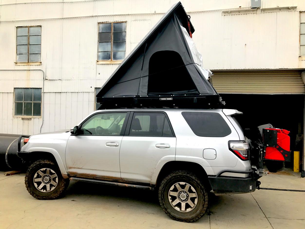

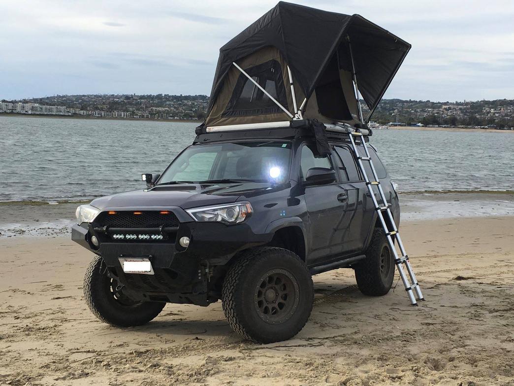

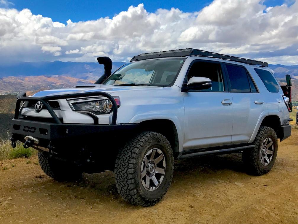

I have a Prinsu full rack. Have had it for a over a year. Love it. I hear people love them even more now that CBI bought out Zach and lead time is more consistent.
I have walked on mine. I weigh 185lbs.
I don't have small hands. I did mount an Alu-Cab RTT on the rack, pretty much entirely on my own. I've adjusted it entirely on my own. And although it was a bit of a hassle, it was not the end of the world, nor even cause for much concern. In fact, I wouldn't have even thought about it others hadn't mentioned it here.
I've also walked on my RTT on top of the roof rack and everything has been great.
And I don't know what issues others have had with their moonroof, but mine is just fine. Although I don't need it much now that the RTT is up there. Still I open it up for air circulation when we're long hauling and there's never been any issues.
The thing that you can do with the Prinsu that you can't do remotely as easily with other racks is order extra crossbars that you permanently fix to your RTT. Then you can build some sort of hoist system with a gantry crane or something, to unbolt the crossbars from the rack and theoretically remove the RTT. I should let you know though that I intended to do this, but frankly it's just too much of a pain lining up the bolts and finding center of gravity to do this as efficiently as I hoped. So I just keep the RTT up there all the time.
It's a good rack.
