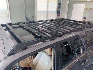

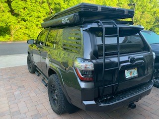

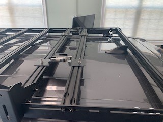

I did this last weekend. The Front Runner bolts wont fit in the Prinsu rack's track so you need to get 1/4"-20 carriage bolts and lock nuts to fit the track. Pretty easy setup.

Do you have any better pics of how high this is off the rack? I've been thinking of doing the exact same thing. I'm tired of wedging my arms in there trying to bolt the tent down! I'm currently using Prinsu's 1" mounts. They work, but there's not much clearance.
