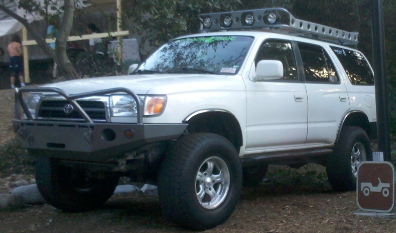

I am not having any glare from my lights, but still working on aiming where they need to be. I am currently running the Vision X 4500(4510& 4512) series lights up top. They are a 100w hybrid halogen light that are upgradeable to HID. The outside lights are Eurobeam and the two inside lights are Spots. I do agree the best placemeant for lights is usually on the bumper or combination bumper and roof. As Baja and others have said you can get glare but there are some things you can do to minimize that. A small shield at bottom of light, paint the roof edge or hood with a flat dark color. I read of a guy on another forum with an FJ put vinyl wrap on his hood with the gray Carbon Fiber look and it worked for him. I would say the top 5 Halogen/HID lights in no particular order, PIAA, Light Force, Vision X, IPF, Baja Designs.

Where do you get your roof rack? F#$King awesome! :guitar2:
I got it from Outdoor Logic. Mine is a test fit of one he was making for Jeep XJ's(Cherokee) that I converted to mount on my 4Runner. I put a cheap rattle can job on it but soon it will be powder coated to match my front bumper. He has made a couple other ones and has some cool design ideas for a low profile one. He made a nice one for DLAK's 5th gen.
Thank you for the compliment. I had one of the first BajaRacks and when I saw this one from Outdoor Logic I felt it tied in to the look I wanted better and seemed more functional.
