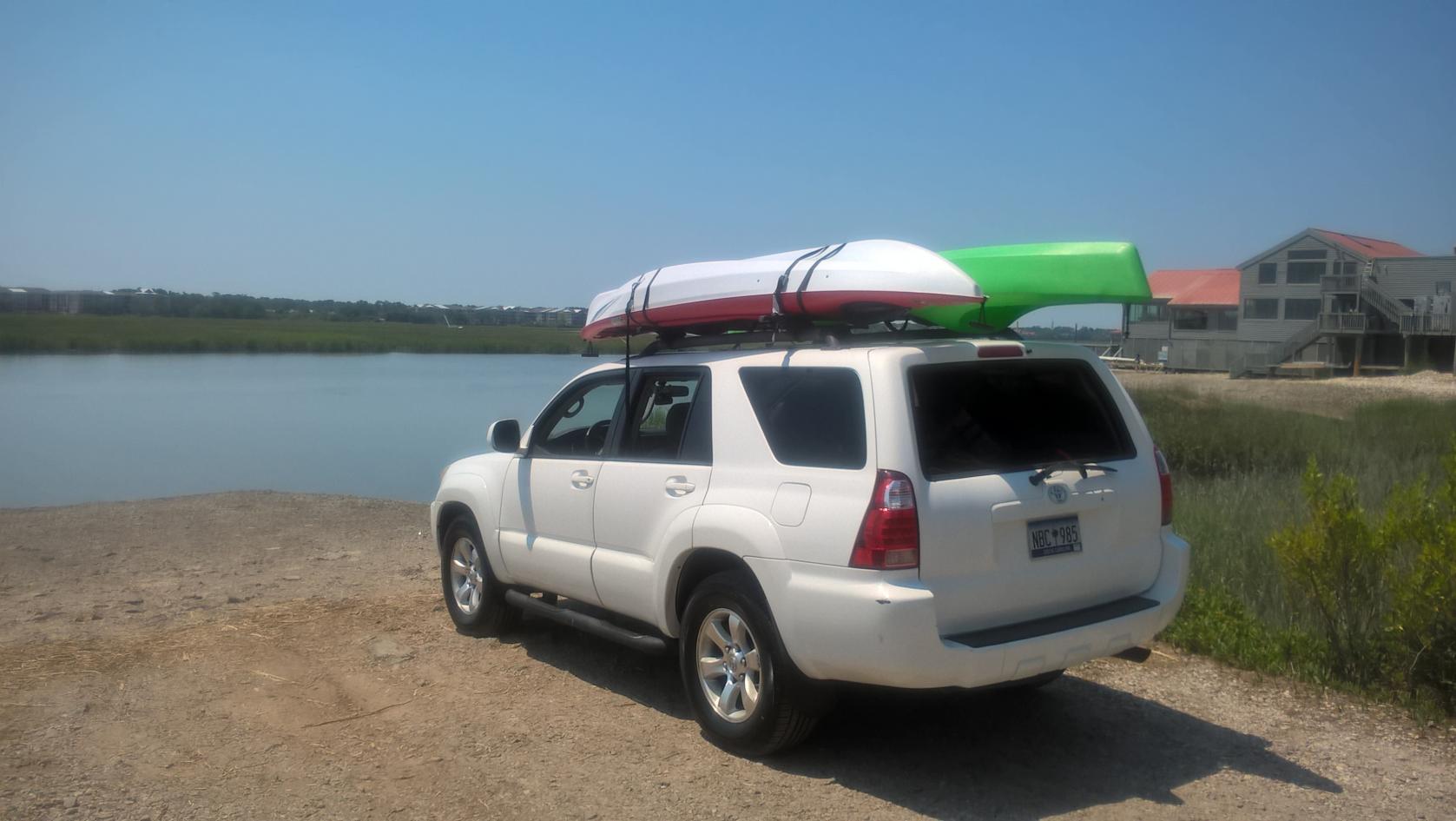

Kayaks and oyster roast tables.
For anyone searching, the Thule Crossroad feetpack fit the tubular sport rack perfectly with the 58 LB.

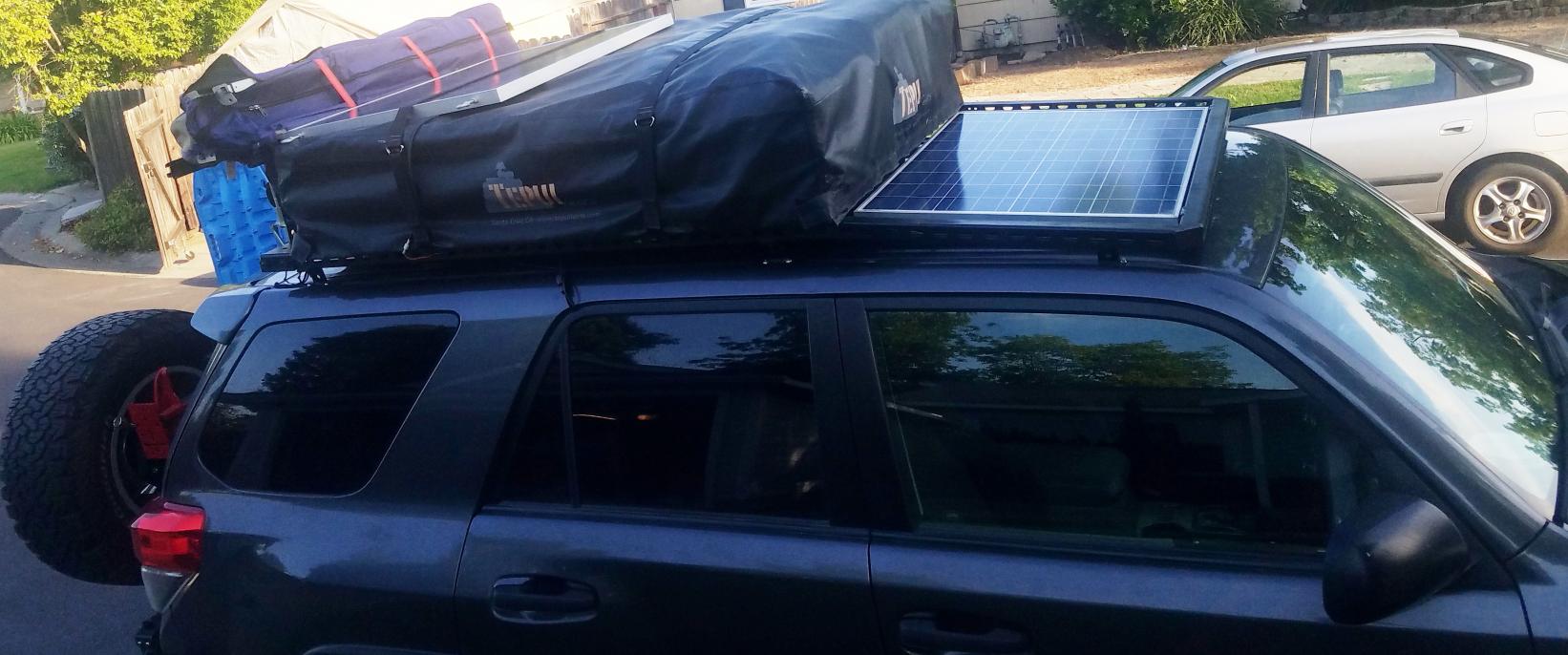

Heres a pic of the rack my girl and I built for her 5th gen. Its mostly unistrut welded together with some mounts and front rivnuts for support for the solar panel. The rear mounts use the factory hard points. The nice thing about uni strut is that there are a billion already manufactured, heavy duty, rust proof attachments for it that cost nothing and are vastly stronger than any commercially available roof rack you can buy.

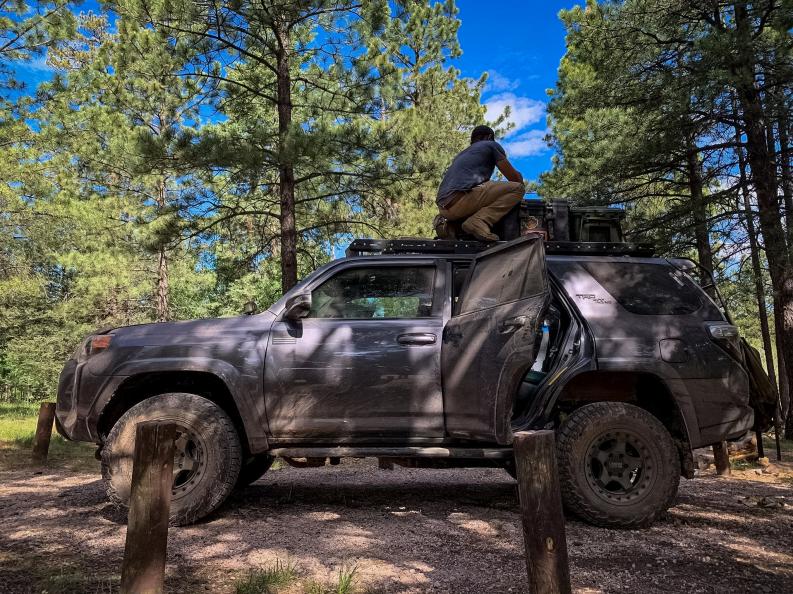

Sorry for taking so long for this, but I finally found a picture that demonstrates the bend somewhat well. This picture is from about a week after I put my rack on and maybe 24 hours after my buddy put his on his 5th gen. The only thing I had on my rack up to this point was the box with my friends rack in it. Having now had my RTT riding up top for 2-3 weeks I'm getting a Front Runner. My tent is pretty much only sitting on the crossbars at each end of the tent and there is a gap from the rack sag on all the other crossbars. This gives me a super awesome rattle when I go over bumps and the bars flex enough that it bounces off the other 5 crossbars under the tent.

Thanks for the info. I am adding an extra bracket to the middle of the side rails on the rack I'm building in case I get that same flex.
