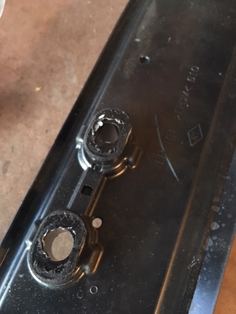

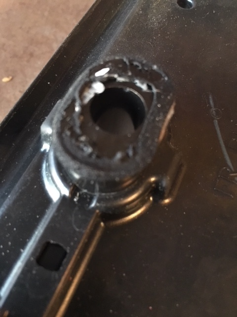

I pulled my rails off to have them powder coated. As I was about to put them back on I noticed the rubber/foam pads on the rails were worn/incomplete (see pics below). I'm wondering if I should:

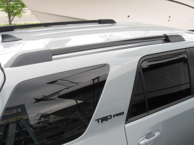

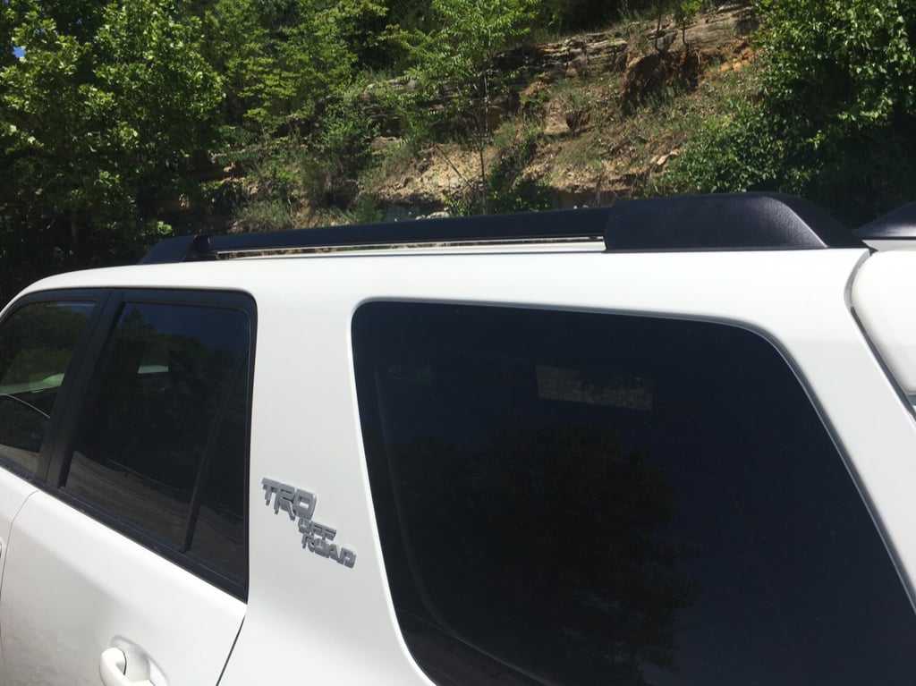

Lot of glare in the pic....cost 50-bucks to have both rails powder coated. I went with a semi gloss to match the factory trim.

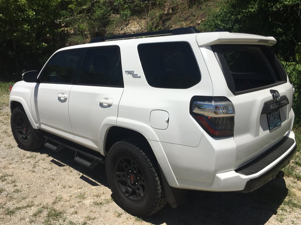

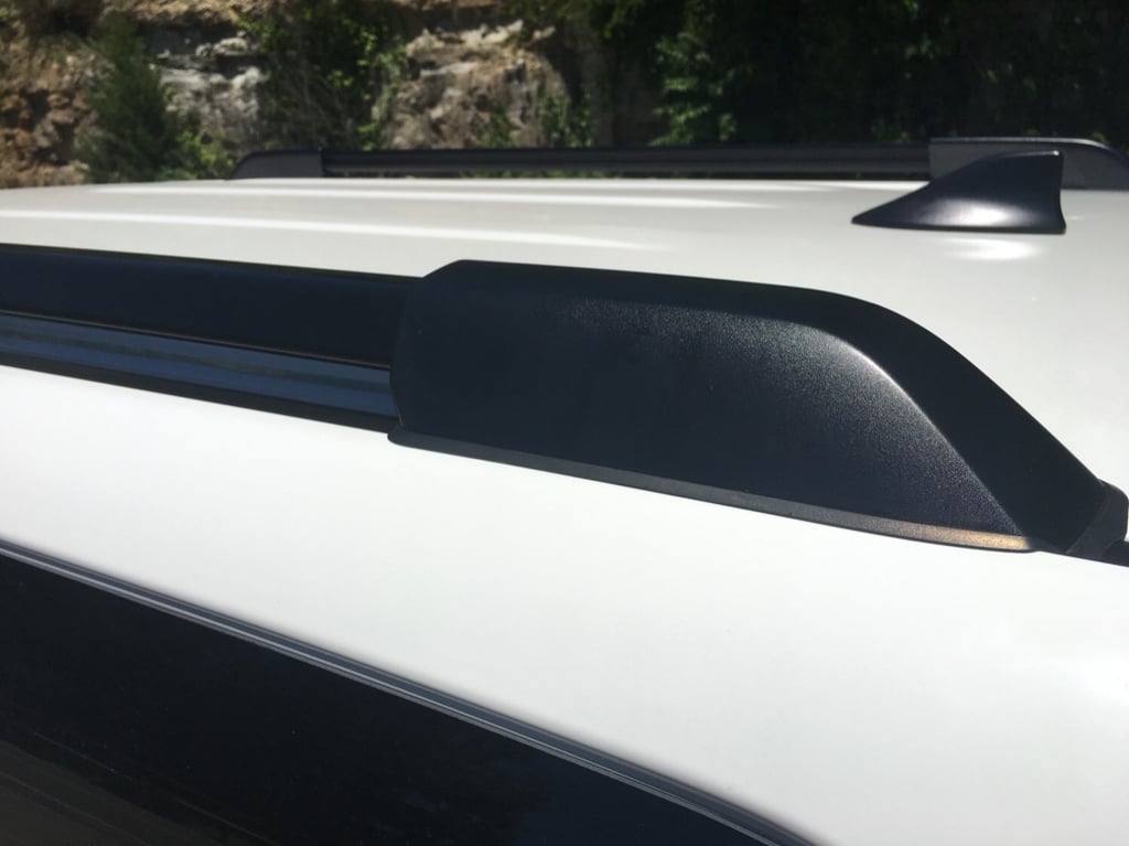

I went with the RTV Silicone. Thank you to all for the advice. If I have any issues, I’ll post them here.
Below are som pics of the powder coated rails installed.
