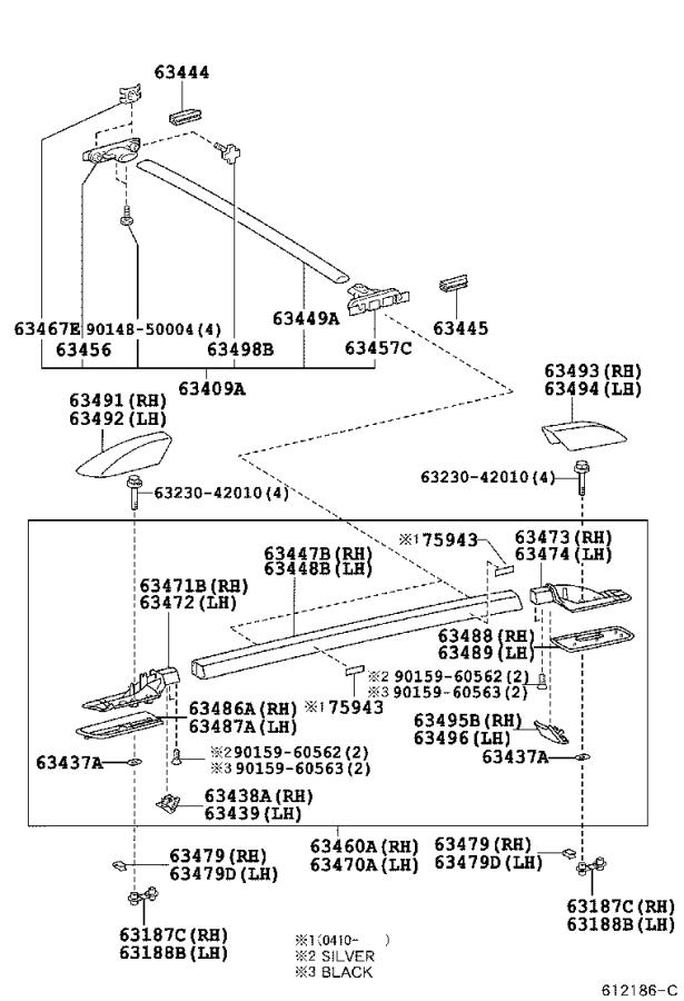

Didn't see any of that on mine, just the parts listed here. 63437A is the part number that needed to be replaced. And they definitely damaged the paint. I found them for $0.50 + $15 shipping, or $5 a piece at the local dealer...
Instead, I scored some neoprene washers and Permatex Ultra Black from Home Depot and went to town. Once it's done curing tomorrow afternoon I'll give it a test, but I'm pretty confident.
