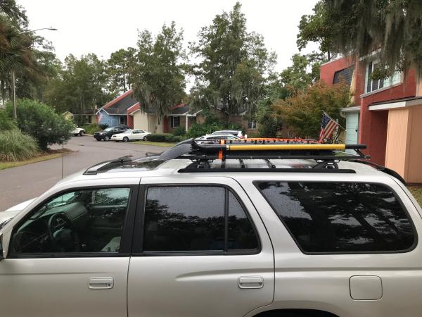

iron-duke-albums-iron-duke-s-99-4runner-picture59525-3-4-length-roof-rack-50-buck.jpeg
$50 on amazon prime. It works great for me and comes essentially to the sun roof but you can't see it, which is a big plus for me. Almost no wind noise and because its not a full basket, it looks more streamline and flatter.
