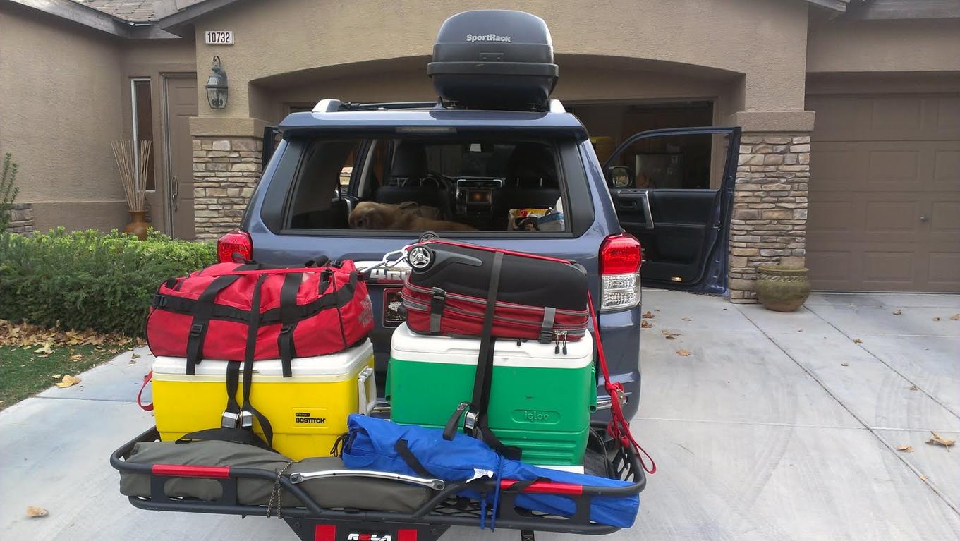

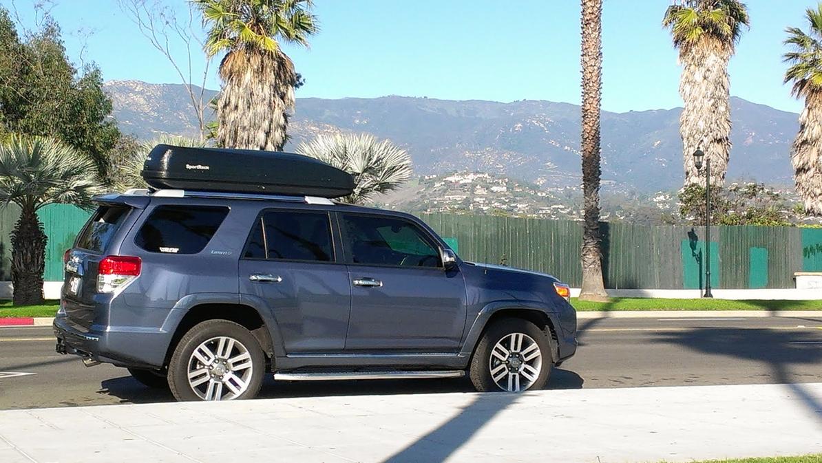

How about these two???

Bay33saw: Thanks for the pics. That first one is making me think you could fit two side-by-side, as long as there's only light stuff up there. We don't have a big dog so we can put coolers in the back.

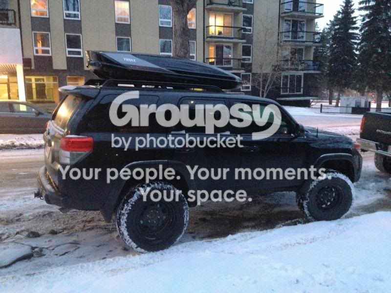

A question for those of you who use a cargo box. Have you ever had a problem with the box blocking your Sat radio reception? I have an opportunity to pick up a lightly used Yakima box, but I'm concerned about blocking the antenna. On an extended trip last summer I used a soft sided bag and opened the roof rack cross bars all the way forward and backward to make room. During the trip I had terrible satellite radio reception. Turns out the rear cross bar was covering the antenna.
I have excellent sat radio reception - rarely a drop of signal. I haven't been on a lengthy road trip with this setup yet though so I'm not sure if it would have more of an impact in the mountains or otherwise "sheltered" areas...
This is the best picture I have from the back - you can see the box pretty much covers the antenna...no problems for me.

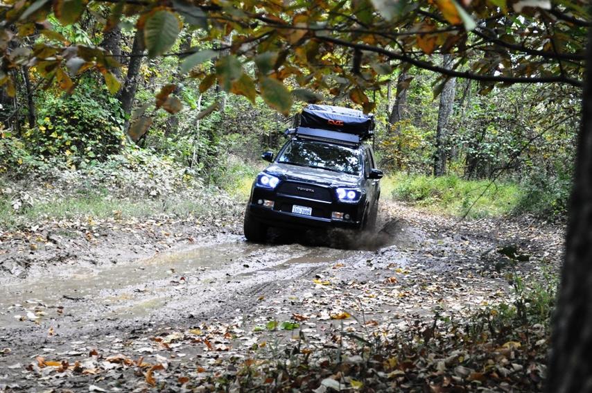

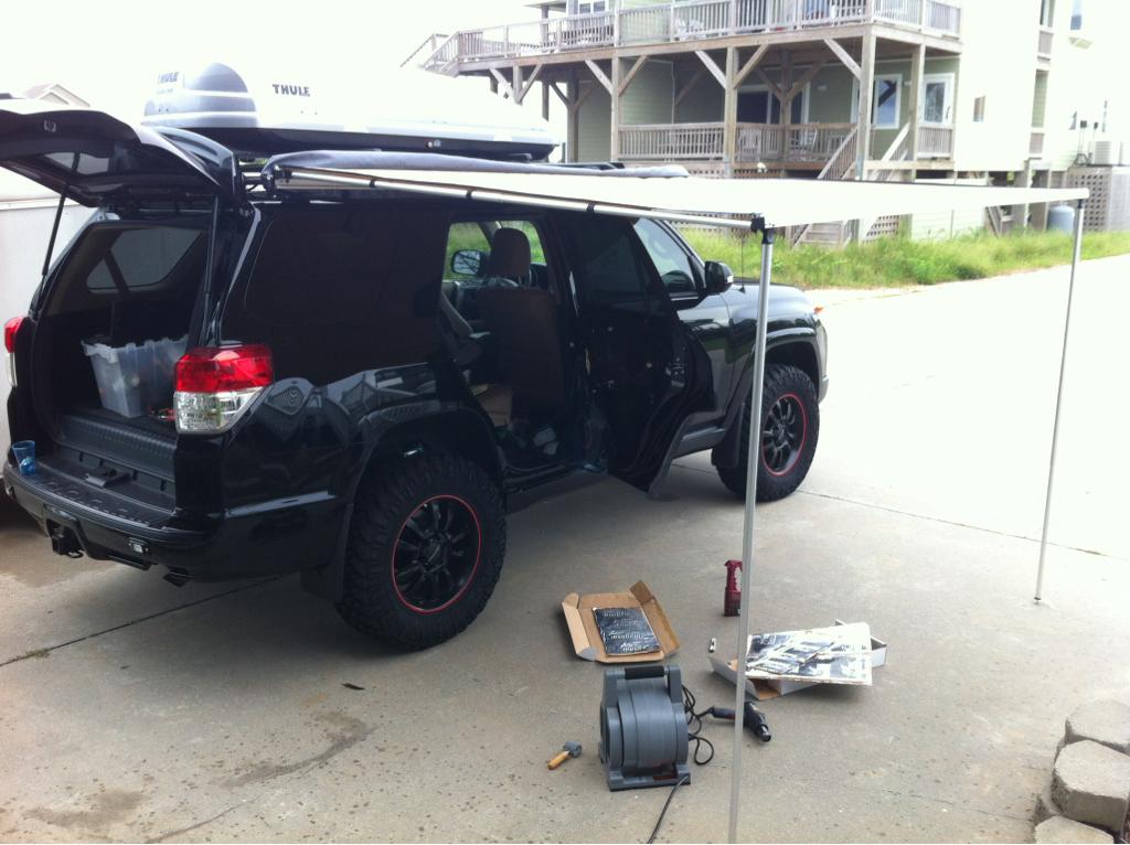

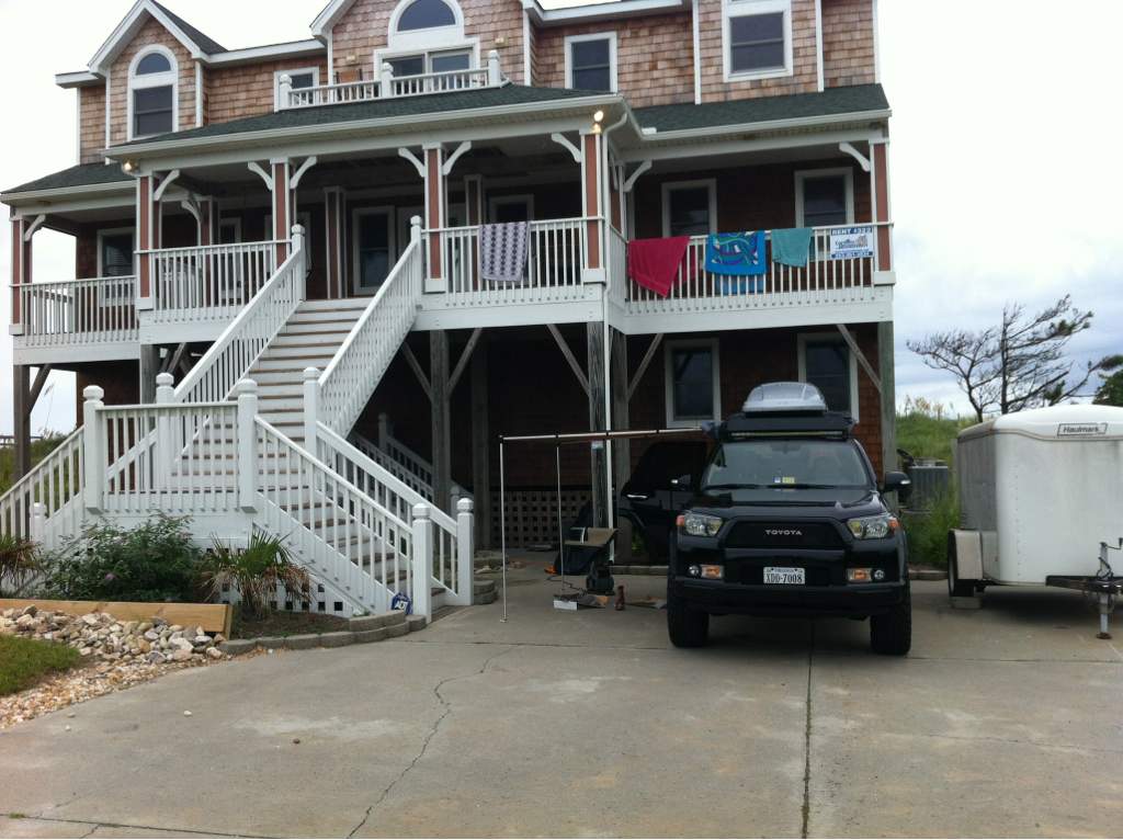

Do both!

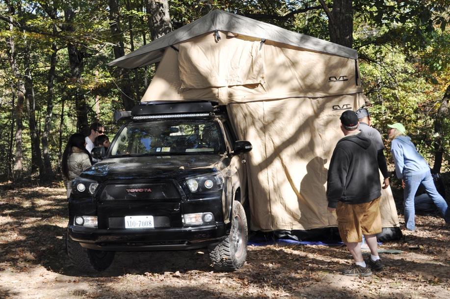

Then when the cargo box isn't on, you can have capcity for this...
And then sleep in style
In all seriousness, the cargo box will be the most versatile. You can just throw things in it without the worry of tie downs, cargo flying off, security, etc. But, as another member stated, you'll be limited to the weight limits of the factory cross bars.
