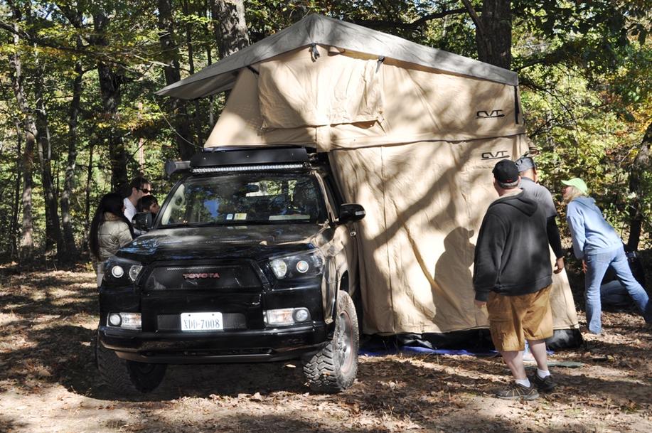

Do both!
Then when the cargo box isn't on, you can have capcity for this...
And then sleep in style

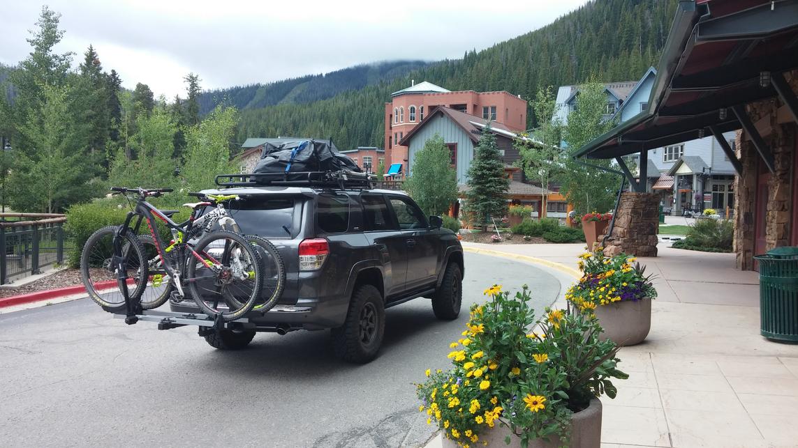

Roof rack comes in very handy on trips... You need a waterproof bag (or a box) if you want to carry non weatherproof stuff like soft luggage. I can carry an amazing amount of luggage up there. The downside to loading a bunch up top is that it can impact MPG at speed... It's actually easy to load/unload standing on the rear tire if you have someone else helping get it off the ground.
If you are actually going offroad - a hitch carrier... needs to be removed (as you will drag all over the place).
Here is a pic from a few years ago. I had 3 bikes inside, 2 on the rear hitch + a ton of gear. But there were only 2 of us in the vehicle.
It took an entire garage bay to hold all the stuff that was in the truck.

Snowbasin, UT?

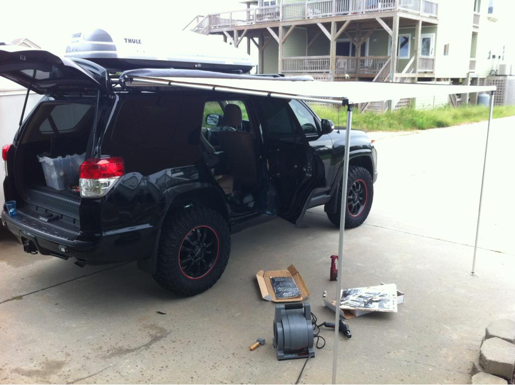

Do you have any info on the awning and how you mount it?
