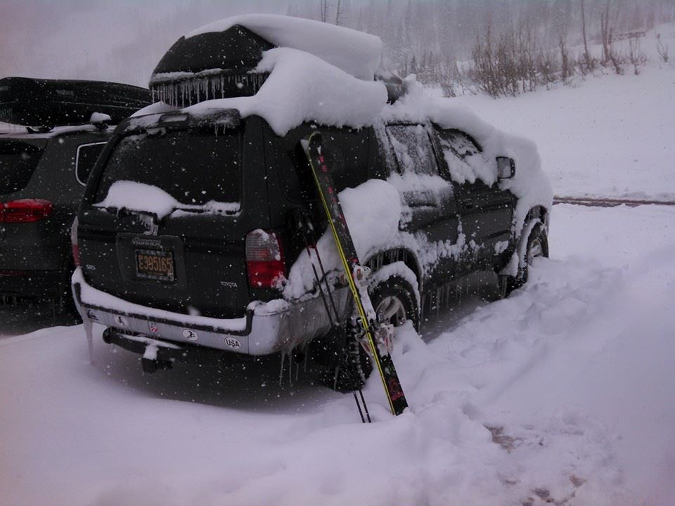

I added an extra crossbar several years ago, that spreads the weight out to 6 points, rather than 4. I used to load a lot of plywood and other lumber, but now just have a loaded cargo carrier on top. I reinforced the cargo box with angle metal from front to rear because that's how I roll. I have never had any problems.
