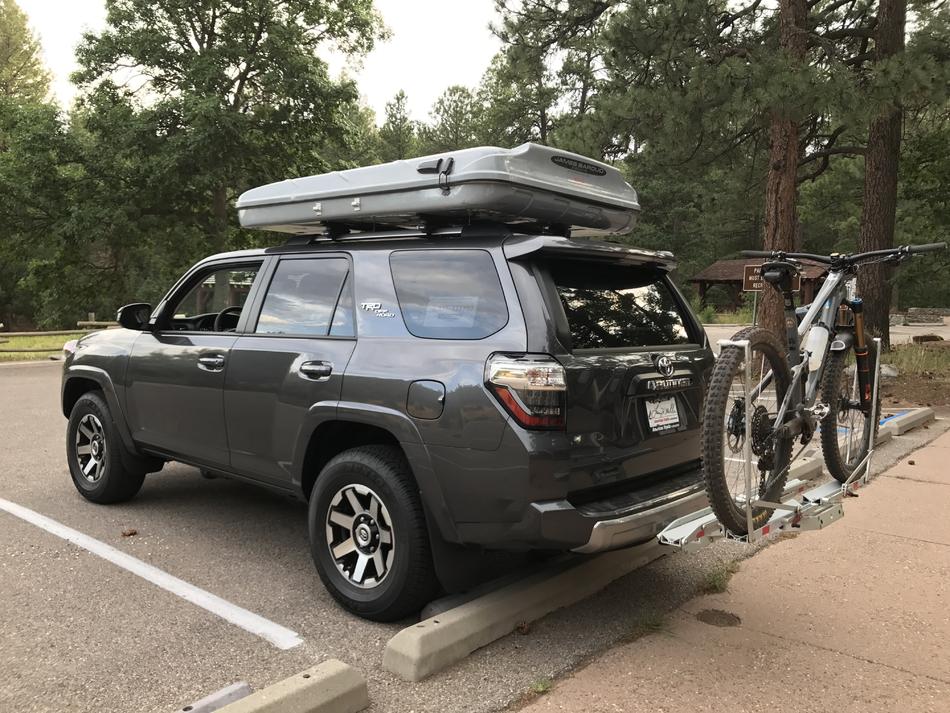

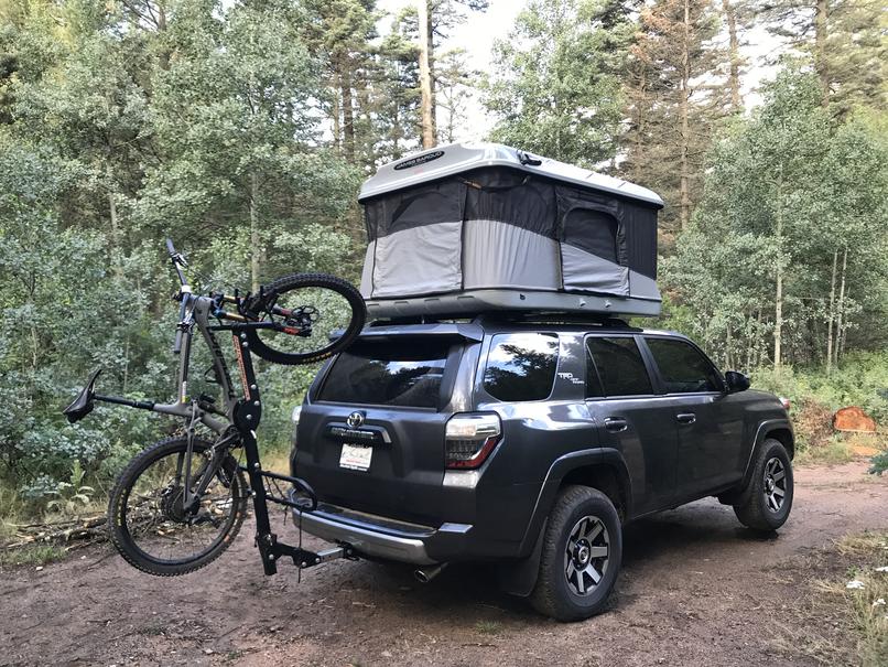

I've had my tent set up on my truck for 5k miles. Plenty of road trips and camping during that time. So far no issues and I'm not expecting any.
I have a hard shell RTT, so I started with a Yakima kit but wasn't super impressed with it. The whole set up was expensive and I didn't have much faith in the plastic straps holding the feet to the parallel bars. (first pic)
So I ordered the following parts from Frontrunner:
https://www.frontrunneroutfitters.com/en/us/front-runner-grab-on-foot-set.html
https://www.frontrunneroutfitters.c...ad-bar-components/1345mm-slat-add-on-kit.html
(second pic)
Very low profile so it was difficult to get all of the hardware installed but no issues since installation.

Do you have any closer pics of this setup. I like it!:hungry:
How many cross bars did you go with?
Also, how do you like that JB hard shell tent? Any issues with it?

That is the exact set up I've been looking for my rtt. Thanks! Nice Scout by the way

Great setup! This is exactly the route I am looking to go in... How hard is it to remove the tent with the FrontRunner setup? Looking to get an Autohome Columbus but I will need to put it on and off everytime I use it. Any input would be appreciated. Thanks!!

Sorry, no close up pictures yet. I could try to snap some after work for you though. I used two crossbars.
Really digging the JB, recently spent a week in Moab and it was so easy to set up and take down. Definitely do not miss the ground tent life.
Thanks Bud! Loved the Scout, but I'm on an Evil Calling now. Pretty similar but way more comfortable at uncomfortable speeds.
As it is now I do not remove the tent. I don't have anywhere to store the tent and since the set up is so low profile removing it would be a chore. The hardware that came with the tent had to be cut down to avoid hitting the roof and also so that I wasn't spending 15 minutes threading every nylock nut. The clearance between the roof and the tent is very small and getting my hand in between to tighten things up was not fun. Lots of contorting. I would much rather not have the tent on the roof for DD activities but removing it is not much of an option right now.
That said, when I do have a spot to store the tent I will only have it installed as needed. At that time I plan to pick up something like this:
https://www.frontrunneroutfitters.c...es/quick-release-roof-top-tent-mount-kit.html

How do you actually like the RTT vs standard tent camping? I've been doing more and more car camping so RTTs have been entering my mind?

It definitely has its pros and cons. At first, I was definitely all about it. Now? ... I don't know. I do know my wife loves and it gets her out more so that's nice. If it were just me, I'd honestly just rather have a small ground tent and maybe just an awning to pull over it. So long as my wife and son continue to enjoy camping, I'll keep using it though.
