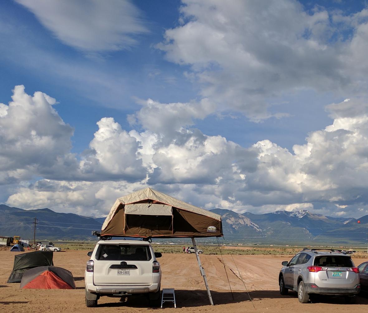

Roof top tent (RTT) on factory rails. It's doable
I have been using the stock rack with four Thule Aerobars for the last year with no issues.
