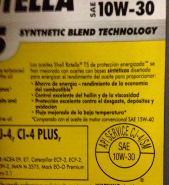

Right from API. I figured enough is enough.

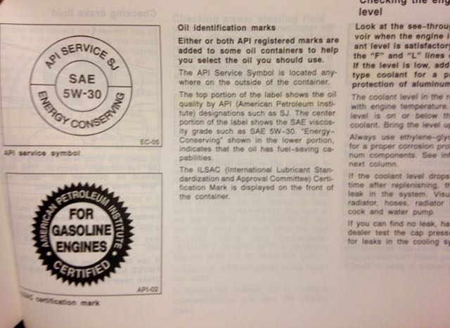

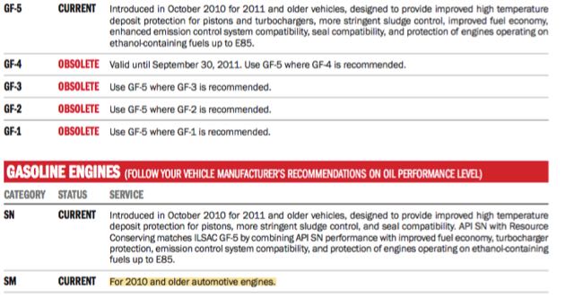

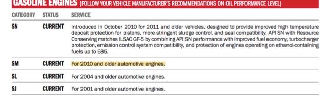

This is directly from the owners manual on Oil requirements. Then here is the API rating showing that tech does advance as the years pass. Keep in mind that Rotella T5 is a CJ-4/"SM" oil.
Conclusion: Toyota "requirements" at the time (1999-2000 for my specific 3rd gen) required that 5w-30 API rated SJ oil be used. By using an SM rated oil you are using a more current standard.

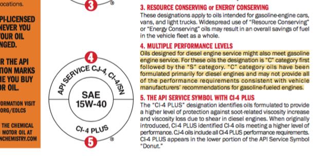

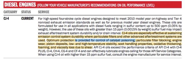

Yup, I'm not sure why this is so hard. If it has the gas engine cert., its good to go. If it is only the diesel cert., then its not. I'm not hating on Rotella, just trying to squash the old wives tale that diesel oil is somehow better for your gas engine.
