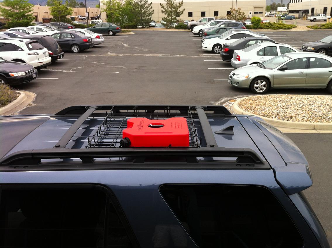

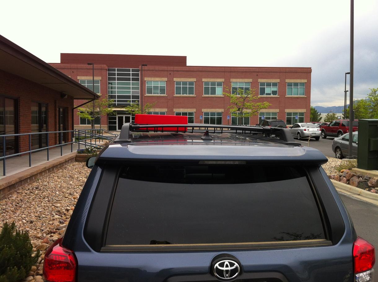

Just opened a 3-gallon gas Rotopax, lock, and back plate. :biggrin2: I'm going to mount it on a Yakima Basketcase, which I "rigged" between the factory rails on my TE. I'll have pics ASAP.
As promised...
It worked so well, I'm ordering another one...

FatDave- thats awesome! Can I pay you to do that to my LTD?! lolol.
Seriously, it looks like Toyota designed it to go there. Well done!

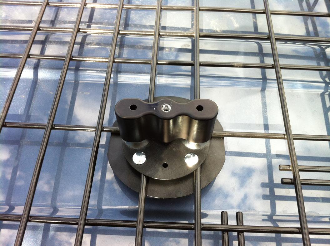

Easy peasy. The Rotopax base has 4 carraige bolts that extend downward. They sell an optional backer plate that has 4 holes which line up with the standard base. I just put the base on top of, and the backer underneath, the Basketcase. Had to get longer bolts, though. Depending on where you mount it, you might need 1/4" spacers/washers between the plates.
Perfect, thanks!

The TE side rails are not parallel. They're wider at the front of the vehicle. They're about 39" apart in the rear, and 40"+ at the front. My install, which is sort of centered, left an 1/8" on either side in the rear, and 1/4" on either side in the front, which I filled with 3/8" ID 1" OD zinc coated flat washers.
The basket comes with most of the hardware you need. The includes square ID/OD washers that are supposed to be used to clamp the basket rails, but I used them to go in the side rail channels to hold carraige bolts. The bolts that come with the kit are a little long, so I got shorter ones.
At the other end of the bolts, you can use regular washers and the plastic wing nuts to secure it. That said, I ordered an additional fastener kit from Yakima so I could use the square washers as intended.
Another work around to buying the extra fastener kit is would be to dremmel the plastic crossrail clamps apart. They're box shaped, have carraige bolt holes through them, and they (probably) fit in the channels.
Finally, the basket can be raised or lowered about an inch due to the slotted affect of the basket's wire mounting supports. In the lowest position, it's at or beneath the factory crossrails.
