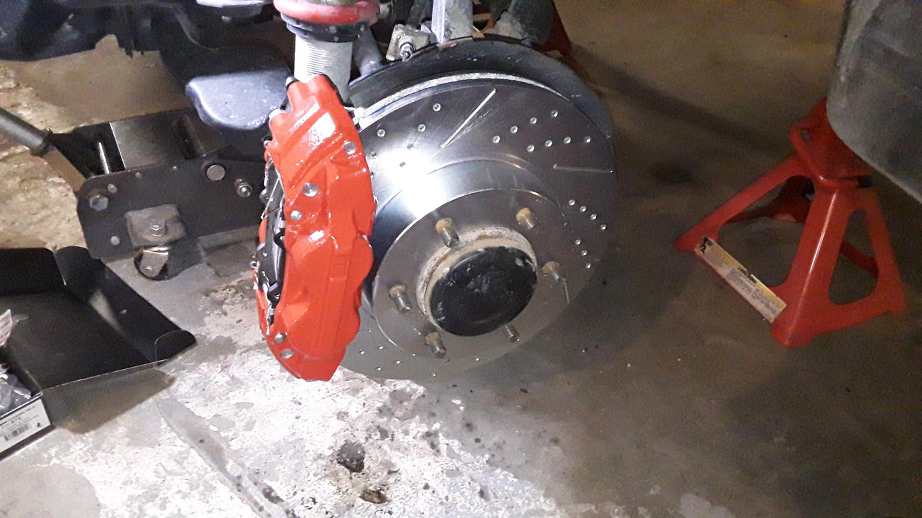

There's two kits on Amazon that a few have picked up. One is Powerstop, the other is this one (that I just picked up):
https://www.amazon.com/gp/product/B00EOBMFAY/ref=oh_aui_detailpage_o01_s00?ie=UTF8&psc=1
These are remanufactured calipers (that's stamped with the 13WL) and people have had good results with them. Some suggest to change the pads to a better quality though due to dust.

I hear a lot of good things about Powerstop. I went the other way because they were about $50 cheaper and it got under my skin that Powerstop couldn't even post the correct picture of the calipers they were selling.
I'm kind of stupid that way. Hope it doesn't bite me in the butt! :moon:
