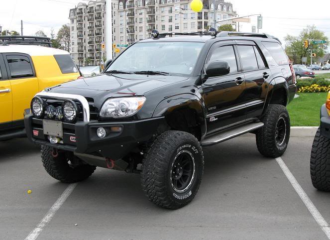

I have a few friends that go to AU tell me they seen your 4runner out and about. They are trying to get me to come down there lol. I have 5" suspension bilstein 5100 adjustable set on 2.5" lift. 2.5" leveling spacer. = 5" up front. 2" lift springs in rear w/ 1.5" rear spacer. Icon rear shocks 3.5" rear lift. 1" toytec BL. Running 315/75/16 Mickey Thompson MTZ's. Great ride. Sits level. Would do it again but next time personally I would use coilovers along with the spacer up top. They say its not good to stack lifts. but I have had mine lifted for a good 15k miles no problems what so ever. Several trips to PCB. Ttown. ATL. If you want anymore info just give me a holler.
