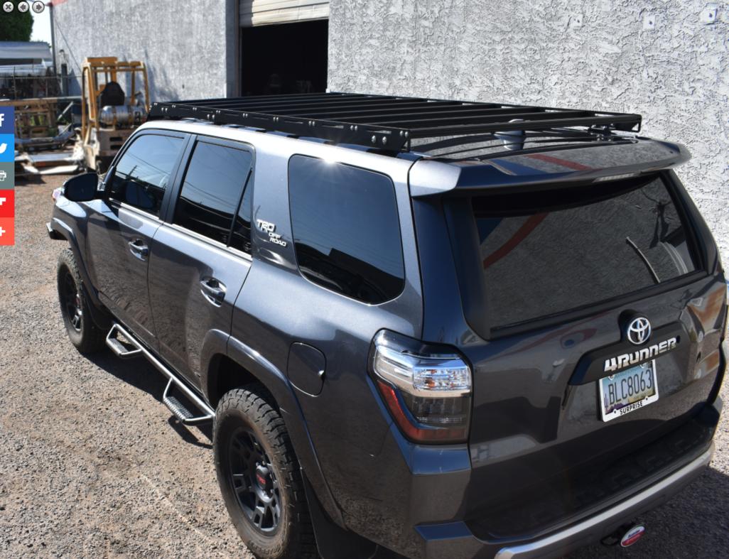

Anybody have any experience with these guys? Seems very fair priced for a full rack.

My girlfriends son, and his off road group use RPM a lot, he is having a roof rack done now, he speaks very highly of them
Anyone have this rack and do the rubber feet or rubber screw mod like some guys are doing with the full prisnu racks for the front instead of drilling?

Rpmfab rr
Please advise when you have it and installed. I like the tubilar instead of the round style of Gobi and $1600 price.
If you have to drill, where and why didn’t they build it to go where stock holes are? I have a 2014 Premium Trail
Just finished installing it today. Install was very straight forward, and the only issues I had were;
1. Instructions were not included. Not really an issue since I'm local, but required a couple of phone calls to get the pdf emailed to me.
2. The Delrin spacers that the feet mount on had their holes drilled to narrowly. Again, I'm local, but required a visit to get new spacers. If I hadn't been local, would have had to ream the holes out. Not a huge issue, but a quality control issue nonetheless. Tech said the "jig" must have been off.
3. Was missing two bolts for mounting the front feet to the Delrin blocks. This is for the no drill option, which I opted for. When I went to get the new blocks, I asked for the bolts and was told they were out. They offered to run to the store, but I just decided to go to ACE on the way home. Again, QC......
4. I had to break out my tap and die set to tap the 1/4-20 threaded holes at the ends of the cross bars. The button head screws that mount the cross bars to the side bars just seemed too damn tight for my liking. With the cross bars being aluminum, I didn't want to strip the threads. All went in fine, no stripping. Not sure why this was, and frankly I didn't ask.
Now, overall, I'm very pleased with the fit and finish. Roof fits well, and looks great. I like the no-drill option, and think it will be just fine for my needs. Just didn't like the idea of drilling into the roof.
The shop is predominantly a Jeep centric fab shop, but do carry plenty of 4Runner parts. If they ever get around to making a lo-pro style front bumper, I'll probably go with them, being local...
To answer your question about drilling, understand that the full length rack does mount to the four locations that the factory rack mounts, but a full length rack requires another set of feet up front (a fifth and sixth "foot") to support the added length.

Good stuff.
Would you mind posting some details pics of the rack, including the sides, fairing, and closeups of the feet that mount to factory locations and no-drill feet?
