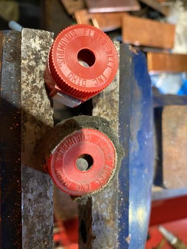

Replaced piezo this morning. So far so good except for my horrible rush job on soldering. Will fix tomorrow morning when I have more time. Was wondering what the foam was for until I heard how loud the new one was without foam lol. Might leave it loud, we will see. Thanks again for the advice and for giving the location of piezo.
I received my new beeper.
Identical to original. Plus, it actually works. Easy peezy.

Not sure, just an idea I had, but now I know my piezo works and doesn't need replacing.
