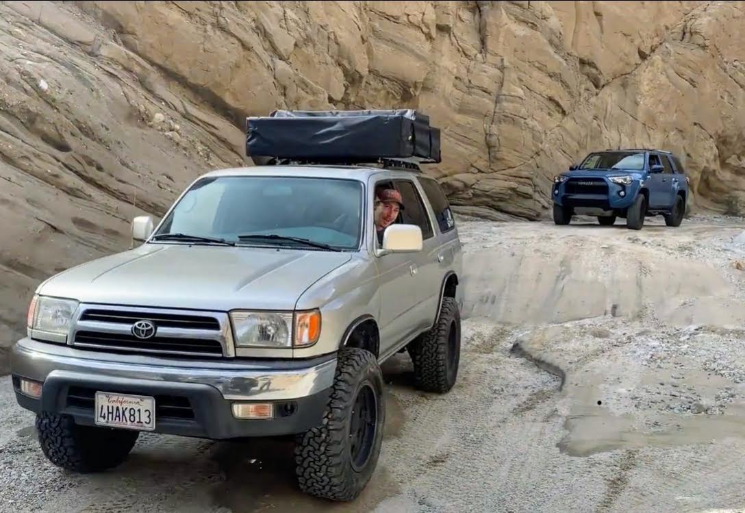

I use a simple Yakima setup with towers, landing pad 1’s, and round bars. Not the most aerodynamically solution out there, the rtt sits about 6 inches off the roof when it’s all said and done. But with the fairing it’s fine. Literally can’t tell it’s up there cruising 79 down the highway - no road noise. I’m not concerned about weight.
And when I’m not running the rtt, I can remove it from the crossbars, and then unclip the sky towers from the landing pads and remove the bars for extra mpg’s.
Works for me, and it’s cheap. You can find any used Yakima/Thule setup on CL for dirt - just gotta eat the right landing pads that mount to the factory rails and you’re set. I e had my yak rack for about 10 years over 4 vehicles. It’s more than paid for itself in the $200 I paid for it used.

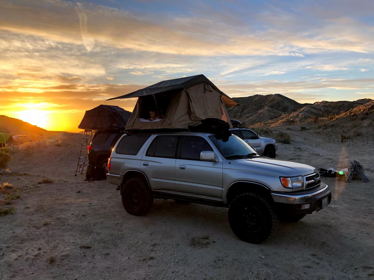

extra set of stock bars
I have a smittybuilt overlander (standard size) mounted to the stock bars. I got an extra set so I have 4 bars that the tent mounts to. I have heard that the stock bars can fail at the plastic end pieces, however with 4 rails if one fails I have three more attached.
The smittybilt tent comes with 1 set of hardware that will allow you to mount to 2 rails. You can purchase another set for 35 bucks online. The kit comes with bolts that are waaayyy longer than needed and nylon nuts which are a ***** to screw in. I mean attaching that thing is awkward enough. Also the nylon bolts are technically one time use.
This was what I did.
Extra set of cross bars 50 bucks used
Pulled out all the screws that hold the rails to the roof. Re-tighten and blue thread lock them.
Extra set of Hardware from smittybilt 35 bucks online.
new set of stainless bolts, lock washers and standard nuts from hardware store. 30 bucks
My wife and I can get the tent on and mounted in 20 min to all 4 bars (8 mounting locations) with standard wrenches.
The XL is larger than the one I have so not sure if the mounting rails on it are set out wider than the standard size. I assume they are...? the mounting rails are held onto the tent base by two bolts each. Yes just two bolts. I guess you could re position them but drilling out a new mounting hole in the tent base further in. That is just a guess.
