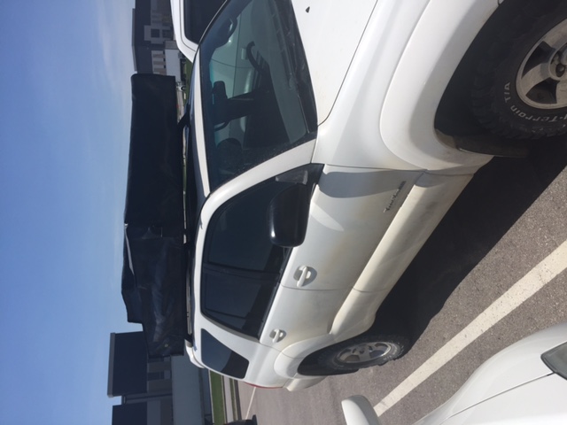

I currently have a smittybilt XL attached to my STOCK CROSSBARS
I've had it on the past two days and has help up fine. I have driven about 30 miles going 75 mph and 30 miles going 65 MPH. I also have had 3 adults inside the tent. So far it has held up just fine, great even.

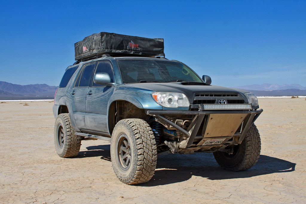

ive gone through the middle of the mojave and pismo with my Kukenam on the stock rails. It holds it just fine. Its for in movement weight limit not with parked.

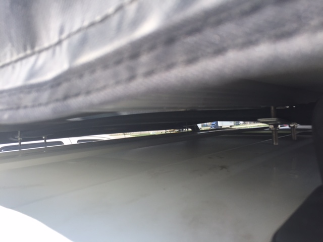

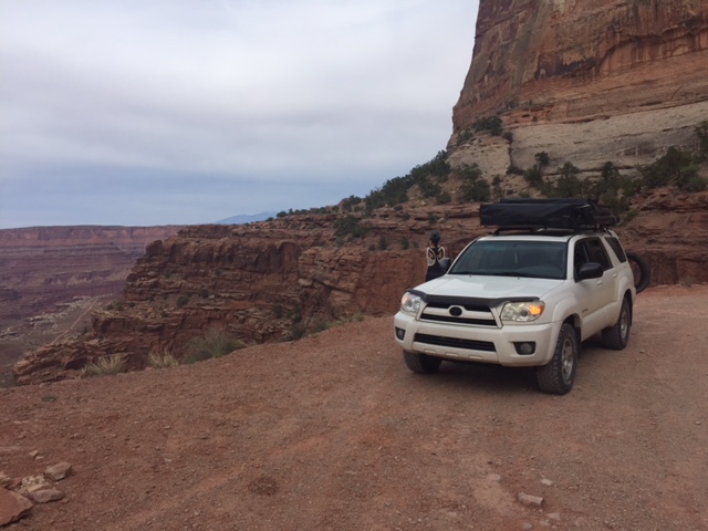

This is how it is now and has help up with no issues for 60 miles of 65-75 mph

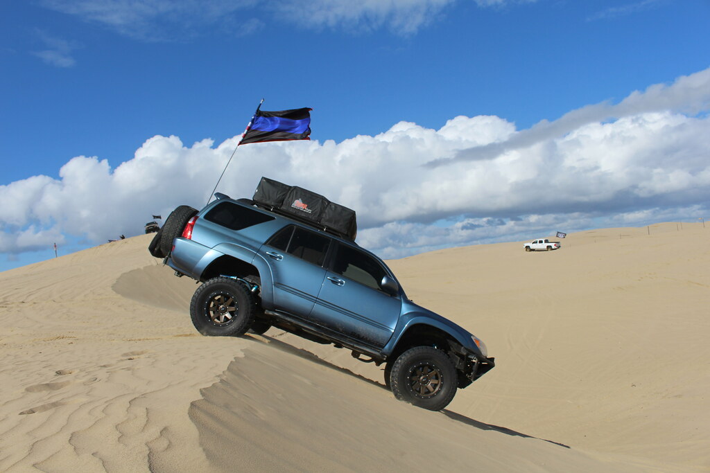

I had my RTT Tepui Autana Ruggedized (so not the lightness one) on the factory rails, family of 3 (2 adults and a 4 year old) with absolutely no problems for approx 6 trips and over 5000 miles. (left it on for daily driving in between trips)
I have since upgraded but the point reminds you totally can do it, just don't use the cross bars, they snap under light load. Their (Crossbars) "structure" is based off their "flexing". If you notice as they just sit on our trucks there's always a nature bow to them. and it's when they flatten when they gain their strength. That time of structure is not ideal for RRT as the weight is distrued differently.
