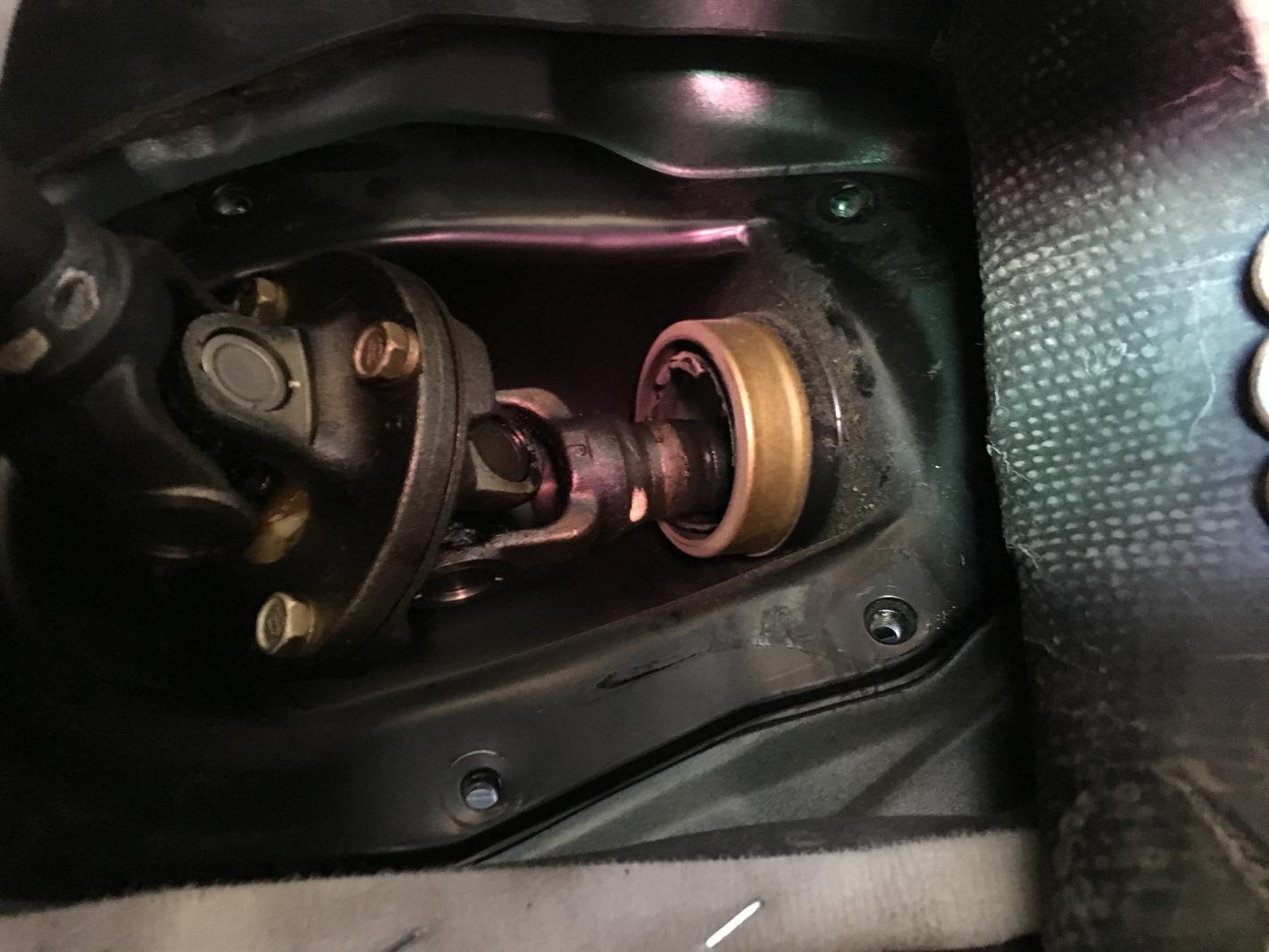

I think I found the culprit. See attached pic. The bottom part of the steering column seems to sit off-center in the "hole", and is scraping on the outside. Any thoughts?
