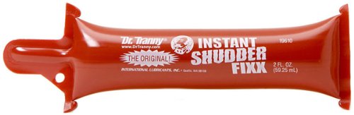

Rumble strip fix
Try this stuff. I tried one tube, the shutter went away for a maybe a week**, then came back. Bought another tube put it in. Haven't had a problem since. Hopefully this stuff works for you guys. Got almost 150,000 on my 05 4runner limited 4wd sitting on 36s. I think it started about 110,000 miles with the rumble strip.. bought this stuff at O'Reilly's. Instant shutter fix by dr.tranny........:thumb3::guitar3::ak472::bash::
Try this stuff. I tried one tube, the shutter went away for a couple days, then came back. Bought another tube put it in. Haven't had a problem since. Hopefully this stuff works for you guys. Got almost 150,000 on my 05 4runner limited 4wd sitting on 36s. I think it started about 110,000 miles with the rumble strip.. bought this stuff at O'Reilly's. Instant shutter fix by dr.tranny........:thumb3::guitar3::ak472::bash::
I've read good reviews about this product. Waiting for someone on her that's used it to comment on this.

I remember when I took it to toyota. It used to do the rumble strip 40-45 mph, and slow acceleration. Fast acceleration it shifted fine. They said it was the torque converter, they recommended me to do 3 tranny flushes, or to replace both the tranny and torque converter, and they said it's most common in the Tundras. I didn't want to do 3 tranny flushes, or too replace it, thats just too much $$$. A friend recommended this product to me. He worked at O'Reilly's for years..He told me it most common on the Fords..

Stop the rumble

Product added with no change yet approx 5 miles (at time of edit)

I had the rumble strip issues with my wifes 08 Honda CRV at about 110K. It happened at about 30-40 mph upon acceleration, especially on uphill grade. Thank goodness she told me right away and did not drive for that long with the issue. I immediately brought it in for a tranny fluid drain and fill. I added 2 tubes of the Dr Tranny Shudder Fixx, based on all the information I could obtain on this issue from the internet. The rumble strip went away. I now do a change at every 20K just to keep fluid fresh and have not added any more tubes. It now has 170K and all is good.

I. tell ya. It's worked fine for me, so far. No issues since I added the shudder fix. I would replace what fluid I can and not flush. I that doesn't resolve the issue, then I would flush.

Added the shudder stopper approx 300 miles ago didn't help.
