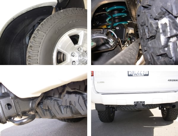

Pictures of 285/70 17 Spare
It's hard to convey how it fits, but here is what I could do.
wow so you actually fit a 285 in the spair tire location!!!! I wonder if you are the first person to do this?

Chalk it up to ignorance and naivete . . .
Actually, a friend helped me test it with his 33" tire before I took the plunge.
