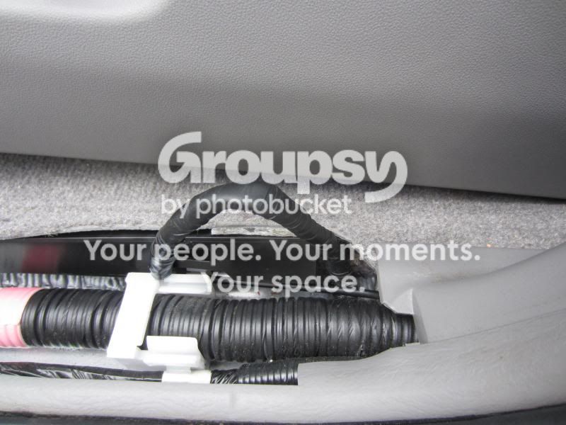

i know with limited's the wires come out of the wiring harness at the front doors and go under the seats. im not sure if the wires are there or not but they would be as shown
IMG_1102_zpsaf549f30.jpg~original
Power source
