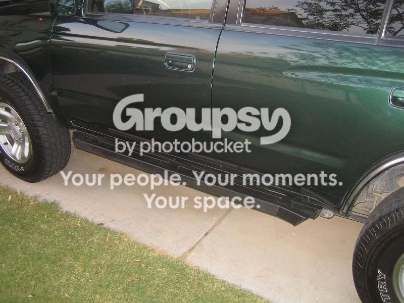

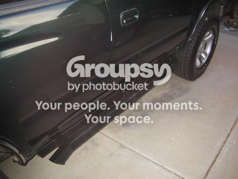

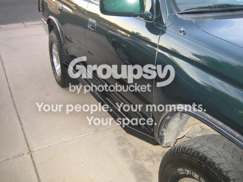

I had sliders custom built, but most go with stubs sliders. It depends on if you want to use them as sliders, or if you want them for the look. If you are just after the look, grab a pair of black nerf bars and your set. If you want to drop the entire weight of your 4Runner on them...spend enough to get good ones. I have attached a photo of mine, I know someone else on the board was building a set that matched mine, I gave them the dimensions but I don't know if they ever did it. Mine ended up costing me about $150 in raw material.
