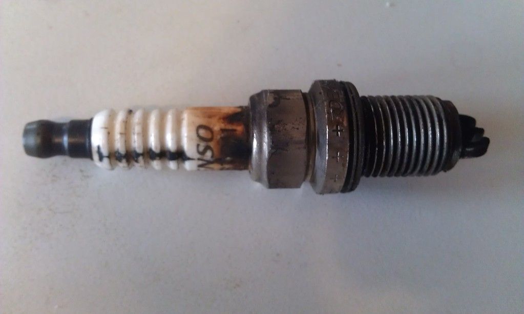

It is so rare it happened twice for me. :juggle:
Look at the where it was sparking between the insulator and the base.
IMAG0037.jpg~original

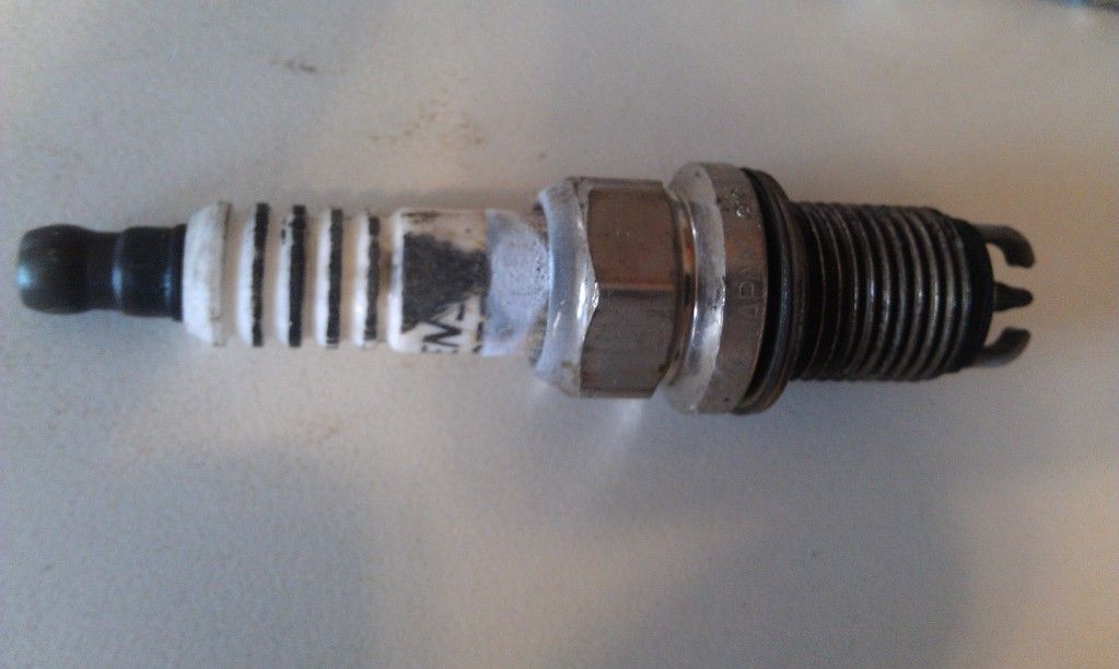

Different plug
Cracked insulator almost the whole length of the plug.

Both times, this indicated a cylinder misfire on the check engine light and caused a vibration and loss of power.
