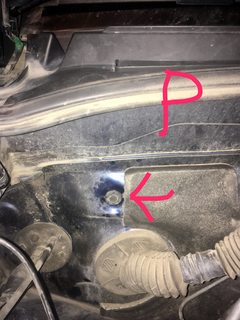

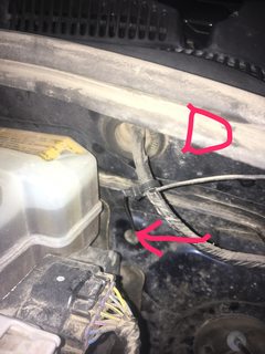

Reviving an oldish thread, but I'm getting ready to run 1/8 coax through firewall. However, everywhere I look and read about going through the grommet that the electrical loom runs through. Is there any reason I shouldn't run through either of the 2 holes pictured below. My sat antenna runs through this opening on drivers side and in image 2 it shows the hole on passenger side, but it is plugged. This plug is easily removable. It seems to me this would be a much simpler option...unless there is a reason not too.
Thoughts?
Thoughts?
I have used both of those locations in your photos. I previously ran a wire harness and additional wires through the driver's side hole after opening it up slightly to fit a grommet. On the passenger's side, I just got done running welding wire and a wire harness through that hole after opening it up a fair amount and using a firewall boot. Both locations worked great. I know a lot of people use the large boots on both sides, but I try to avoid factory wiring whenever possible.

Thank you! Yes, I am runnng CB Coax, but the connector is not attached so I am only running 1/8" coax and it looked like it would fit in the smaller hole. I haven't seen anyone use this hole and I was curious if there was a reason why.
Thanks again for confirming my suspicions.
