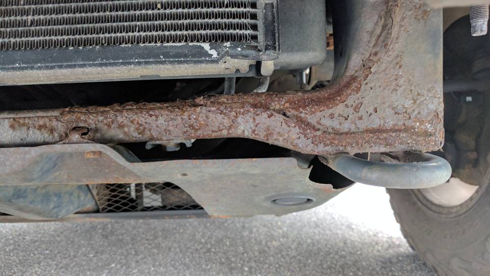

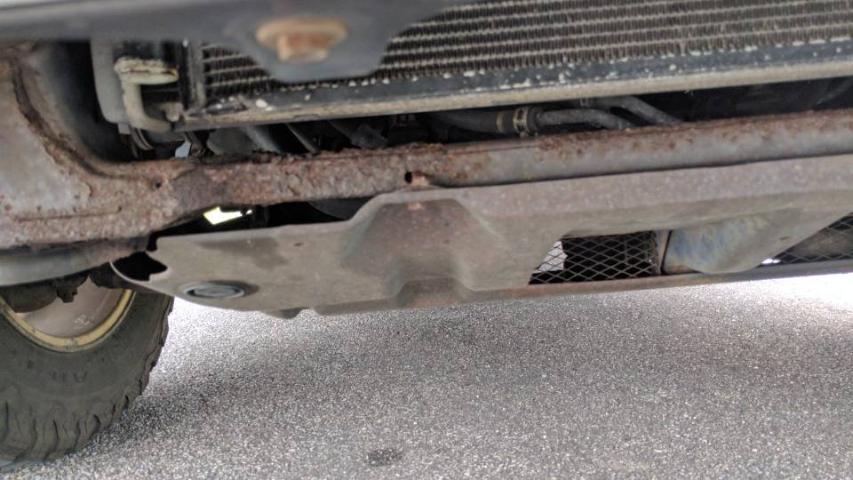

The front bar under the radiator is very rusted and wanted to know of some ideas to stop the rust from getting worse and maybe even make it look nicer if possible. I also want to replace the current skid plate with the RCI skid plate and maybe even get the transmission and transfer case plates as well. Is the installation of these plates truly an easy swap with no new mounting holes needed? I will check the mounting points for transmission and transfer case plates for any damage or rust since it has been exposed for over 10 years.

Clean all the rust with a good stiff wire brush and/or a drill with a wire brush wheel, make sure you wear safety glasses then spray all the areas liberally with Fluid Film.

I would recommend using both the brush and a drill brush, the drill will make the easier to get to places much faster but you will need the brush to get into the tighter areas, they also make a brush for the drill that is pointed and not a wheel to help with the tight areas.
The steel plates will be much stronger, but the aluminum won't rust, if you go with the steel just make sure you coat them on both sides with the Fluid Film or paint them very well using a good rust prohibitive primer first and then several coats of the color of your choice, I would also recommend to use the Fluid Film at least once a year if not more often on everything you can get access to underneath, when it starts looking dried out spray it again!!

I would also suggest wiring it down as much as you can, and then either hitting it with rust converter and/or rust encapsulator THEN use fluid film. I love that stuff. I just intstalled an RCI Steel skid and painted it with chassis paint then hit all the bolt areas and seams with FF.
For the skids, I don't recommend running bare steel and fluid film only. I think painting and maybe applying fluid film is your best bet.
For the present rust, these rust remover wheels work really well at removing rust. I like them better than wire wheels, as far a wheels are concerned.
Also, I would remove the rust...clean the area...paint. Then wait a few weeks and come back to the painted areas to touch up.
In my limited experience of painting my undercarriage, I found that removing all of the rust gives the best final results when painting. Easier said than done.
I have the RCI steel skids, they've held up very well for the 2yrs I've had them. I got them in bare steel and cleaned them up well with acetone, then did a few coats of Rustoleum self etching primer, followed by a few coats of High Performance Enamel. Seems to be doing well, and easy to touch up at the end of the season wherever I've scraped off the paint on a rock, etc.
Those 3M wheels are the best for rust removal. A wire wheel will take of metal as well, those wheels are specially designed NOT to do that. They come in green, red, and brown. Check which 'grit' is best for your needs

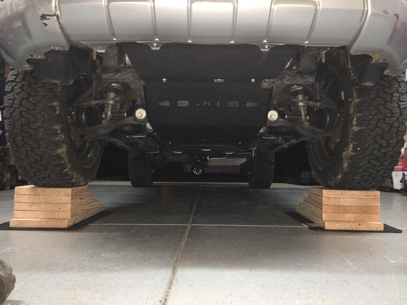

Just installed mine Monday night. Easy enough I suppose, but I did it by myself :redbrick: with some jack stands (and some cursing). I suggest getting a buddy to help lift and hold them in place... would have made it much easier and gone a lot faster. I didnt use thread locker (instructions did not indicate needing to). But I do plan to check all the bolts after a few days to make sure they're still in tight and double check my work.
