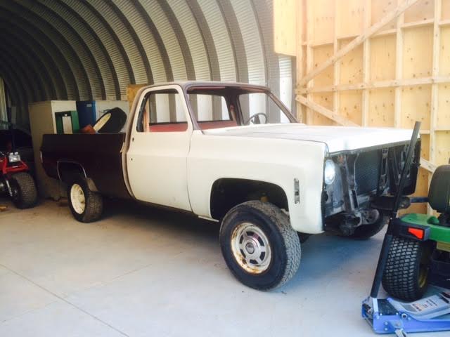

Did a similar windshield repair on a 78 GMC 4x4 - rot in both sides & bottom corners, of windshield frame.
- paint was bubbled & lower frame full of bondo & old brazed tin.
- found a $100 donor panel, came off a Suburban / vehicle wrecked locally, the rust free truck came out of New Mexico
- drilled out lots of factory spot welds, in my home garage / used an air chisel, to seperate panels
- used cowl panel was Mig welded in with a Miller 150amp/220V...to factory new condition & put in Epoxy primer
- probably a 2 day job (with repair panel) fixed right with auto body technician
Expect +2x more expensive ($$), if compound curved sheet metal patches have to be hand fabricated...takes much skill.
I'm also in ON, with very good contacts (South of London) / should Brad (OP) need further help.
