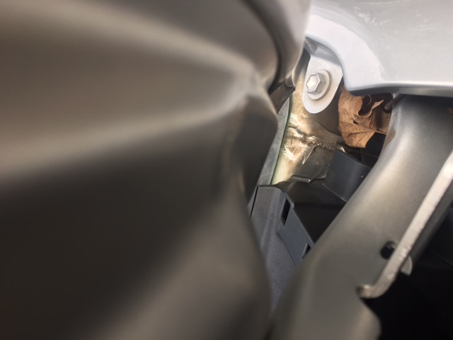

Here is my issue...I have a crack in my 2011 4Runner windshield. I had safelite out last week to replace it. After he got started removing the side trim and working towards the bottom he said that he discovered that the pinchweld had been ripped out by whoever last replaced the windshield (I bought it used a year ago). He told me I would need to have a bodyshop repair it before he could continue. Granted, I'm not the most mechanically inclined person you'll ever meet but has anyone ever heard of this? Looking at it, there doesn't to be any sign that something would have "ripped out". I'm not sure what I'm supposed to be looking at to know if it's messed up. Cost to get it fixed? I'll have someone look at it this week but I would like to get prepared for the sticker shock.

It looks like your showing the body joint near the firewall and fender under the windshield...correct? Some more pictures detailing what is the claimed issue area would help.
Were you present when the windshield guy was there? I'm confused as to what possibly could have been rippped out that would affect a windshield install. The windshield just sits against the base, and is caulked into place. Some places have pretty crazy installation requirements, and others just flippen half ass an install.
I agree with Reelamin, I don't see what could prevent them from putting in a windshield. Look on Youtube for installation videos, Eric the Car Guy has a good one.
Yes, reelamin, that's exactly where it's at. Tough to get a good picture of it. There is a small gap between the glass and where the firewall curves down but I stuck a small screw-driver in there and it definitely appears to be adhered along the entire bottom. The Safelite guy was a younger and maybe he hadn't done a 4-runner before...
I was there when he explained it to me but was a little perturbed and confused by the whole thing...just never had an issue replacing a windshield before. I'll get a second opinion this week and report back. Thanks for your help!
