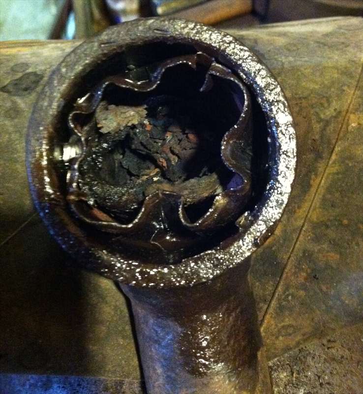

Here is the culprit for the axle seals blowing... If you haven't already, plan to replace your axle breathers. They are inexpensive, and a relocation kit is a great idea if you don't want to replace or check these on a regular basis... If it looks like this part came from a shipwreck, it is because it has been exposed to same elements... (Cold, Water, Salt, Oxygen, Time)

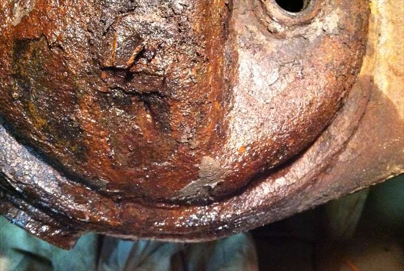

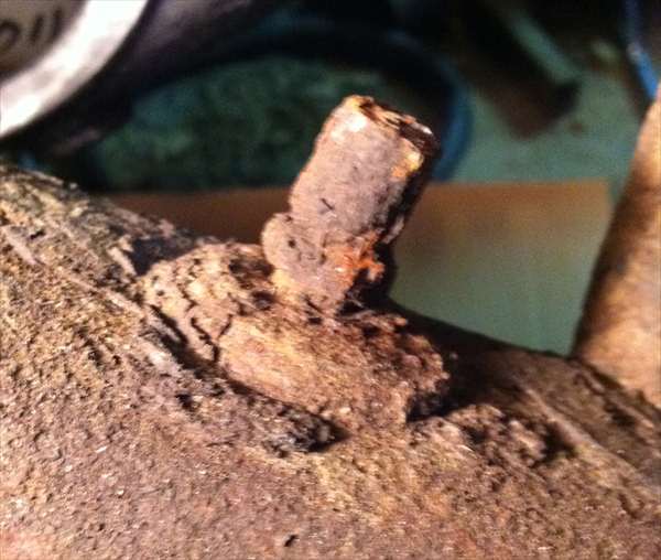

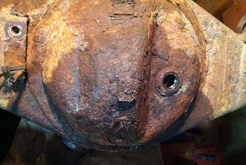

This is the pumpkin cover on my original axle housing. I took this picture after I removed the housing from the truck to get better pictures.
You can see how bad the rot is on this around what used to be the E-Brake bracket.

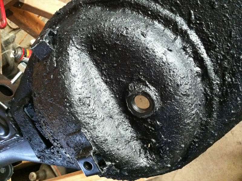

Picture Update 3

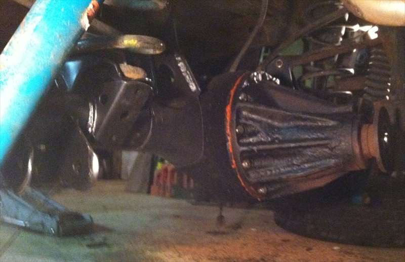

In an effort to prevent this ever happening again, you can see the bed liner I applied to the new housing. I made sure to sand the OEM finish that came on the new housing, and apply two heavy coats of primer before using the bed liner material...don't want this coming off...

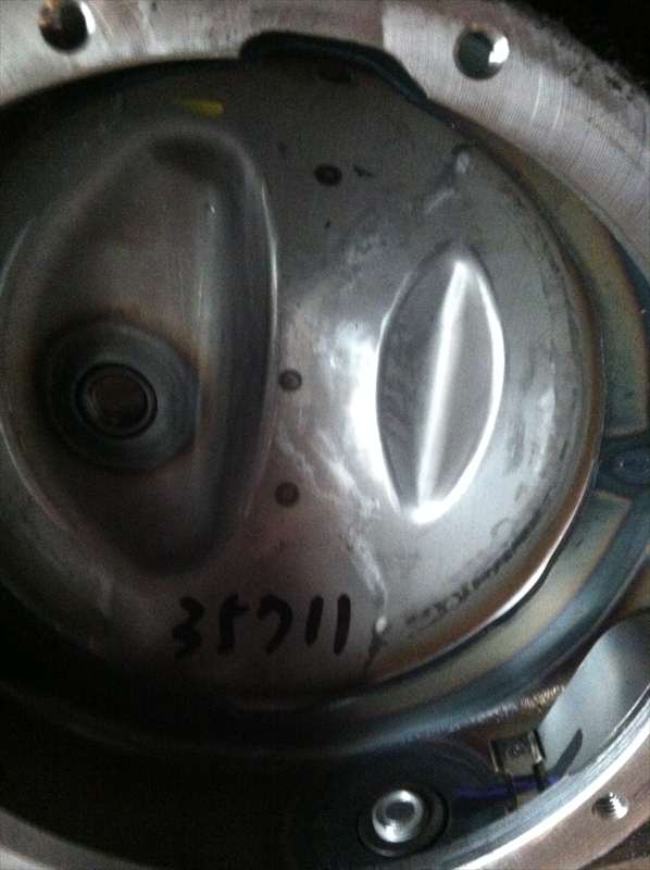

In this picture you can see the inside of the new axle housing. Those four dots up the center of the differential cover are the spot welds for the brackets on the outside.
If there were to be a re-design, a simple fix would be to simply put another 3rd Member bolt ring around the back side of the housing. Then a replaceable cover could bolt onto that... If this cover would have replaceable, this job (axle seals and diff leak) would have only taken a couple of days instead of a week and cost WAY less...

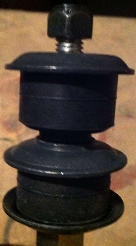

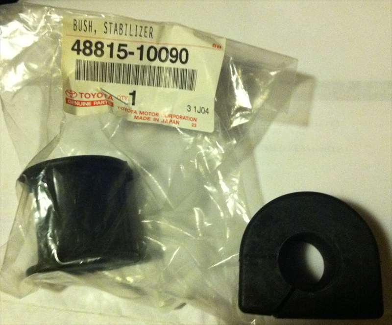

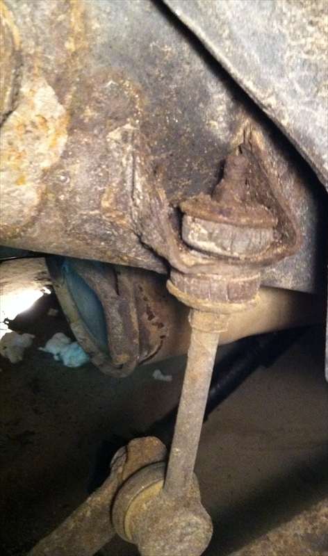

Stabilizer link bushing rot... See for yourself, no amount of massaging would bring these bushings back to life - and that nut is rusted solid... These came out easy - they snapped off... The axle housing bushings turned out not to be this bad, but are being replaced anyways just to be sure.

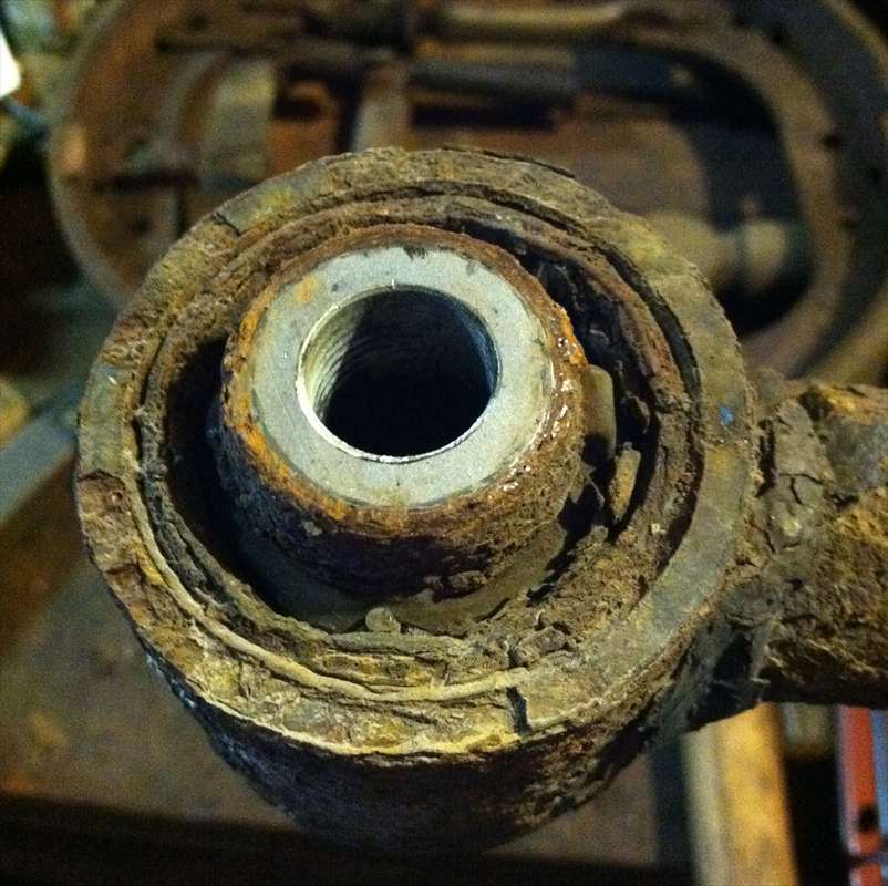

Lower control arm rot... Thankfully, these bushings are the ones that are able to be replaced without replacing the entire arm. However, as you will see in the next few pictures, the process of removing bushings this bad takes time and plenty of effort. UPDATE - The hardware for these, as well as the rest of the control arms did come out without the use of a cutting tool. Had to bash it with a BFH, and get out the 3/4" ratchet and an impact socket. Again, compared to the rest of this project, the cost of new hardware is minimal - so they are going to be replaced anyways...
I took this time to install a wire brush wheel in my angle grinder and give the stabilizer bar, and two lower control arms a good cleaning to remove all rust. Once the old bushings were removed, I coated them with primer, and rubberized undercoat... Hindsight, I would have bed lined these instead...I still may...

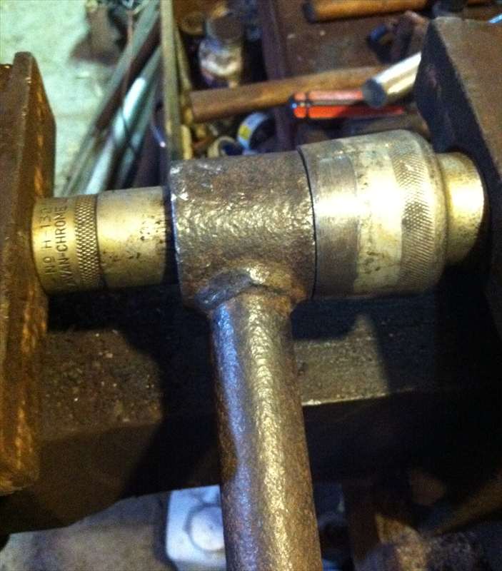

Here you can see how I elected to get the old bushings out. In my tool box I had a set of 3/4" sockets. For the socket wall thickness of my sockets the right sizes were 1" and 1 5/8". The smaller socket's outside diameter fit just inside the control arm end, while the larger socket's internal facets were just smaller than the outside bushing diameter.
Put everything in a big friggin' vise, apply flame to the outside of the control arm end (all the way around) and begin cranking down...
Last one for now...
The metal sleeve that is left was a real PITA to get out... Chisels, BFH, penetrating oil, and lots of elbow grease is how I got it done... I welcome any better suggestions...this sucked...
Today the dealer bushings, and my hardware order should all be in...then it is on to assembly... More updates and pictures to come...

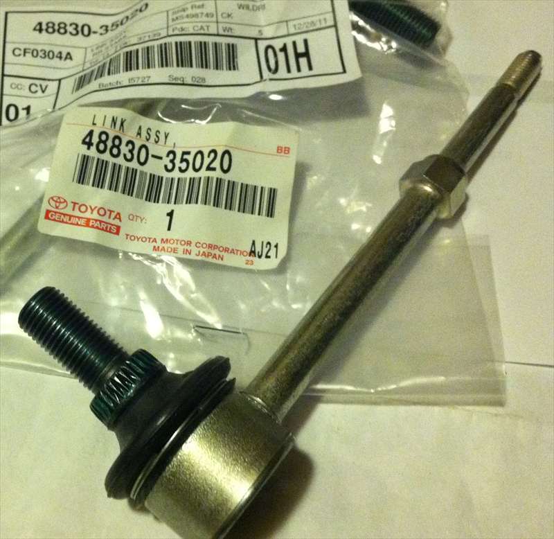

Yesterday's progress... New parts arrived!

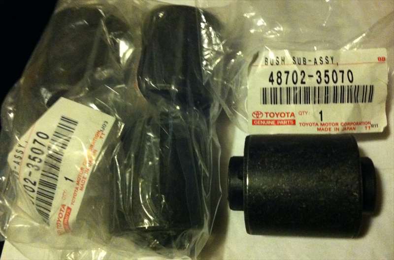

I drove to the nearest Toyota dealer and picked up the new bushings that I had ordered a few days ago... New Stabilizer Bar pillow bushings, end links, and the bushings/hardware needed for the new links.

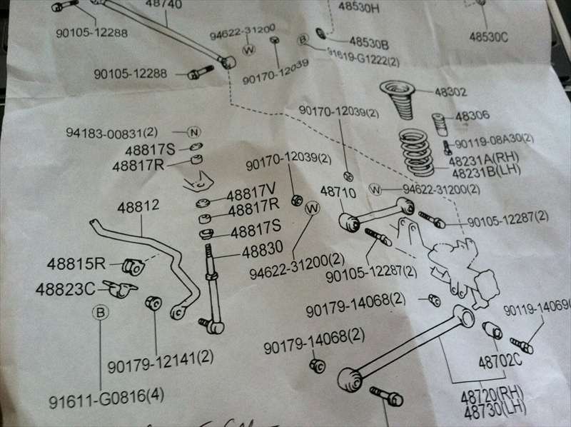

See the picture of the diagram that I uploaded...
As far as part numbers, QTY, and cost...the dealer took mercy on my and gave me shop cost...
4: Lower Control Arm Bushings - Toyota part #48702-35070 at $30.21each (pricey, but needed)
2: Stabilizer Pillow Bushings - Toyota part #48815-10090 at $9.82each
2: Stabilizer End Links - Toyota part #48830-35020 at $69.41each (pricey, but needed)
4: Link Cushion Retainers (Upper and Lower) - Toyota part #90948-02126 at $4.32each
4: Link Cushions (Upper and Lower) - Toyota part #48817-30020 at $2.84each
2: Link Cushion Retainers (above lower cushion) - Toyota part #90948-02127 at $3.33each
2: Link Lock Nuts (to frame assembly) - Toyota part #94183-00831 at $0.72each
2: Link Nuts (to stabilizer bar) - Toyota part #90179-12141 at $1.01each
Grand Total after tax - $337.14 (the bulk of wich were the two links, and the four LCA bushings)

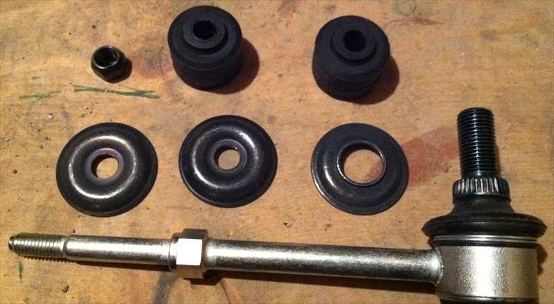

I also got my order of new stainless hardware from McMaster-Carr... For those of you wanting new hardware, most good hardware stores like Worth Smith will have everything you need for this kind of replacement project and would be much cheaper than a McMaster-Carr order (they have minimum QTY purchases for most items...) For this job, I was not anywhere close to a good hardware store...so I had to order the parts I needed... See my first post in this thread for specs on this hardware - I updated a few things in it today...
Turns out that I have neither the proper tool, or the muscle to properly press in the new Lower Control Arm bushings. I attempted to heat the control arm by putting it on top of a wood stove, while placing the bushings in a deep freezer. An hour later I used the socket/vise method and only got a fraction of the first bushing pressed in... So this work is being given to the shop that pressed in my axle bearings for me...

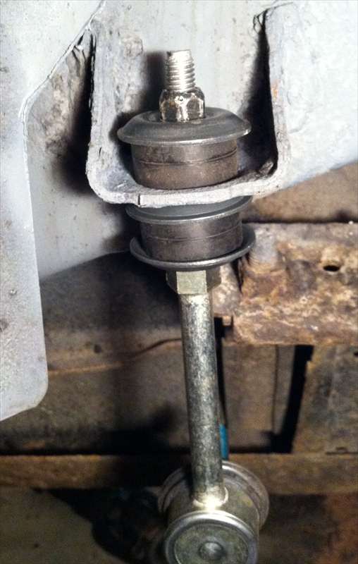

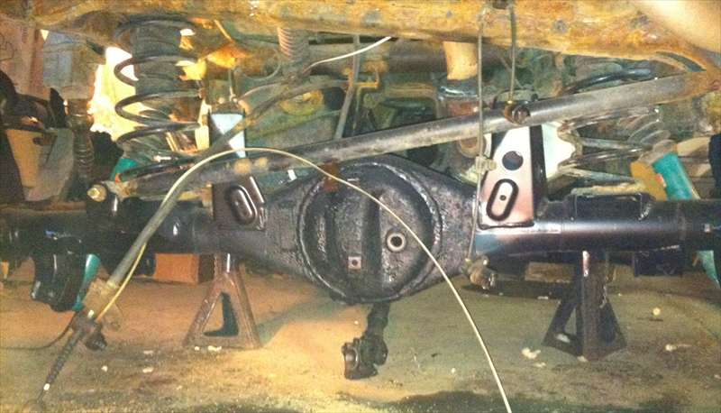

Last night I had a friend come over and help me lift the new housing into place while I bolted it to the existing suspension components. He then helped get the 3rd Member up and in the housing. I stayed up later to button up the suspension, and begin to secure the E-Brake brackets. The remote axle breather kit is installed now, so it is nice and protected behind the gas door.
FYI - The size of the metal brake lines are 3/16"... I opted for two 30" sections, the driver's side run was a tight run to follow the original brake line path as close as possible... The passenger's side had to be run above the original brake line bracket location or a longer section would be needed. No trimming was needed with this length.
Here are a couple pics with the new housing hung... :)
More to come!

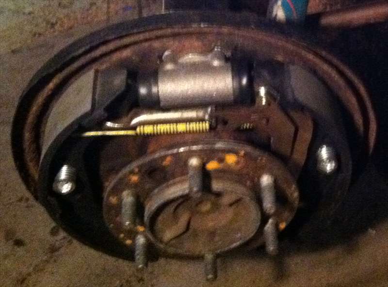

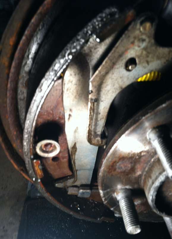

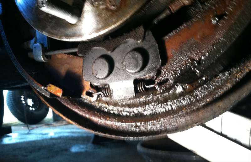

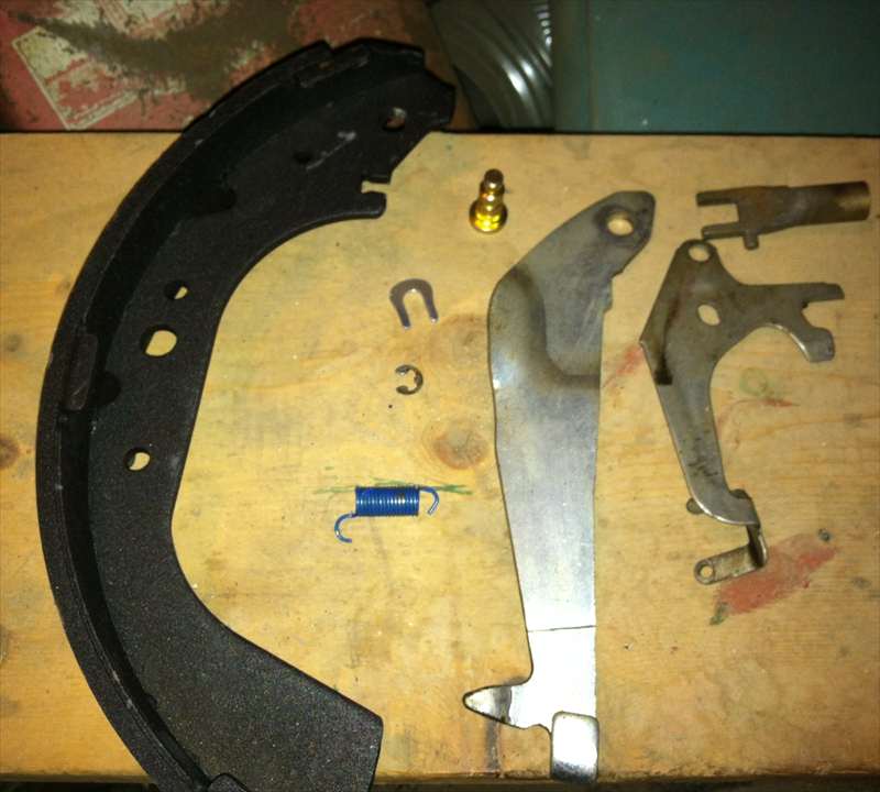

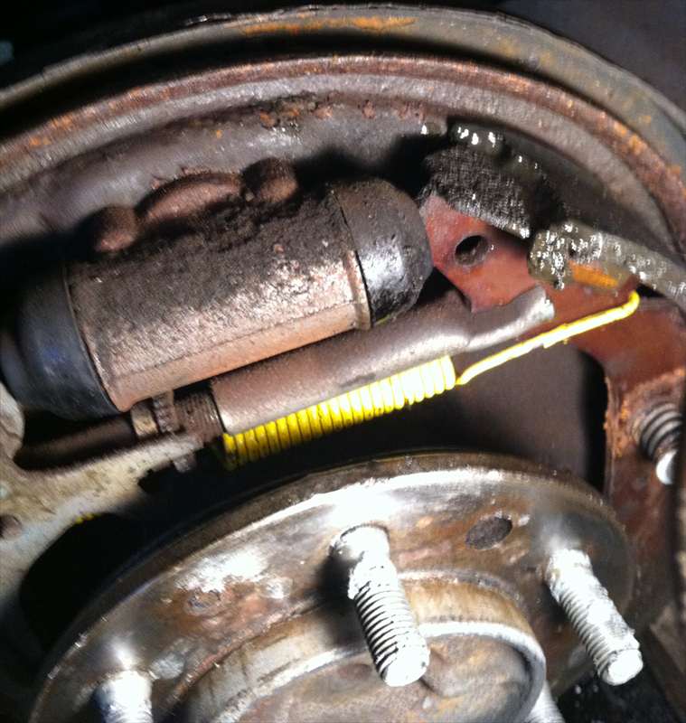

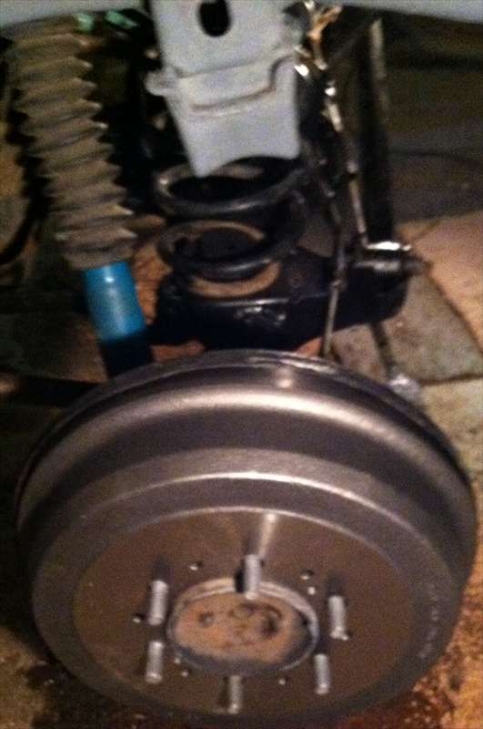

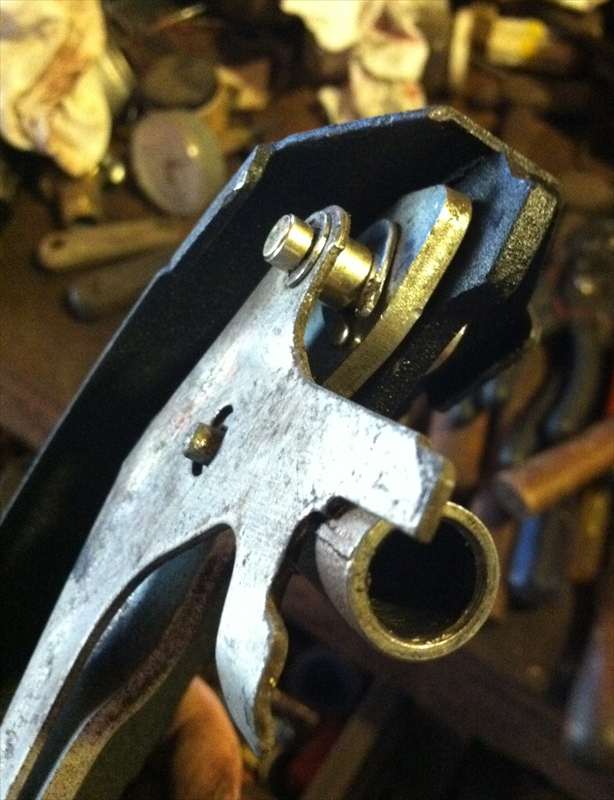

Lastly...The brakes...
Happy New Year Update...To finish out 2011, I installed the control arms with the new bushings, the axle shafts with the new hardware, and all new brake components. Since the axle shaft removal and installation were covered thoroughly in the sticky for this replacement I will not waste time here - and the control arms were just four grade 8 nuts/bolts/washers to get those in...

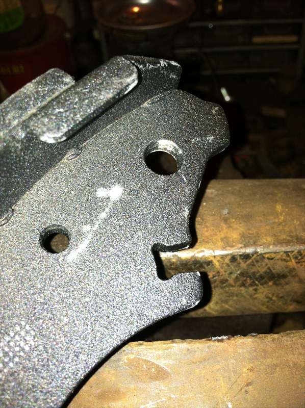

I had no reason to believe that my axle bearings were worn out, but I figured since the seals were leaking gear oil all over them and my brakes, I might as well replace the whole shot... This way I know that everything is good to go, and I now know WHEN the last time these items were changed...
So onto the drum brake setup... be sure to take pictures of your setup prior to removing the old one...but if you neglected to do so, I will include a few pictures of mine...you can see the axle grease from my leaking seal on just about everything.
Salvage Old Brake Brackets and E-Clip...
I read in some other thread about what a PIA it is to use non-Toyota shoes because of the pin and hardware that needed to be re-used... Here are the details of how I did it...with pictures! :)
I went to Car Quest to get a drum brake hardware kit (both sides in one kit), two sets of new shoes (came with two new pins), new cylinders, and new drums... Yes, drums too... Again, since gear oil had been all over the old shoes, I can only assume that this got burned onto the inside of the drums during the 2K+ miles I put on the truck until I had this vacation from work to fix everything... If I have gone this far, what is another $80 in drums...?
Without further fanfare, here is the hardware you will need to salvage from the old brake setup (keep in mind that the driver's side and passenger's sides are different - DO NOT get them mixed up). Basically, the bracket assembly shoe is always towards the front of the truck - but one adjuster is reverse thread, so pay attention to those as well...See pictures below...
From the "top down" on the pin: (QTY per side)
1: E-Clip to keep everything on the pin
1: Metal bracket that keeps the adjuster in place and is held back by a spring to the backside of the assembly
1: Adjuster "fork" (non-threaded piece)
1: Metal bracket for the E-Brake Cable - feel free to mutilate the clip that holds this on the pin.
1: E-Brake Cable
Please note - The only indication I saw of what shoe was meant for the pin/bracket assembly was the pin hole itself. The hole is tapered, or countersunk, on one side of the shoe - this countersunk side is the side that the pin should be seated into. This is the back plate side of the shoe ...
Once the pin is seated properly in the shoe, begin by placing the E-Brake bracket on the pin. The hardware kit will come with new "horseshoe clips" to hold this piece on the pin. Once in place, I used pliers to bend the open end around the pin slightly so it wont come off accidentially...
Next, insert the non-threaded forked end of the adjuster onto the notch in the brake shoe. Then add the metal bracket for the adjuster on the pin, with the adjuster's tab seating in the slot provided within this bracket.
Lastly, keep everything on the pin by re-using the E-Clip from the old setup. The hardware kit did come with another "horseshoe clip" for this, but is is bulky, and not easily re-used if you need to take this apart for some reason. Once the E-Clip is in place, secure the top bracket by attaching the new (blue) spring from the hardware kit between the shoe and the bracket.
To finish up...
The next step is to secure this assembly and the other shoe to the backing plate using the new pins, springs, and spring caps from the hardware kit. My hardware kit came with two sizes of pins, and I had to use the longer of the pins to secure these shoes... Make sure before you secure them, that the top of each shoe is correctly inserted in to the grove in the brake cylinder, and the threaded end of the adjuster gets properly seated to the shoe's notch.
Now that both shoes are on the backing plate, the only thing left is to install the two new springs from the hardware kit and attach the E-Brake cable. I recommend doing the smaller spring first, this goes between the two shoes at the bottom. Be sure to place this spring behind the E-Brake bracket that resides between the bottom of the shoes - you can get a good view of this from my picture of the old brakes earlier in this thread. Then the larger spring can be installed. Just make sure the gap in the coils properly lines up with the threaded part of the adjuster so there are no hang ups...
The E-Brake cable is fairly easy to put on, as the bracket for it is spring loaded, so you simply have to pull on it to fit the open end onto the lever that exits the backing plate.
I am sorry I did not take any detailed pictures during this last phase of the job... The picture you see here is of the Passenger's side once completed...
Once everything is together, I recommend spinning the adjuster out while checking the spacing with the drums. I just spun them out about 1/4" and made sure I could still get the drums on. Once I felt the new shoes slightly rubbing on the drums as I put them on, it was good to go. A few good air bubbles from bleeders and I was in business.
Hopefully after giving up my vacation for my 4Runner, all will be well with the PA inspection process, and it will last me through the remainder of this truck's lifespan... Perhaps next year my vacation will be spent tackling the front end of the truck's suspension and drive line...or not... :)
Abs & rust
...ABS sensors are a PITA to remove, and at over $200each, one should take great care to not damage them. Unfortunately for us rust belt folks, it is not as simple as a flat blade screwdriver and a bit of prying... Remove the bolt, remove the three closest ABS wire clamps/mounts, hose down the sensor base with penetrating oil, and place a set of channel locks firmly at the base of the sensor. Begin to twist back and forth - rotating the sensor 1/4" in each direction to get it moving. Add additional oil every few rotations to aide the movement. Once you are able to rotate the sensor back and forth without a death grip on the channel locks, rotate so that the tab is above the pad it mounts to.
Use a small pry bar under the tab using the top of the axle housing for leverage to apply a little pressure while continuing to use the channel locks to wiggle the sensor back and forth. Feel free to use additional oil to aide in this process, but this was the only way I could remove my ABS sensors from my housing...
OK it isn't just me... CRAP! I just wanted to clean the thing. I'm giving up so I can finish my parking brake job in daylight.
