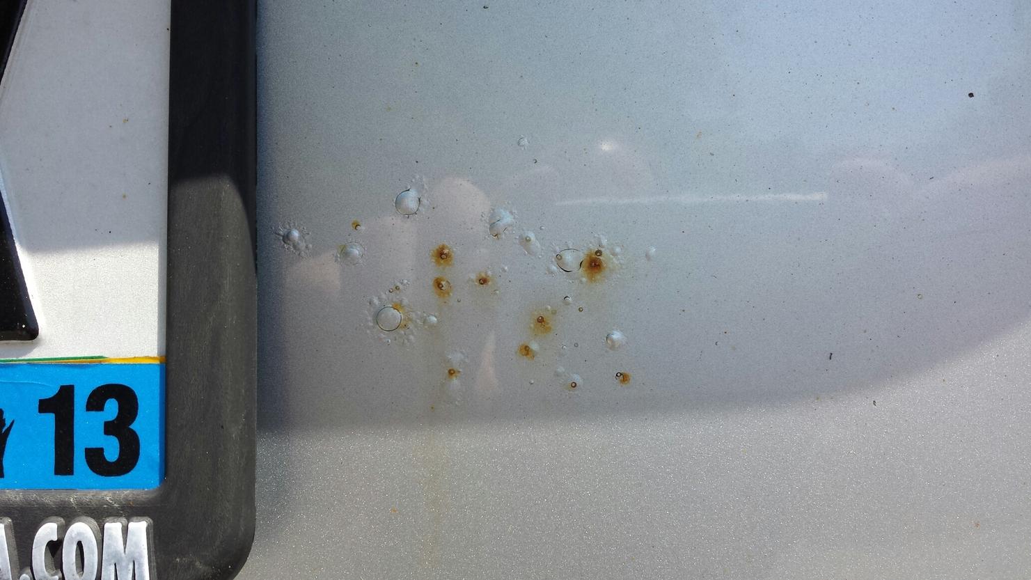

This issue has been happening for years. My 04' had the blistering issue on the tailgate. I now have a 14' and am worried that it is going to show up again. Seems crazy that Toyota hasn't fixed this issue.
Was going to wax my 2012 4Runner Limited this past weekend and noticed 3 very small spots of rust starting from under the paint and clear. I used to work at a few Toyota dealerships and one I'm still friends with the service manager and other people at the dealership. Going to set up an appointment today to get this fixed so it shouldn't be an issue seeing it's under the clear/paint. I know what the causes this issue with the 4runners and other vehicles but I won't say anything to the dealer when I go in. What I believe is the cause is rail dust. Rail dust is exactly what it sounds like, it's dust that is created from the trains wheels and when the vehicles are in transit this dust embeds itself into the paint. I know manufacturers started being concerned about this problem about 15 plus years ago because auto manufacturers started applying that white protection material to the vehicles for their transit to each dealership. This white protection sticker doesn't cover every square inch and the areas where my rust is starting is most likely the area where this sticker wasn't on. After looking closely at the areas around this new rust I can see a few other spots of this "rail dust" embedded into the paint but has not worked it's way down to the metal to start the rusting process. My father's 1999 Avalon has these small rail dust spots all over his car but i don't believe any of them has caused the rust he has now. He waxes his Avalon a lot which is probably why his hasn't developed rust like my 4runner. I will let you guys know what happens when I take her in.
Another note, I've been working in the automotive field for 16 years working at a couple restoration shops and from my experience once rust starts on metal it will almost always come back unless the contaminated part of the body panel is cut out and replaced. There really isn't any chemical that can be applied to the infected area to prevent the rust from coming back. There is a product called POR-15 and it's great stuff but great when applied to a bare metal surface that has not had any rust contamination. I've seen a few rust repair jobs where the rust wasn't too bad but after the rust was sanded down and none left to be seen. Por-15 was applied and it was body worked then sealed, primed and painted. Two of the repairs only lasted about a year and the other the rust came back in 6-8 months.
For this reason I will be demanding a new Toyota rear hatch be painted and installed. Since my 4runner is a 2012 I only have a couple more years on the vehicles rust warranty so I don't want it coming back after my warranty expires. I don't want the rust to come back at all to be honest. Have any of you guys with this issue requested a new panel for the repairs and what did they or didn't they do?
