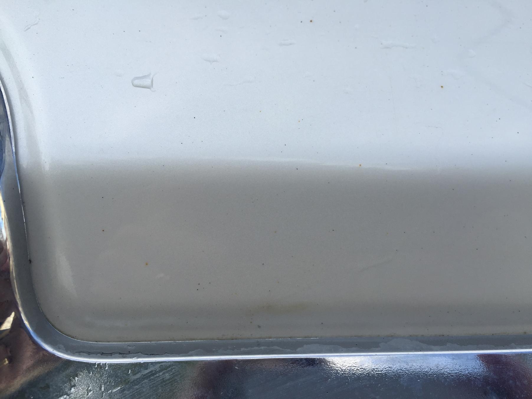

I have taken my 2013 4 runner to Superior Toyota in Erie Pa more than 6 times for rust on the rear lift gate. The color is blizzard pearl. The rust starts as orange specks then progresses to bubble. They have photographed it several times. I was told that the rust is due to external damage. There is more than one area that is rusting and a bubble in the paint on one spot that has not yet started to rust. I have also taken it to 2 non-Toyota body shops who both say that it does not look externally damaged and feel the lift gate was not properly cleaned before being painted. It is rusting from under the paint. I called the 800 Toyota number and was told they stand behind the dealer. I would like someone for upper management to address this complaint. I would like another look at the lift gate. I do not paint cars for a living but find it impossible to be from outside damage when the paint is bubbling from underneath. If a customer spends 50k on a vehicle I feel the toyota should stand behind their name and fix the defect. It is very frustrating and sad that I have spend hours on the phone, at the dealership, at outside body shops, and on the Internet researching and addressing this issue. I have attached pictures, one is of the furthest progressed spot, tone is an area that is starting, the last is still a bubble that has not started to rust.
Today I took it to another Toyota garage . When they put my vin number in I was told they wouldn't even look at it. Corporate has documented on file that it is external damage. Beyond sick over this, not sure what direction to go.

Interesting, mine is just starting to do this, was going to take it in soon, how is this not covered by corrosion warranty? Curious what others think, [MENTION=66316]1engineer[/MENTION] [MENTION=66389]BlackWorksInc[/MENTION]
I noticed as the bubbles formed they would then pop and immediately start rusting, I had two a month or two ago, now seeing at least 4-5 new ones.
Pretty sure the corrosion warranty is "rust through" instead of surface rust, which means there has to be a hole in the metal caused by rust. Bubbles forming in paint means moisture has gotten below the paint somehow, either through the outside (chip or scratch) or from underneath (condensation on metal, etc). I will say some of the tiny rust spots, especially on Blizzard pearl and high metallic colors are easily rubbed off with compound. Bubbles? Only fix is to grind them down to bare metal and get rid of all the rust and then repaint.
I clay bar each spring and fall, I saw the bubbles before they popped on mine and it's definitely rust now, the surface was perfect prior to the bubbles forming so it came from underneath. i know mine will need to be painted either way, guess I'll see what my dealer says. (I will say can't tell much from the picture above given the resolution personally)
I hate to say this because it sounds like a excuse, but your paint could look perfect to the naked eye and still have a pinhole or chip that would let moisture in. Sometime take a 5X magnifying glass out and examine a random section of your paint lol. Bottom line is once it bubbles or rusts enough to see it with just eyesight alone it's too late to see if there was a small blemish there to begin with. Most, not all, but most of the time the moisture starts from going through these small blemishes, pinholes, scratches and the rust will be on the metal underneath. If it started from the other side of the metal then by the time it blistered the paint it would be rusted completely through the metal and that's usually not the case.
Understood, thanks for the insight.
Unfortunately everything that has occurred is common practice and true.
Rust warranty is only for rusting through panels.
What this originally started as is known as raildust, common on cars but obviously more visible on white vehicles. What solves this problem if handled up front initially is an acid bath that actually neutrializes and removes the rust particles. Unfortunately once a warranty claim is submitted it goes on file to the vehicles VIN, this obviously to prevent an individual to go from dealership to dealership and cashing in on multiple issues that are actually the same problem. Once warranty has come back it is often put on file, so even if submitted for a second time the original reference paperwork/documents/pictures will be tied to the second claim. From here once Toyota Warranty has ruled via dealership your only bet is if possible....confront the manager of the dealership where you bought it if new? Or you will actually have to take it to the Toyota warranty helpline as taking it to any other dealerships will not progress the original ruling.
Sorry sir.
I am just going to throw this out there because I have heard of similar before to what you are experiencing.
Google "paint damage from rail dust". Bet you dollars to donuts this is what is causing your problem. ;-)
Edit: Sorry wadle - I just saw your post where you said the same thing. We agree. :-)
