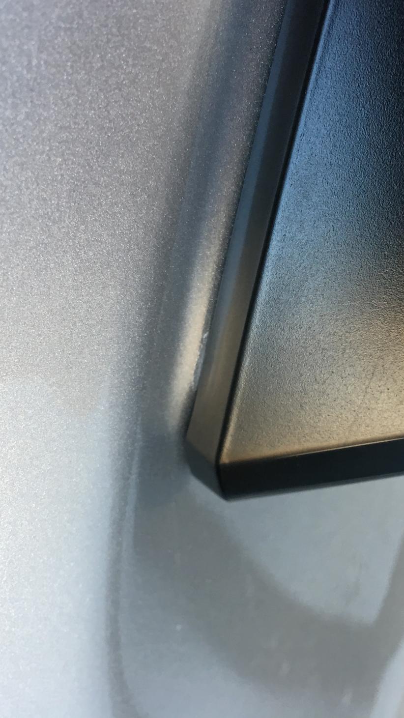

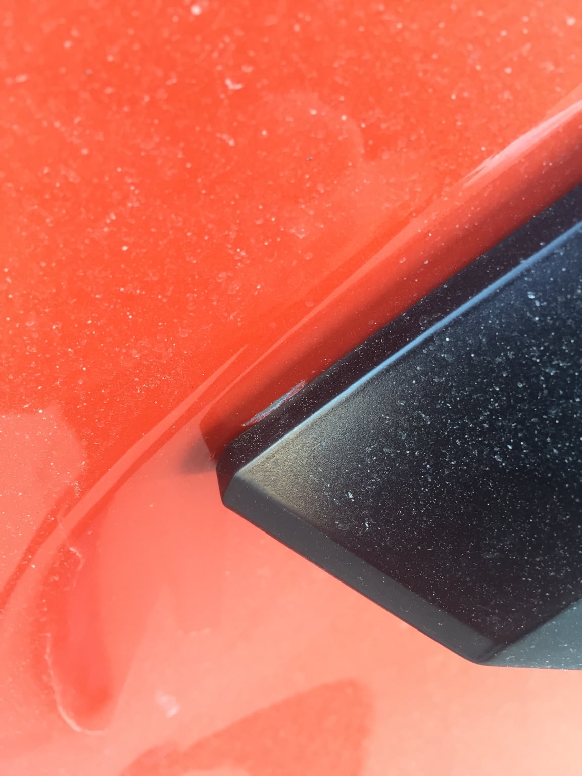

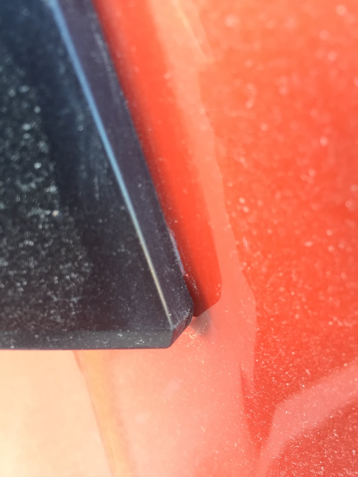

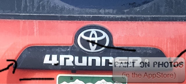

I noticed on 15 4Runner that the rear valance had rubbed the paint off my hatch. Sent pics to dealer and it is in the body shop getting fixed should get it back tomorrow. Toyota covered it under warranty. Pics below
i'm having a little trouble figuring out where that is, do you mind backing up a little so we can keep an eye out
[MENTION=113833]e60ral[/MENTION] it is in the shop right now getting paint but it is the lower right and left edge of the rear lift gate garnish. The Handel with the Toyota symbols that is used to open and shut the lift gate. Hope that make sense.
Did they have to repaint the whole tailgate to fix where the garnish rubbed thru the paint? I'm seeing the same thing on my 2016 Trail on one side. Rather not have the whole thing repainted if avoidable. Assuming Toyota will cover it when I take it in.

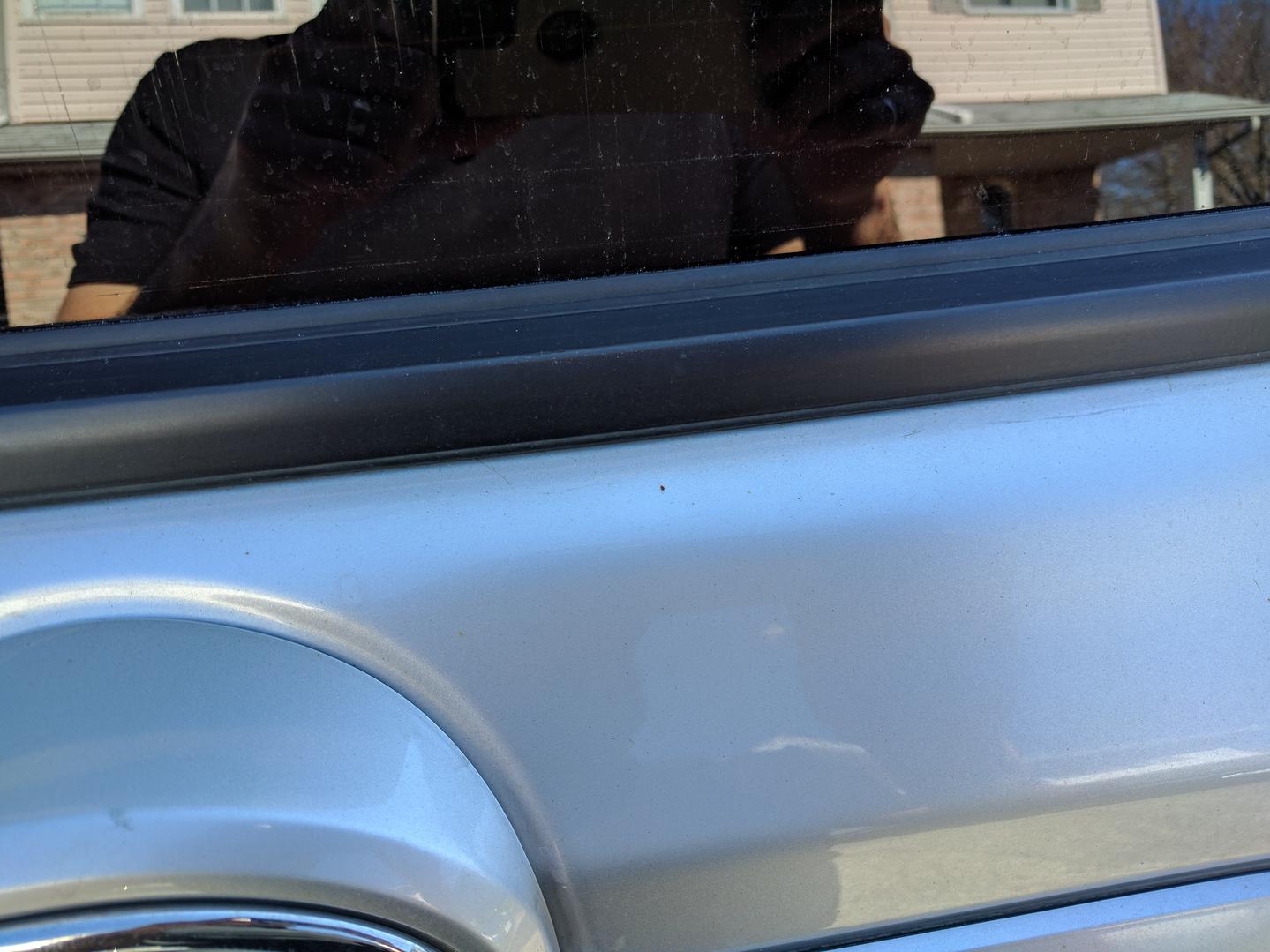

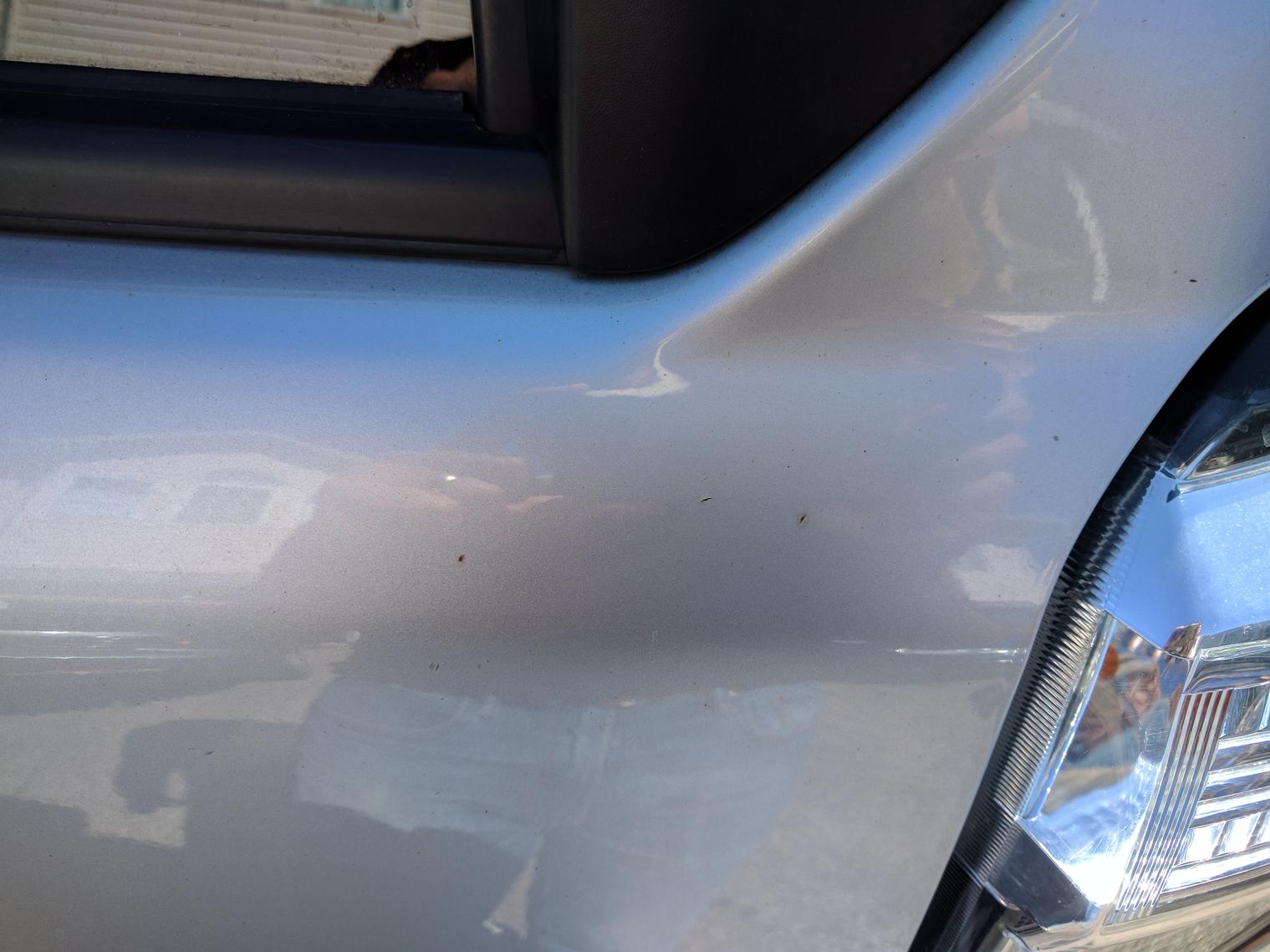

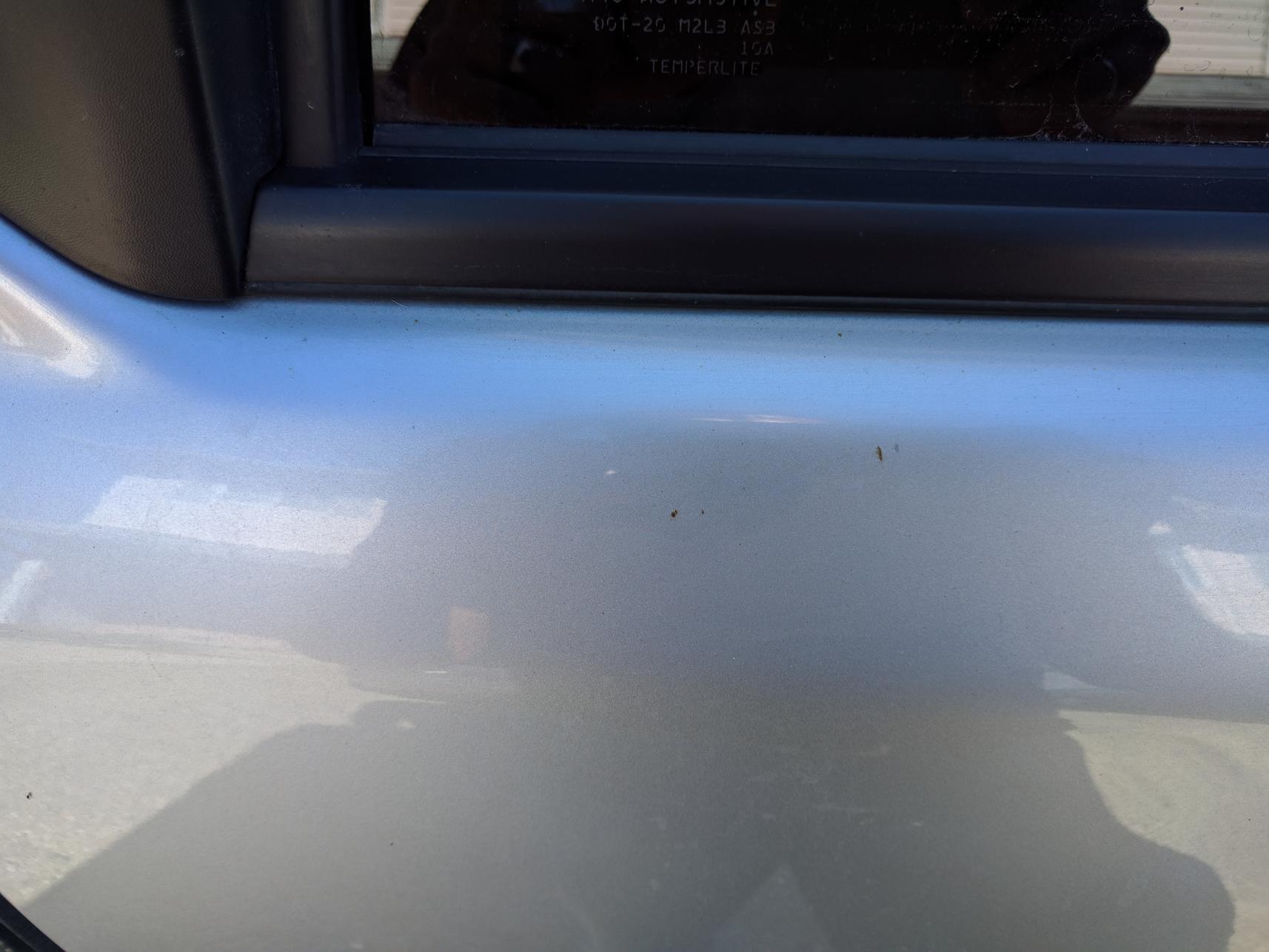

Micro Rust Spots onTailgate
Hey guys,
So I purchased a 2014 SR5 4Runner with 80k kms and its not even two weeks old from the dealership and I noticed the micro rusting on the tailgate. I'm going to contact the dealership and see what they say. It is peppered over the tail gate.
Any advice?
^^ paint contamantion after painting is not a prep problem, it happens after painting
Sent from my SM-G930V using Tapatalk
Hey guys,
Any advice?
It's called rail dust. Requires an acid wash
Sent from my SM-G935V using Tapatalk
I agree a lot of it is metallic particles landing on paint. Mostly from plow trucks, they have iron wear bars, that and metallic brake particles. Trust me I deal with after a long winter as my 2016 is white.
However some of those rust spots look like more than that, some look like chips that went untreated, and after a few days on the salt covered roads they turned rust brown in color. Clean that rust off with whatever product you choose, but look close at it after and see if the paint is chipped.
