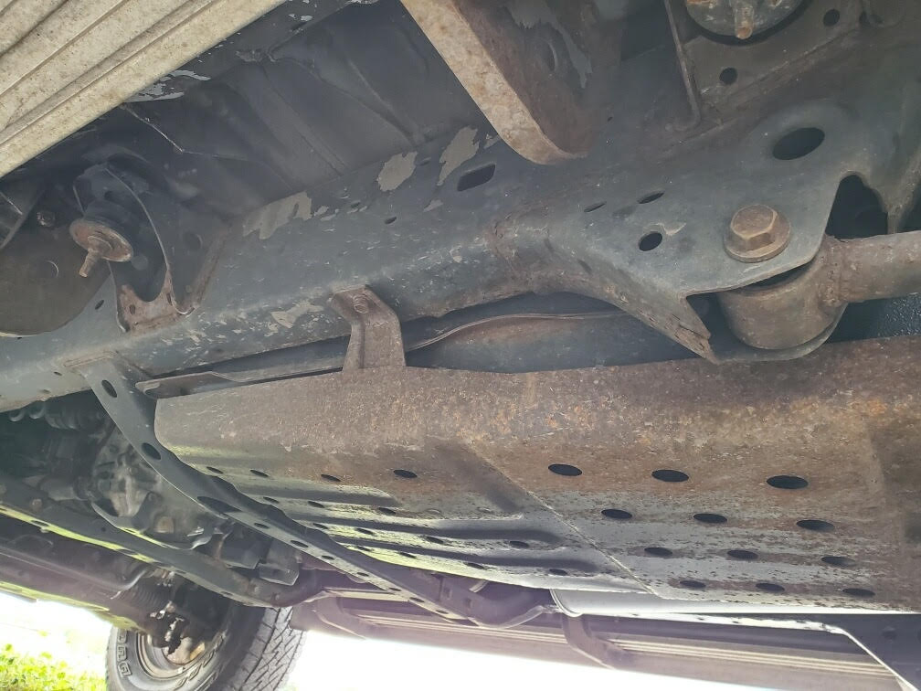

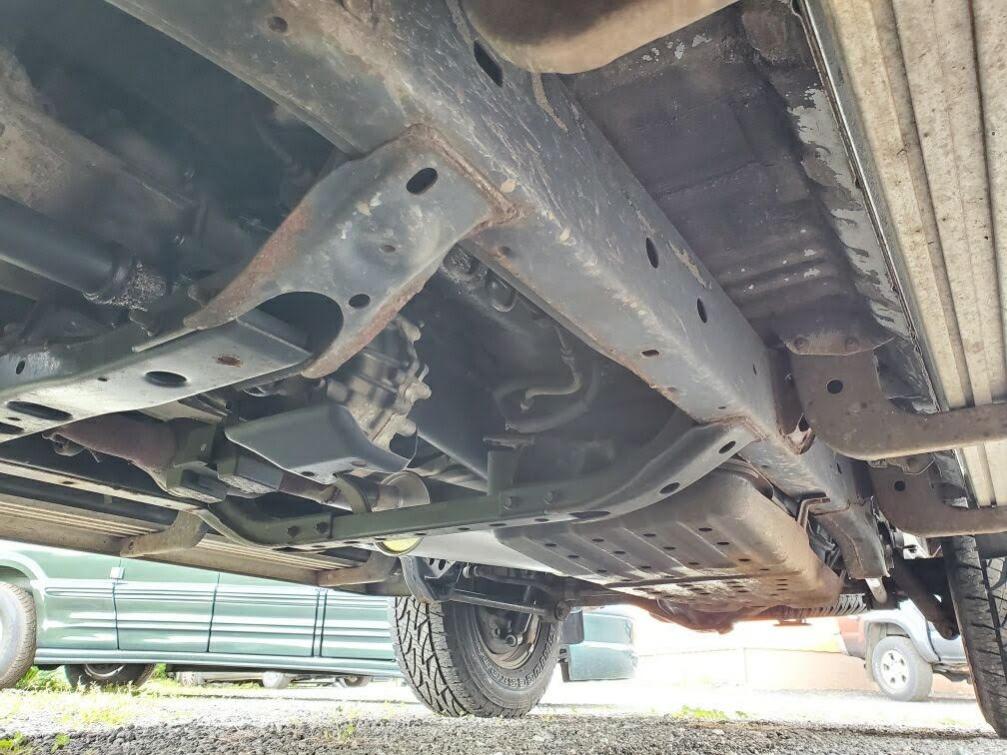

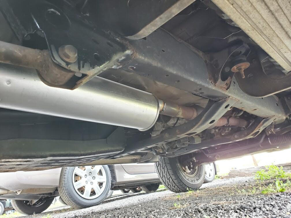

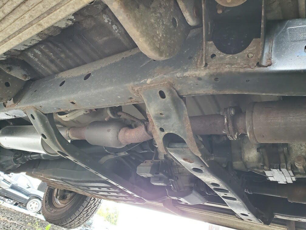

I'm going to post a few pictures of the front half of the underside in hopes some of you more experienced with 4Runners in the NE can give me a better idea of what I'm likely to be looking at problem wise based on the amount of rust seen. The skid plate seems to have had the worst of it, as the beefed up area around the jack point (where the larger hole is) is rusted out, and I think there was supposed to be another skid plate back towards the tranny which isn't there anymore. :shrug:

Pardon the rather haphazard photography. I was taking a break from dealing with a grease gun stuck on the zerk for a spider...else I was considering explosives:frusty:

I just got my 2010 T4R TE that spent most of its time in NY. It has about the same amount of rust. There are plenty of videos on how to clean it and coat it with POR15. That is my plan.
I am a bit concerned about bolts and propeller shaft zerks though.
