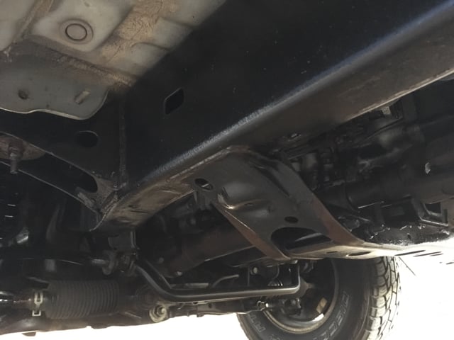

Something like that. It's touched up every year though. This is a picture of my undercarriage on Oct 31, 2016 from the passenger side looking toward the front end. 4Runner has been on the road since March 2013. Can't say I have any complaints.
