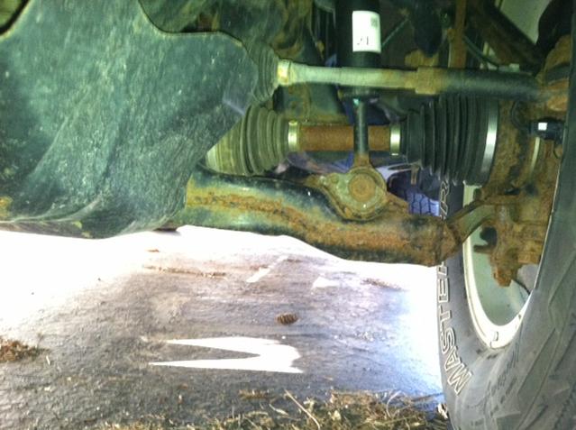

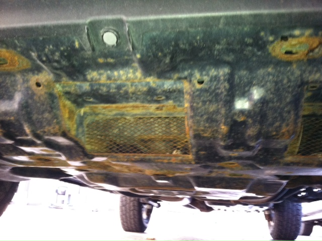

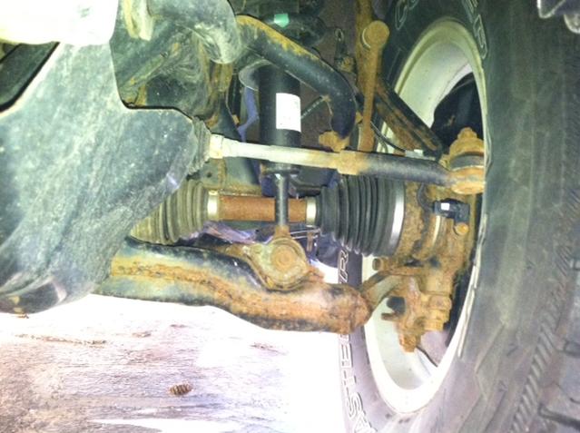

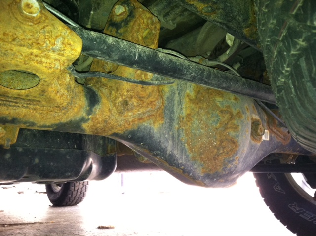

Hello all. I bought a used 2011 (~ 33k miles) 5th Gen 4runner Trail for about $27k (before taxes) about a month ago. The 4runner I think was bought for a decent deal; no nav, has sunroof, base seats, ect. but everything looked to be in good shape and runs fine.

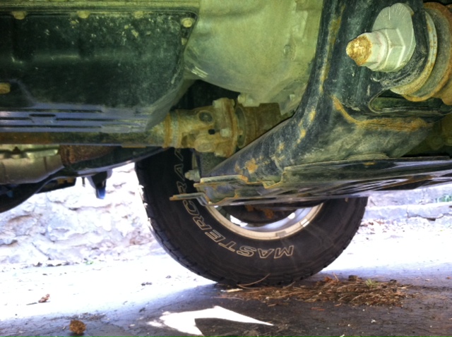

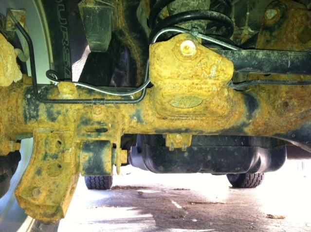

The one thing that concerned me slightly was the rust on the undercarriage/frame. This 4runner was bought in upstate NY, so rust is going to happen. I was aware of it before I made the purchase, so this not a surprise to me, but I was intending to clean up the underside and rust-proof, as much as possible, the vehicle. Here is what I am dealing with:
My question: What options do I have for cleaning off this rust and preventing rust in the future? Anyone have any recommendations for products/ procedures that worked well for them? Please note that I had the flash on, so the rust parts were highlighted somewhat; they stand out more in these pictures than they do in real life.
I am realistic on this. I realize I won't get all the rust off, and I realize that eventually more rust will get on there (this is the Northeast after all).

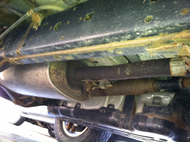

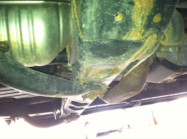

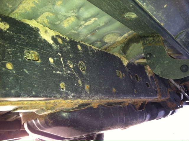

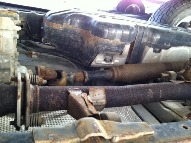

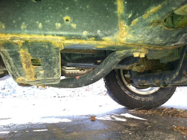

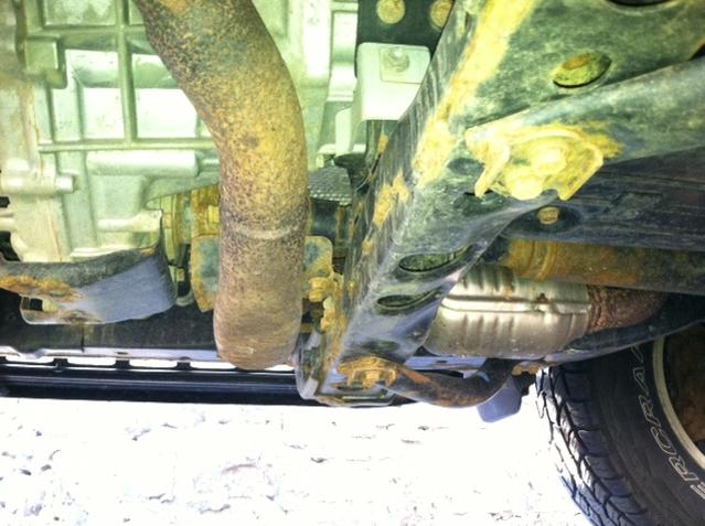

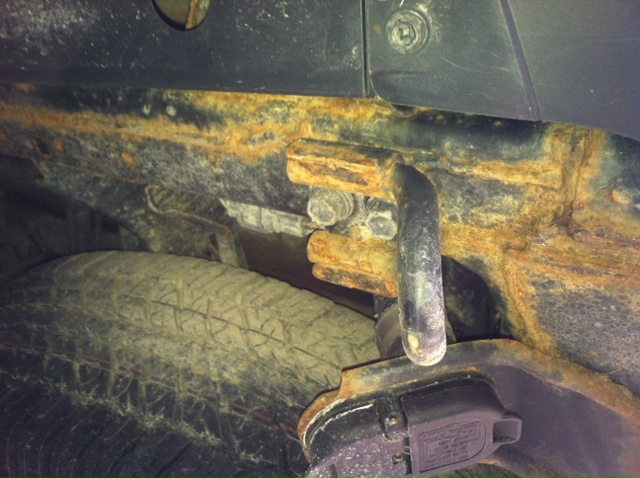

A few more pictures.
Also 2 of these pics show what I think is part of the exhaust piping....it's the pipe that is flattened somewhat near the cross-brace/strut. Is that pipe supposed to be flattened like that? And why is it not located above the actual frame of the truck? It seems like it is sticking out and just asking to get smashed in or broken by a boulder or obstacle.

my 2¢:
- take it to a self-wash bay and do a super thorough job cleaning off the underside with the spray wand
- let it dry completely
- use a wire brush to remove the loose stuff on the worst offending areas
- cover it in Fluid Film (you can spray it inside of the frame rails, as well)
- reapply Fluid Film annually in late summer/fall
Fluid Film should arrest the spread of existing rust and prevent new rust from forming. unlike other treatments, it doesn't attempt to "encapsulate" rust, which means that while it won't create a scenario where the steel rusts from the inside out, it does mean it's not a one-time treatment—it's a maintenance task.
the exhaust crossover pipe is normal, btw.
I agree with sandcrawler. You should also be able to find places up north that will spray an undercoating for you.
I discovered fluid film this past year and used it to undercoat my truck before the winter to prevent salt damage. So far it's been awesome, just rinse it off and it's like new again. In your case I would wire brush the rough stuff, use an abrasive pad on everything else and cover with a good epoxy paint. Use fluid film on top of the paint before the winter hits again.
+1 for fluid film. Used it for the first time ever when my wife got her '15 TEP about 5 weeks back, and was really impressed with how well it goes on and so far, how well it stays on and resists the magnesium chloride they put on the roads in CT.
For the rough stuff, I'm with MoS, wire brush it down just to get any scale or loose paint off, then hit it with a good rattle can rusty metal paint (rustoleum is my go to), then fluid film afterwards. What I like about the rustoleum is that it doesn't try to seal rust in, it just slows it down, that is the rust will come back through if it's under the paint, which to me is better than having it rust out the backside. The FF should take care of the rest.

I would recommend using a good paint then a coat of Fluid Film over that once the paint has cured. I don't see a problem cleaning and painting the drive shaft or anything else. It's not like you're coating it with something thick like LineX.

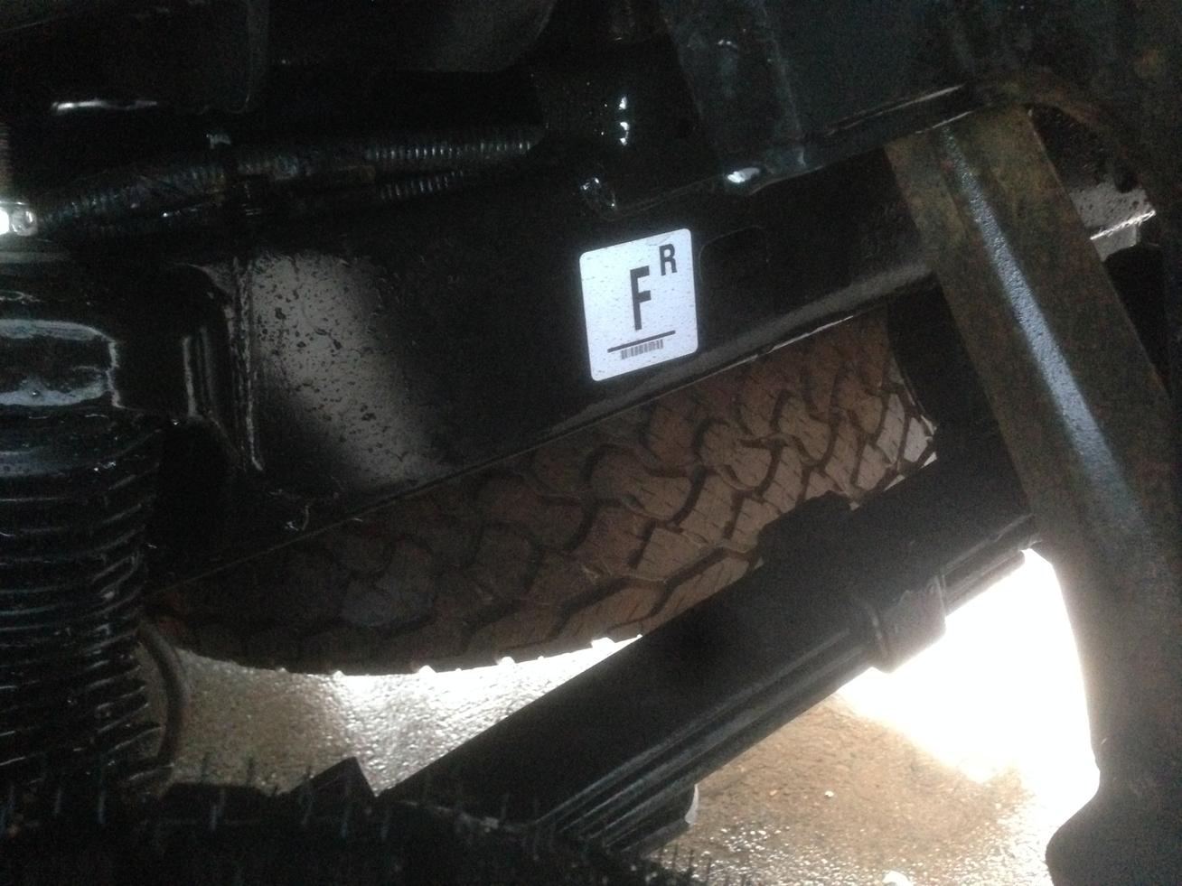

Here my new frame on a 12 year old truck! Thanks Toyota. Previous owner didn't put a drop of undercoating anywhere on the truck.
