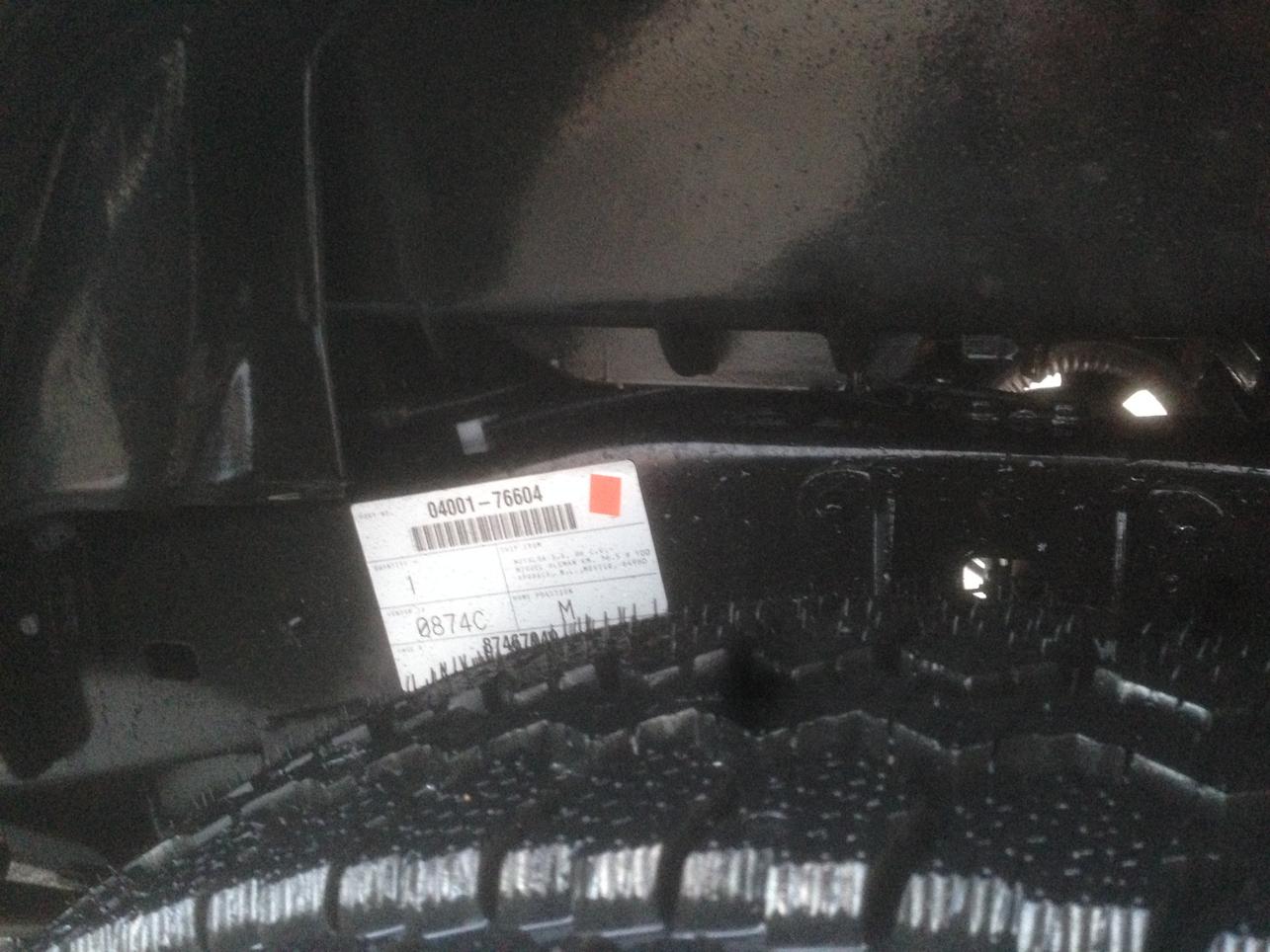

New frame, leaf springs, lower control arms, brake and fuel lines, some wiring harnesses, drive like a new truck. Off topic I know.

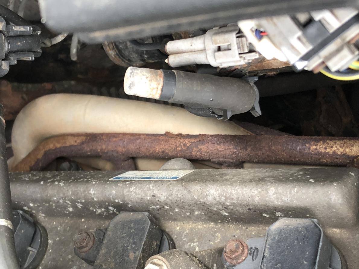

Hello all. I bought a used 2011 (~ 33k miles) 5th Gen 4runner Trail for about $27k (before taxes) about a month ago. The 4runner I think was bought for a decent deal; no nav, has sunroof, base seats, ect. but everything looked to be in good shape and runs fine.
The one thing that concerned me slightly was the rust on the undercarriage/frame. This 4runner was bought in upstate NY, so rust is going to happen. I was aware of it before I made the purchase, so this not a surprise to me, but I was intending to clean up the underside and rust-proof, as much as possible, the vehicle. Here is what I am dealing with:
My question: What options do I have for cleaning off this rust and preventing rust in the future? Anyone have any recommendations for products/ procedures that worked well for them? Please note that I had the flash on, so the rust parts were highlighted somewhat; they stand out more in these pictures than they do in real life.
I am realistic on this. I realize I won't get all the rust off, and I realize that eventually more rust will get on there (this is the Northeast after all).
