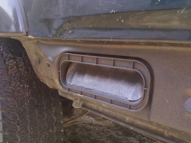

There is minor collision damage to the rear of my 4runner. It was like that when I bought it so I just removed the mangled bumper and sprayed a small section with (I believe it was rustoleum) bedliner for rust prevention. Then I rattle canned over it with some metallic grey to keep the bedliner from fading. It's held up fine since this past spring.
Its hard to tell in this pic but the metallic paint makes the bedliner look a lot better IMO. Nevermind the fact my truck needs a bath :(

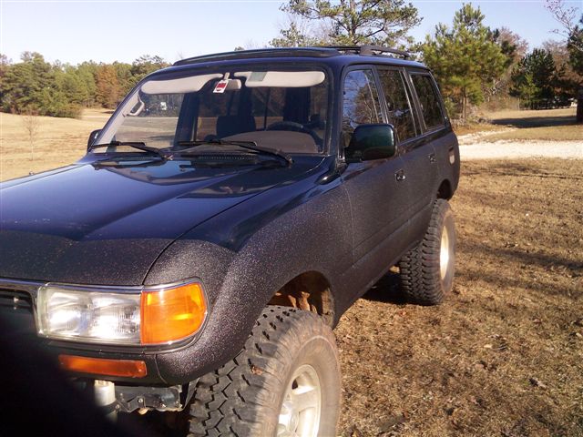

I'm not a fan of certain bedliner textures either but I'll have to say that the Raptor/Upol kit I got off ebay turned out really nice. I think the directions say to spray at 40 PSI (maybe?) but I sprayed around 80 PSI and it looked awesome. I highly recommend spraying with an oil based paint directly over the bedliner and this will keep it the color you want without worry of fading.

I have ordered the kits from U POL and my Land Cruiser is completely primered and ready to shoot. I definetley like the look you have on yours, question's stands: what oil base paint did you use? so, I shoot the raptor liner,it dries and then follow up with the oil based right? Any advice helps.
