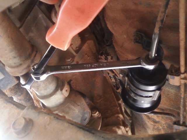

1) Put a wrench on the filter nut and get it so that the wrench attached to the filter nut is at the same time resting on top of your driveshaft.
2) Then rig up something like I did in the photo below to get leverage on the fuel line nut.
3) Use a small bottle jack upside down to wedge between the body of your truck and the end of the pry tool.
4). Extend the bottle jack until you feel like you have a decent amount of pressure put on the lever.
5). Leave over night.
This may be an elaborate setup and quite honestly I don't know for sure there is enough room under there to set this all up. Mine came out fairly easy.
