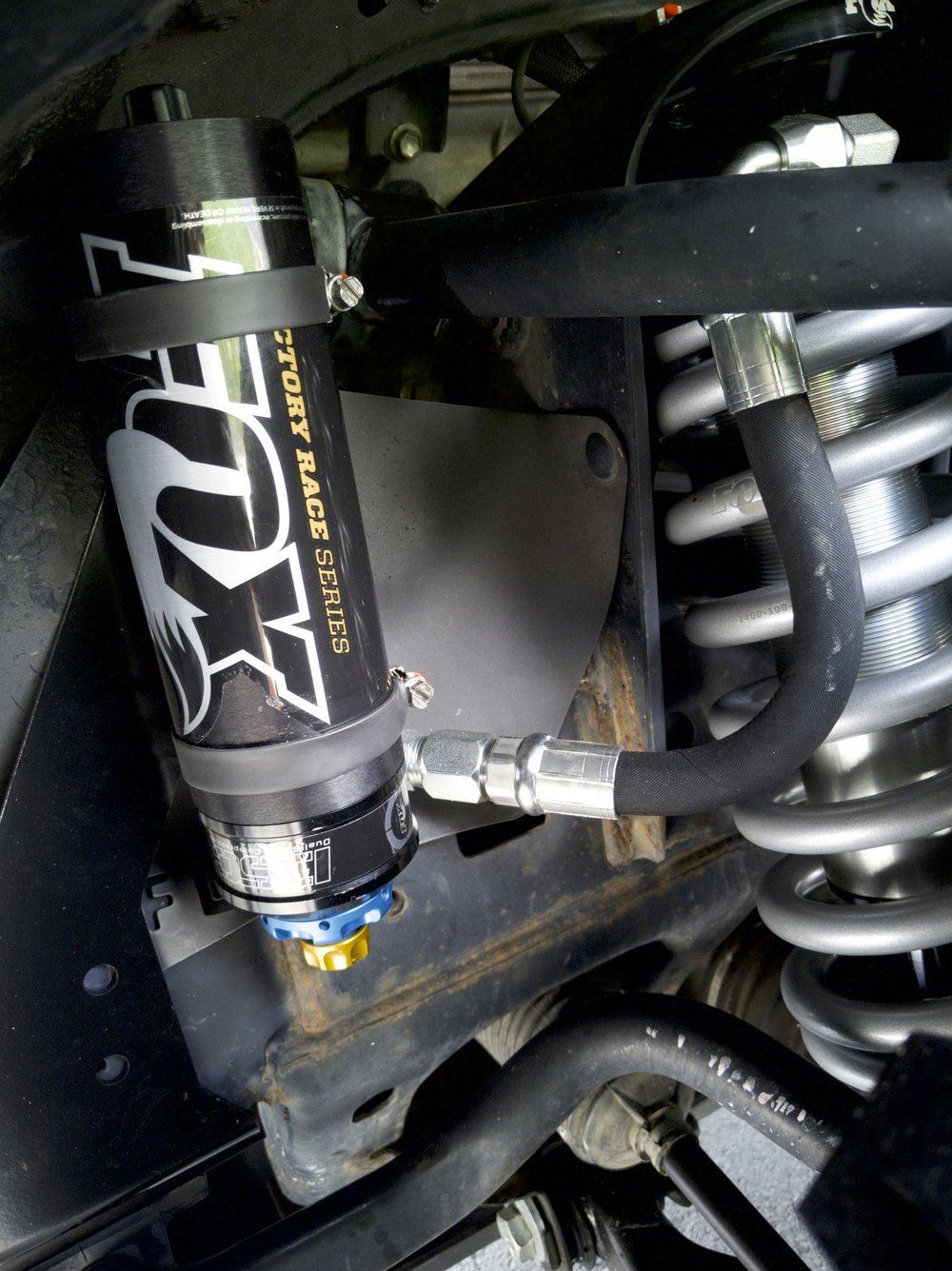

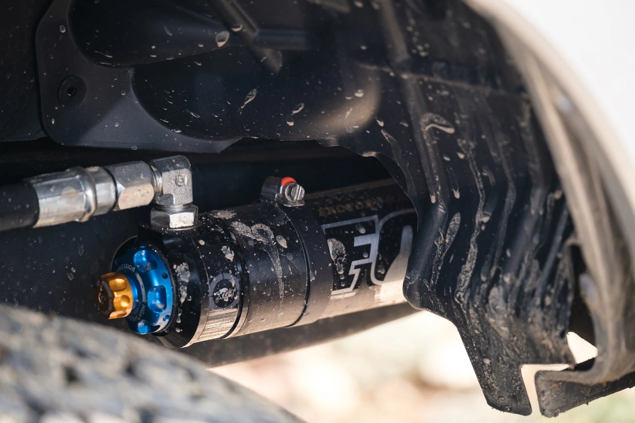

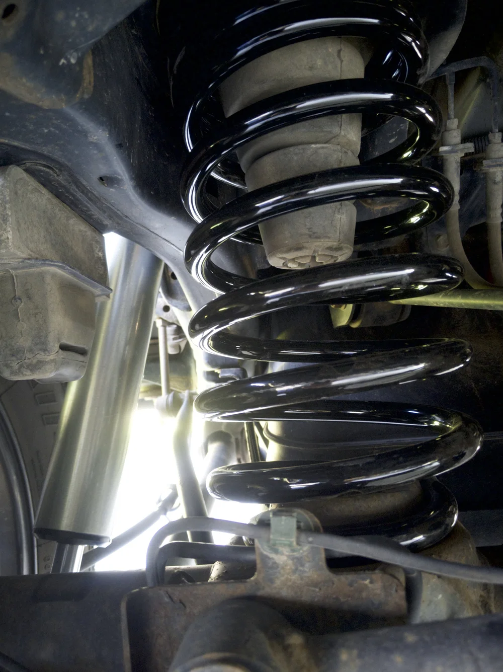

Replaced my Toytec Boss Suspension setup for Fox 2.5 w/ DSC and some Dobinson Rear Springs

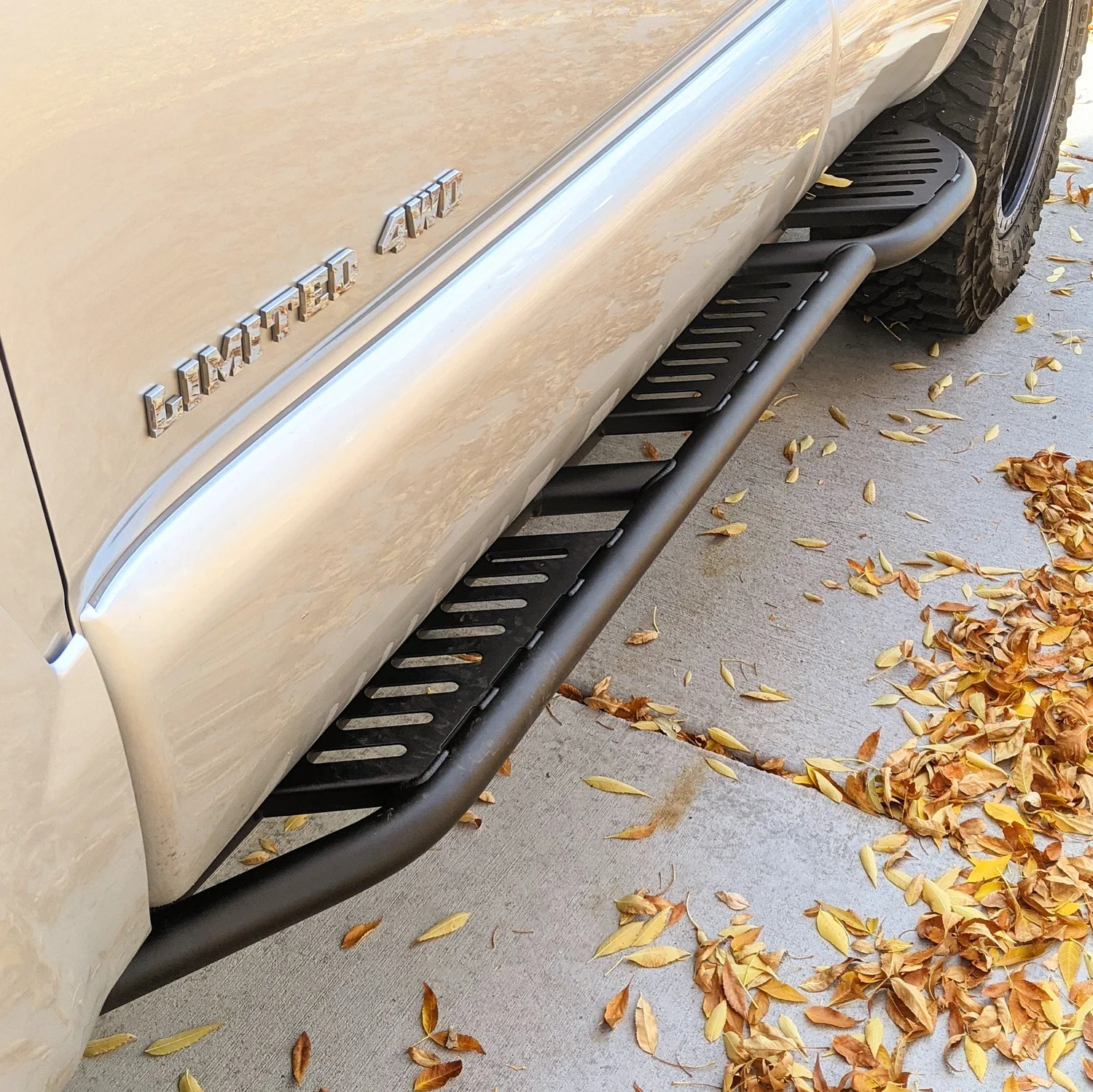

Replaced my RCI sliders w/ Westcott Design Bolt on Sliders

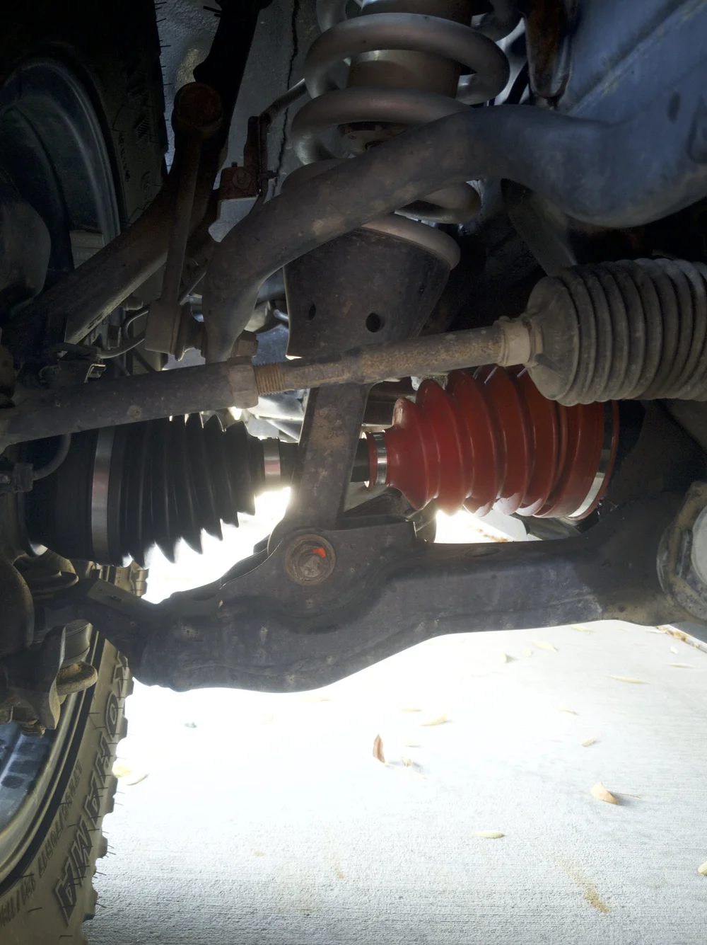

Replaced my front axles with CVJ Axles

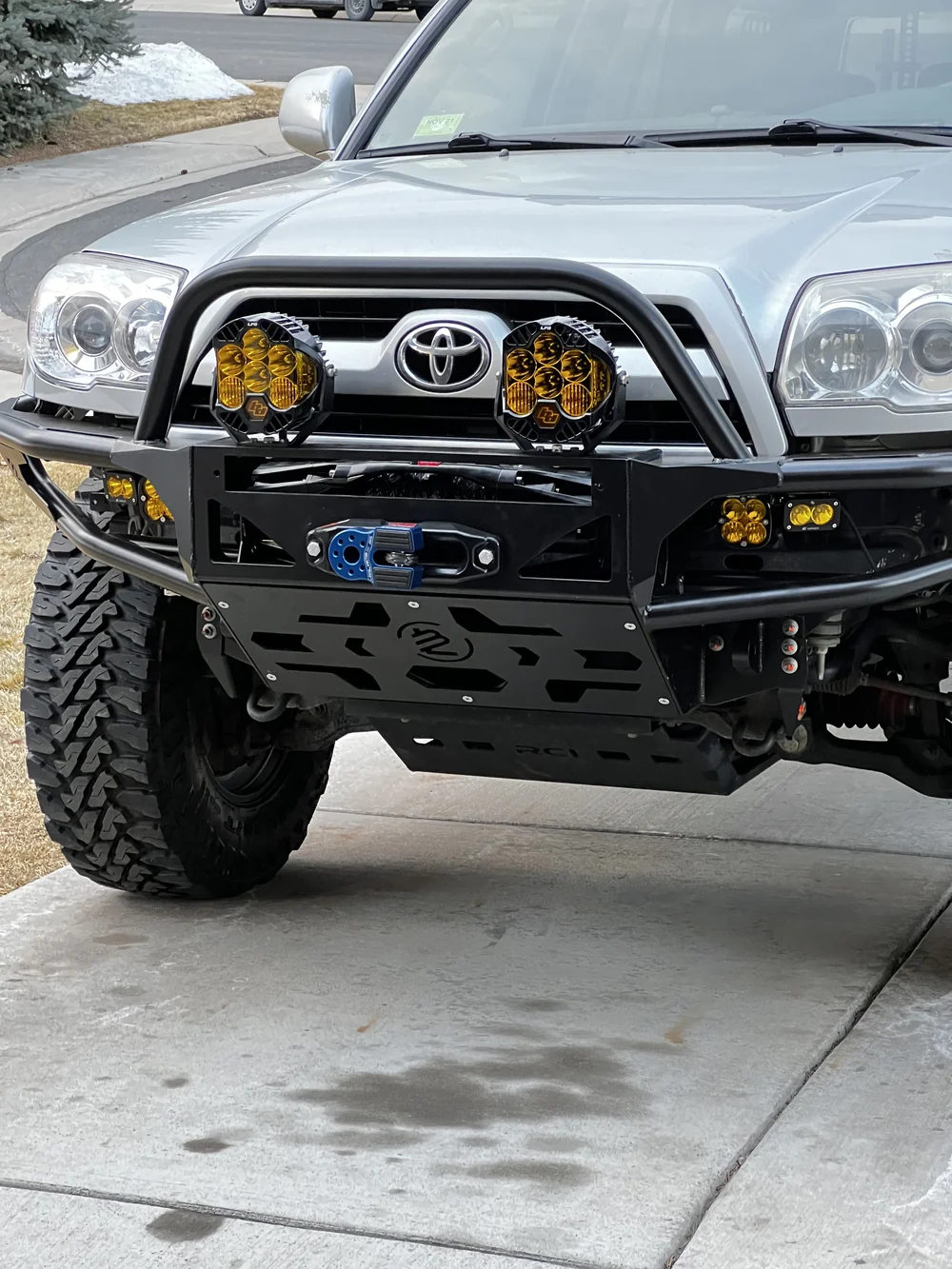

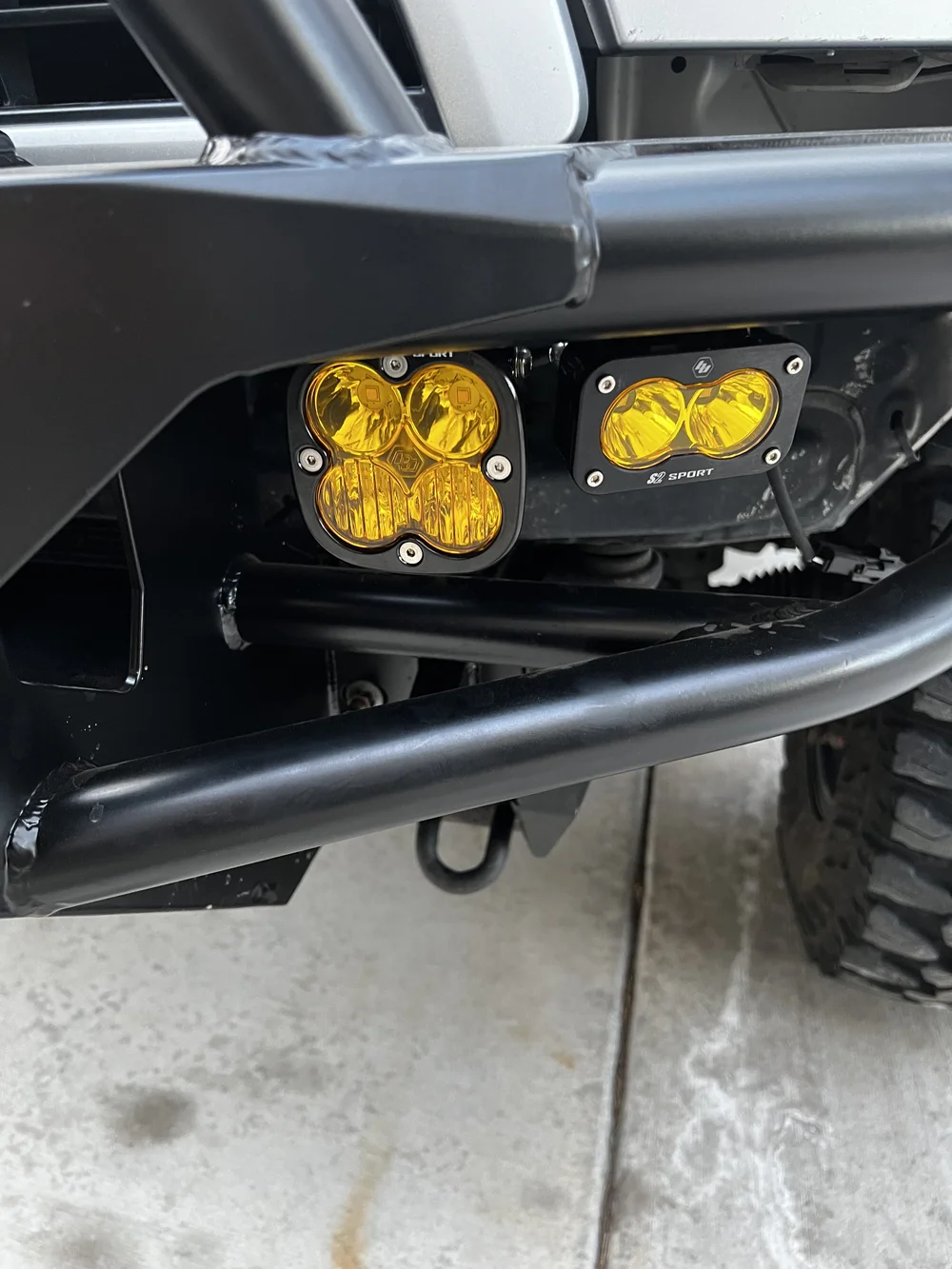

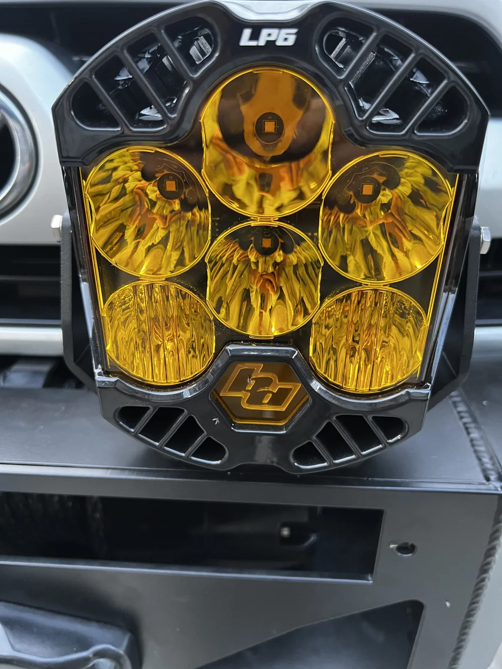

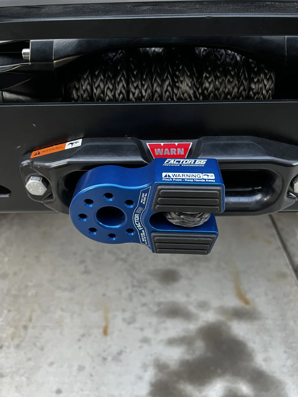

Installed LiL B's front bumper w/ assortment of Baja Design Lights and Warn Evo 10s
