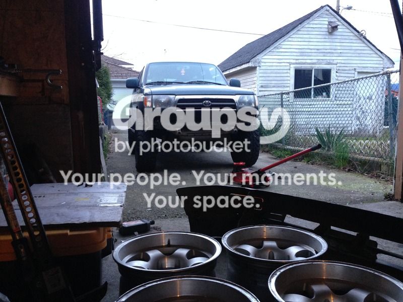

When I first got it...
Picking it up at the shipping yard.

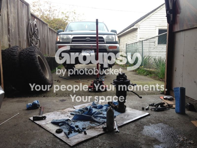

It also needs front wheel bearings like nobodys business. since they are press in they are not very easy to change. in an effort to reduce down time on the truck and since i barley have a driveway to work in i bought spare knuckles from the wreckers to rebuild. it was fun learning how they came out at the wreckers without consequence. Of course ow that i was doing a whole knuckle I realized there may be more things i should do at the same time. this spiraled out of control and now I am here...
IMG_0570.jpg~original
IMG_0612.jpg~original
IMG_0611.jpg~original
New wheel bearings
Inner and outer seals
High angle outer cv boots
new inner boots
upper and lower ball joints
new dust shields
wheels studs
Total chaos spindle gussets.

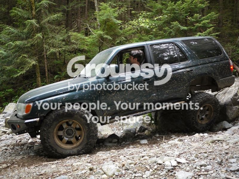

then came the OME lift. I used 881 front springs and 906 rear springs with a 10mm trim packer. ended up with 2" of lift total.
Before...
IMG_1002.jpg~original
After...
IMG_1011.jpg~original

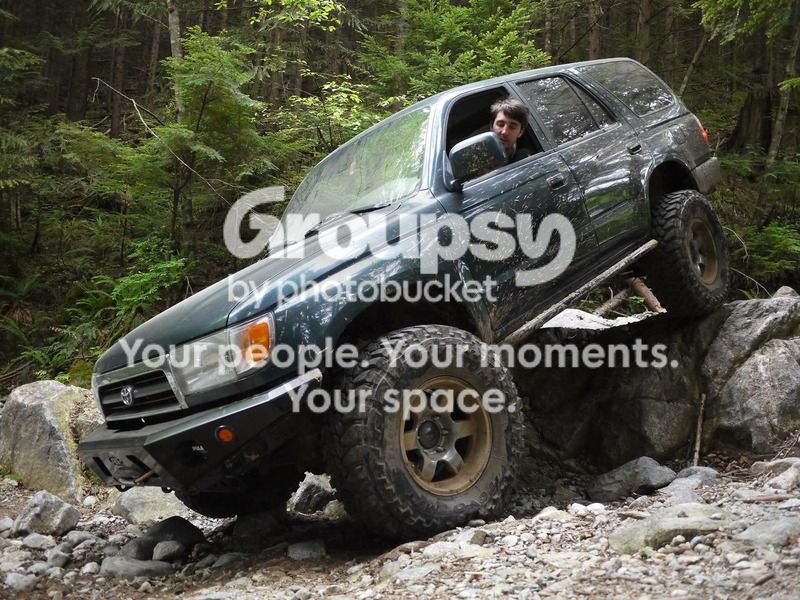

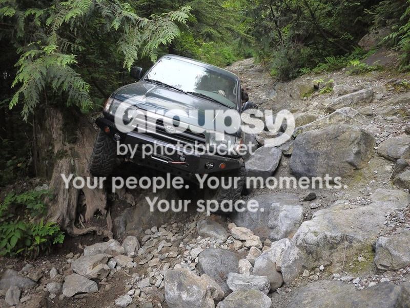

went wheeling...
IMG_1040.jpg~original
Quick Video: https://www.youtube.com/watch?v=9SOylsAQpz0&feature=youtu.be

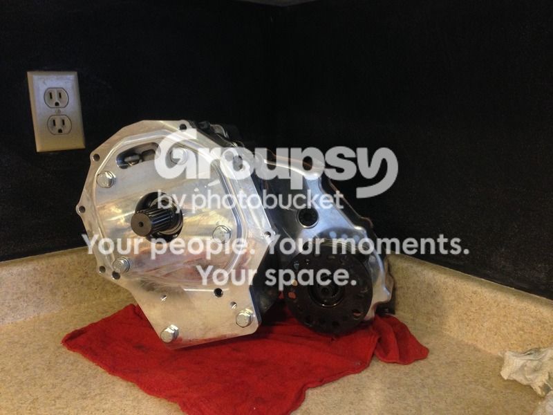

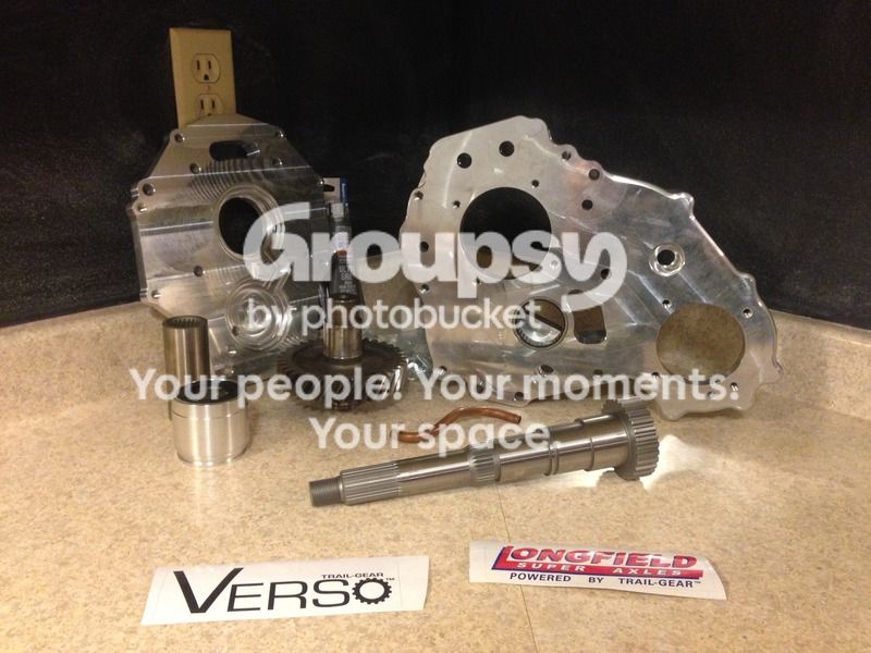

I won't be up to too much more for a while but I really want to get some kind of lower gearing in this thing. I'd like to get a lefty kit for my 4.7 case and a v6 adapter obviously as well. $$$$$$$ but I've already got the case. It will keep my driveshafts the same, and there are no extra shifters. just extra slow. You wont have any indication that its there... just how I would like it. I really don't understand how people put up with stock gearing and larger tires/ difficult obstacles. it sucks :-s . I'm also going to need new tires in the future. The Iroks wear SUPER fast and vibrate always. they were cheap but i'll be going back to KM2's for sure. they are soo much smoother and easy to balance.
That's all for now. \m/
thanks. i'm actually not done updating. just got tired last night. heres where things get a little unconventional.

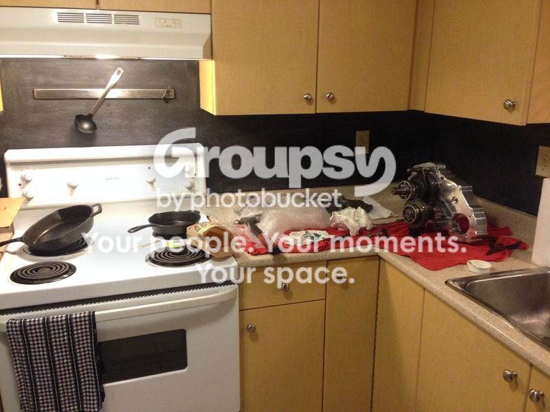

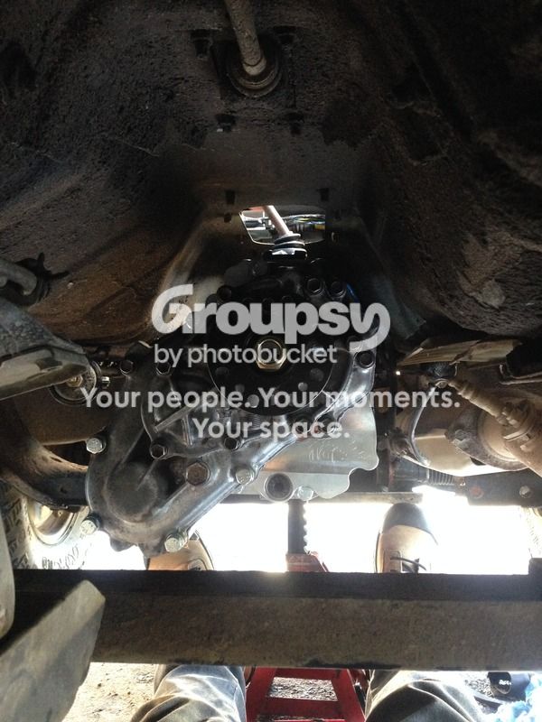

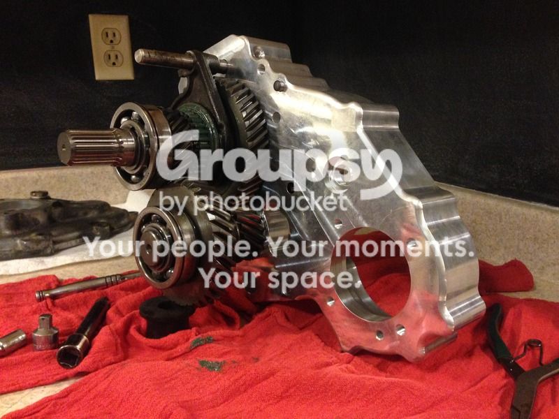

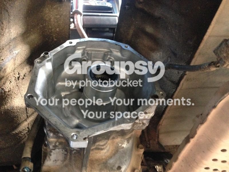

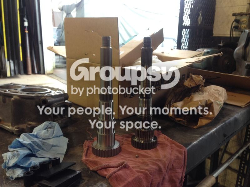

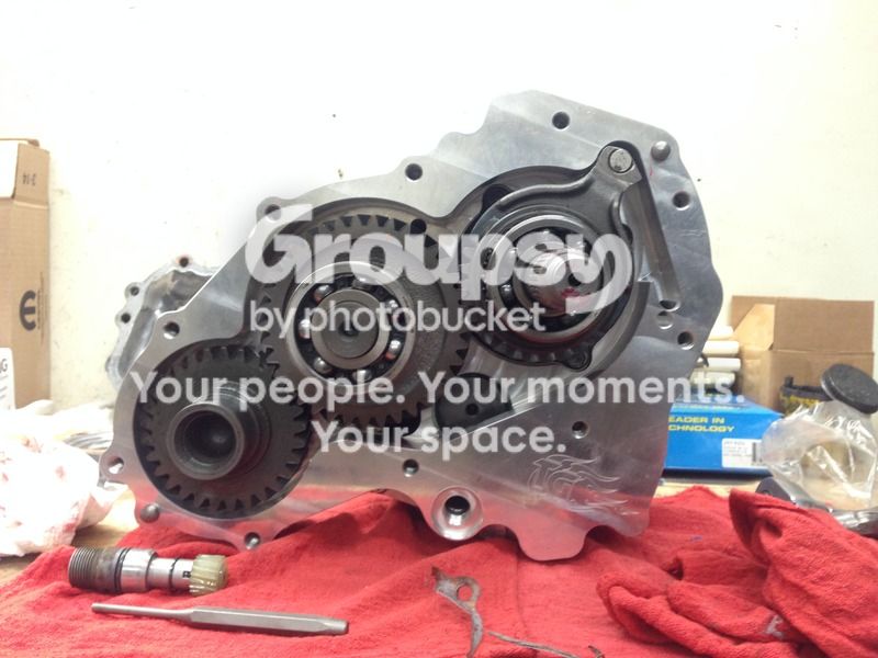

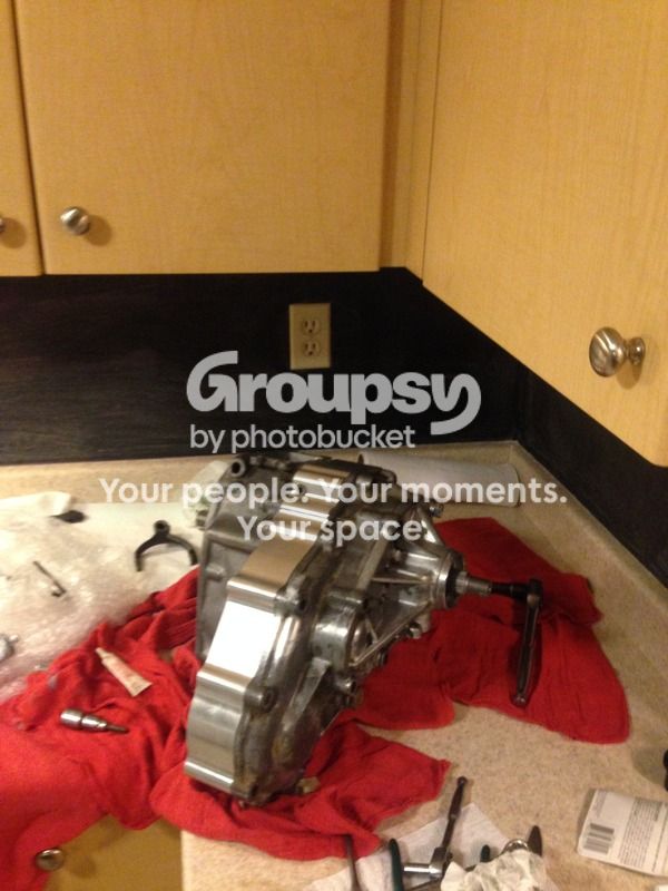

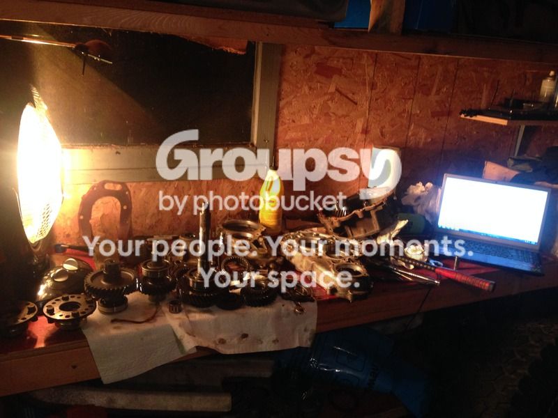

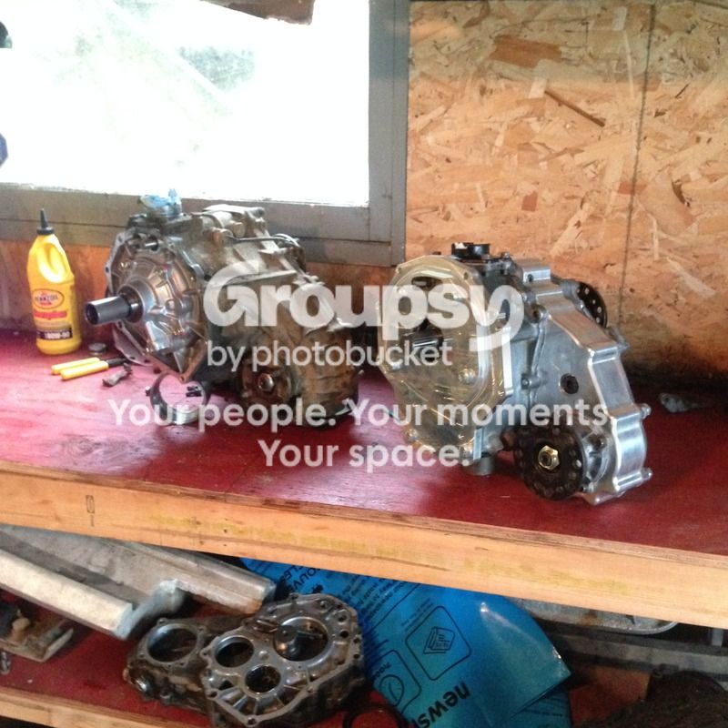

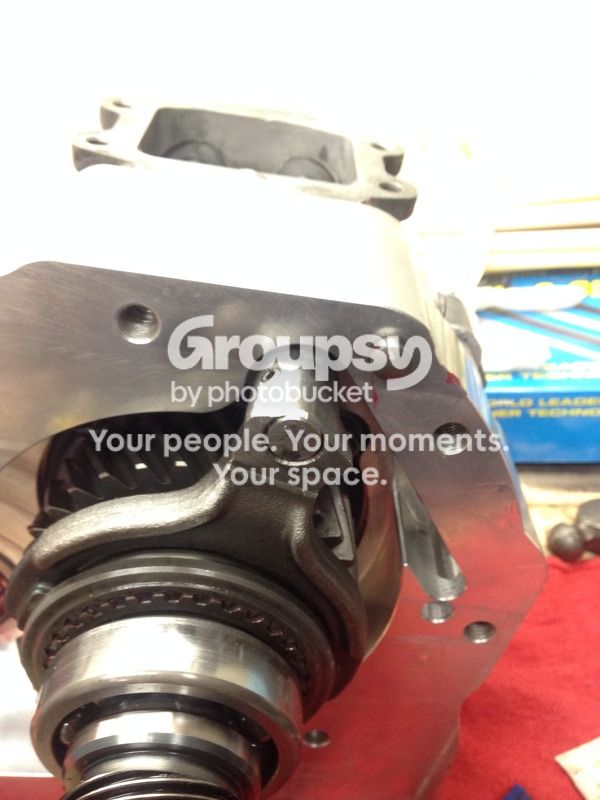

I bit the bullet and bought the Verso Kit when it became available so that I could make use of my 4.7 marlin crawler competition series gears. Its awesome having a really low low range with a 5 speed. no more stalling it like a noob lol. I pressed the gears that needed to be pressed at work. clearanced the case and shifter at a buddies house and assembled it on my kitchen counter. Since the 4Runner is quite a bit heavier i added the heavy duty output for good measure.
Some simple wiring made the 4wd switch work with the add. You do need to cut and weld the gear drive shifter to have it come up in the stock location, which I did so it looks stock on the interior.

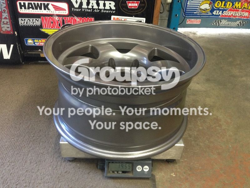

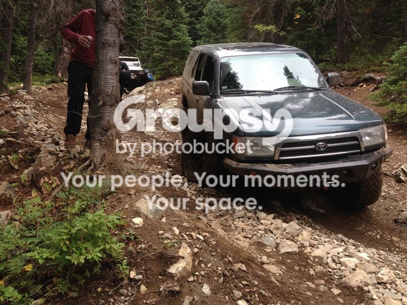

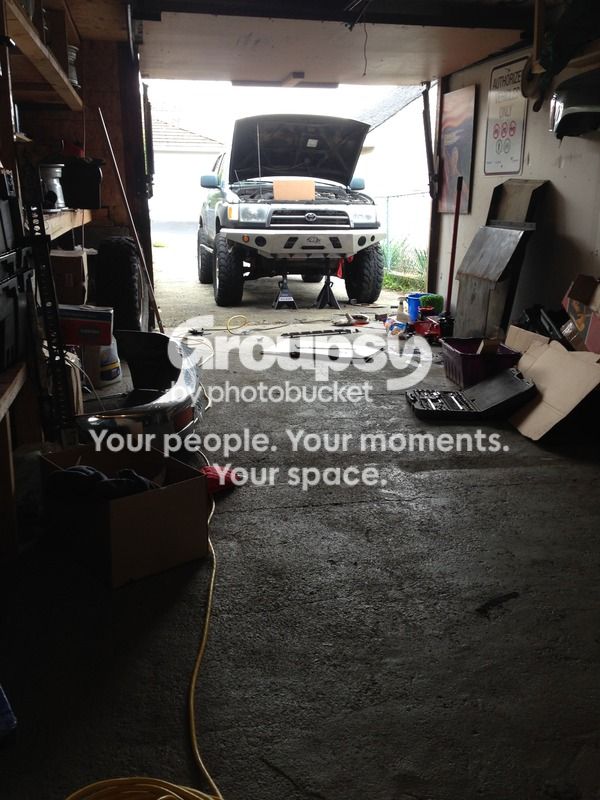

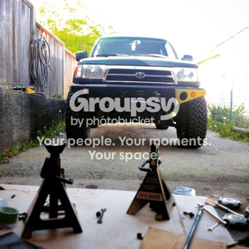

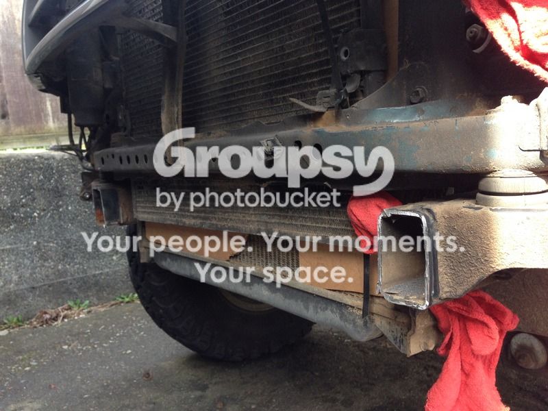

After Tons of research I decieded i wanted an allpro Apex front bumper. I also decied i wanted to use the 16x8 3.625"bs wheels off of my old truck. I got them powdercoated because their finish was starting to look a little crusty. went with 285/75r16 Open country Mt's... wishing i went 35's now.
And then IFS derped...

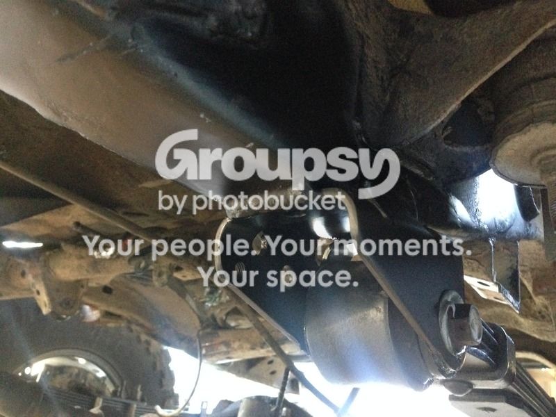

So as of right now (Nov 25th 2015) the truck is undergoing some changes I really want to put an 80 series front axle in it so I no longer need to worry about wearing out ifs parts. I plan to use the whole suspension setup from an fj80. I know it has limits but its simplicity and reliability is what I like. But that costs a lot of money so I started addressing some other issues.

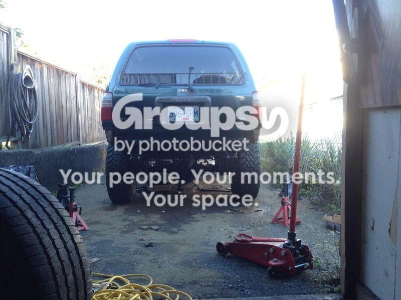

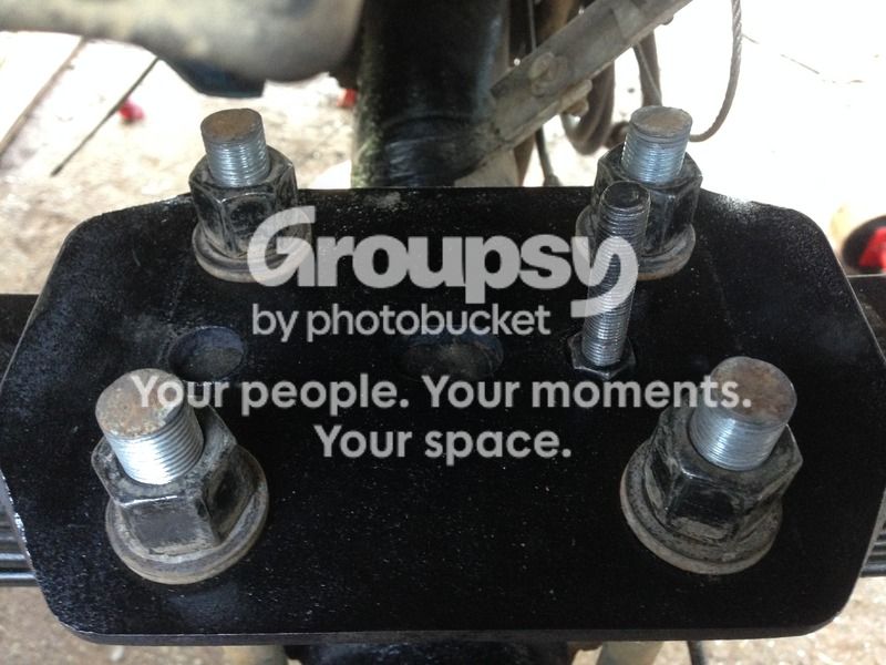

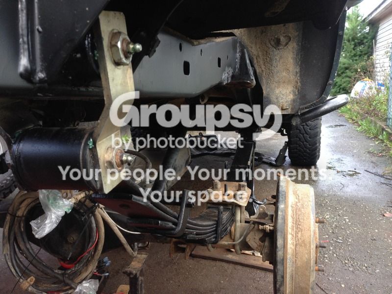

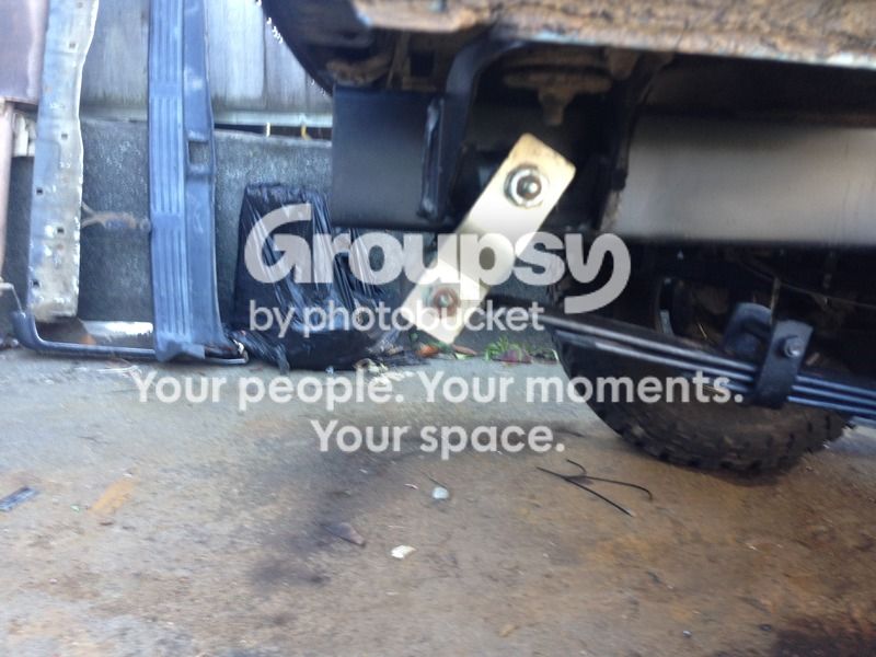

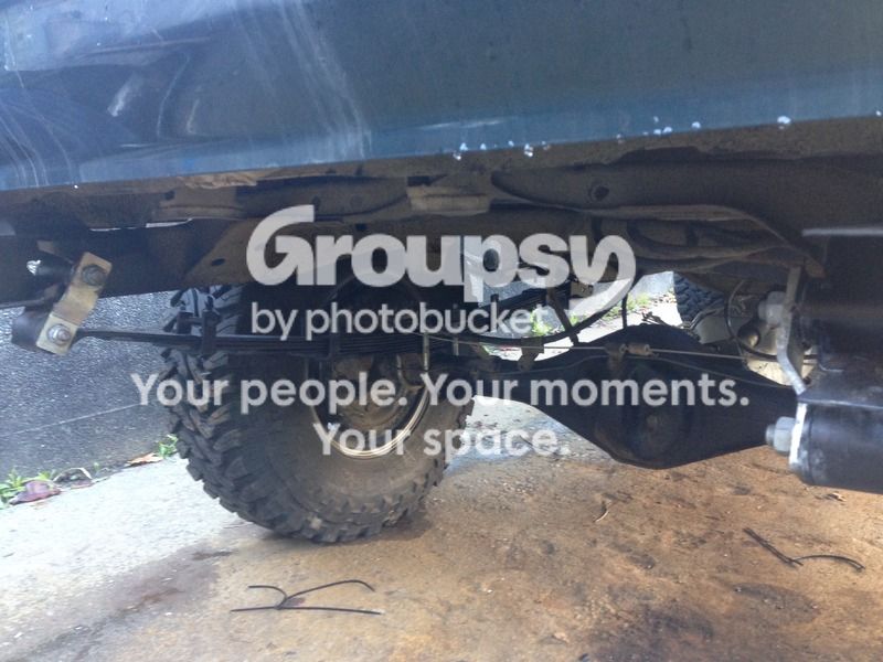

I've never been a fan of the rear link setup. It puts the power to the ground but feels more quirky at speed than the leaf spring setup in my old truck. the lower link mounts ( and Gas tank) have been a constant issue offroad getting hung up. i'd rather have more clearance without having to lift the truck muchso they both had to go. I have my All-pro 3" Tacoma springs from my old truck that I am Using on the 4runner. To keep the ride height down I'm using OEM 3rd gen mini truck spring hangers (14mm hole not 18mm) Old Man Emu front shackles for a solid axle truck (3.5" long) run through the frame with some SAS shackle tubes.

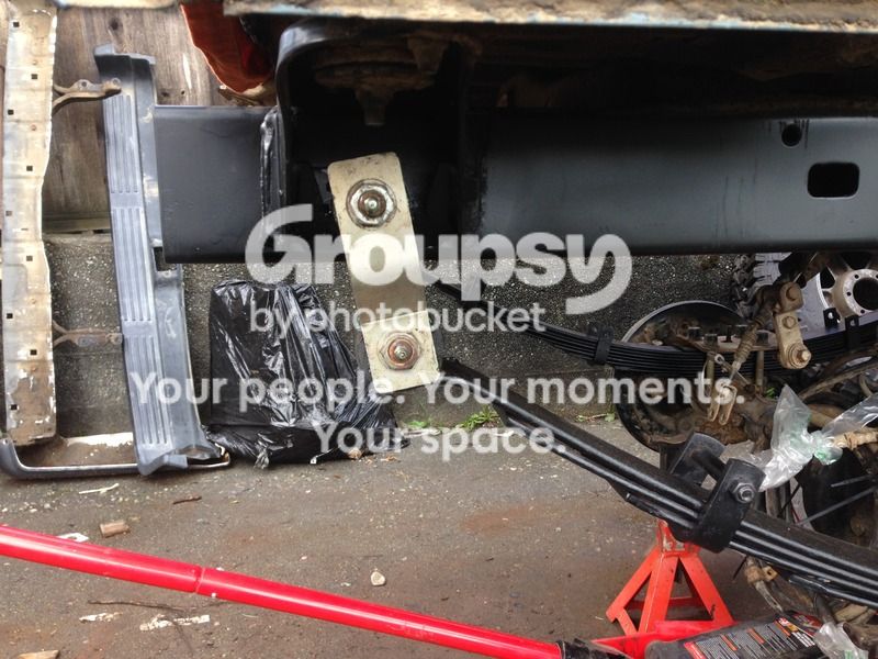

In order to make this setup work I had to run the shackle tube through the rear body mount bracket of the frame. there was no other option. from there I measured the distance i wanted between the shackle tube and the front mount. I cam up with this measurement by determining the springs flat length and making the mounts just far enough apart that the spring wont contact the frame when the spring is flat. Again this is to keep it low as possible and since the maximum shackle angle I can have without the spring hitting the frame is 45* i know my shackle angle will be less than that by a bit which will work out well. if anyone is curious of this measurement it is 53.25"
Shackle angle with the axle hanging.
And at ride height
I know what you are thinking... the spring is going to hit the frame! Its so close! BUT Since the spring is close to flat at ride height there is very little spring growth. I Was to lazy to unbend the spring clamps to cycle it with just the main leaf but i am confident it will not touch.

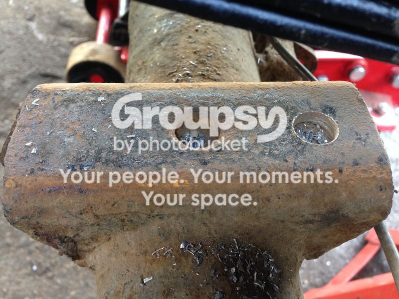

Mounting the springs to position the shackle mount inside the body mount moves the wheelbase back a little to far for a stockish truck so i re drilled the perches and U bolt plats to move the axle forward 1.25" it will be an easy stretch if i ever decide to. Having a nice fresh center pin hole on the axle is nice too. they tend to wallow out over the years.
I still need to figure out shock mounts and shorten the ebrake cable a little as the axle i am using is a Minitruck IFS width axle out of my old truck as well. :)
Next up is a rear cross memebr and f150 gas tank.

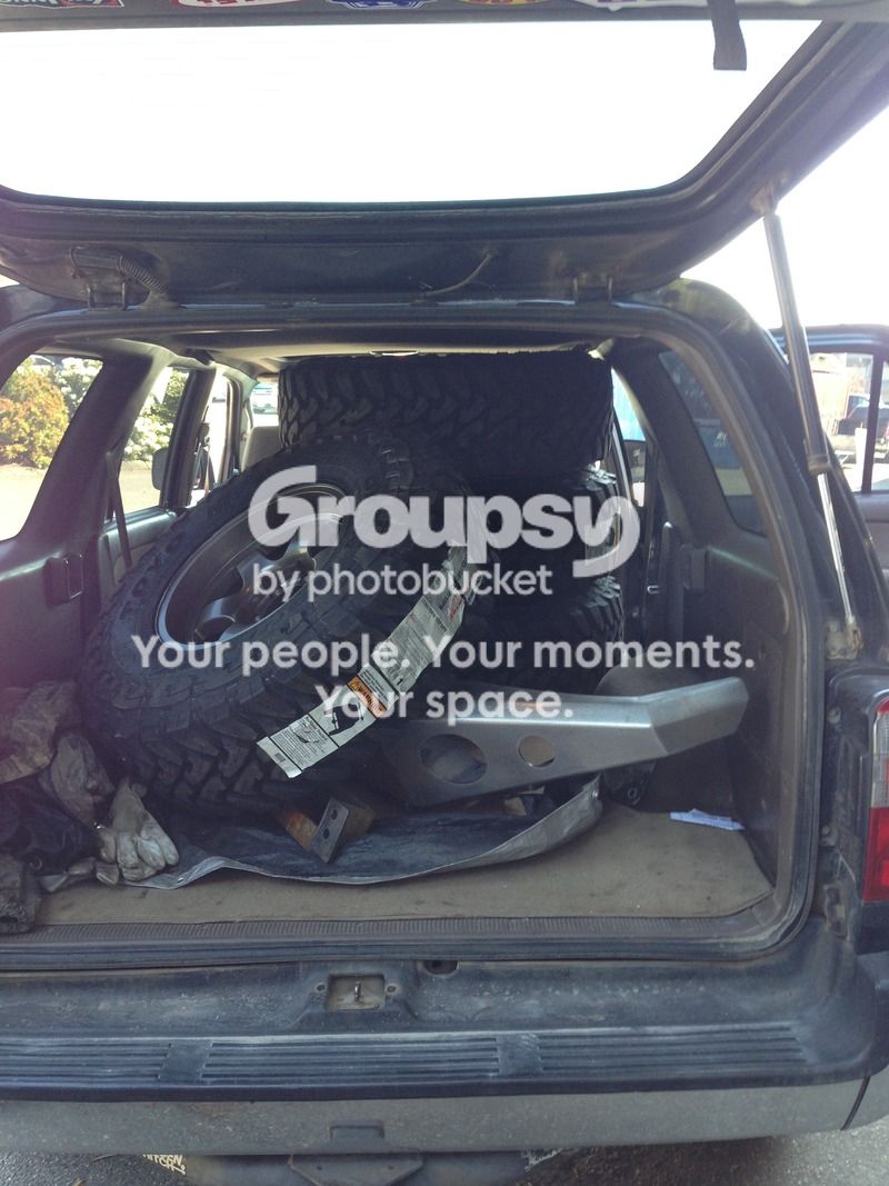

Firstly I built a rear bumper because i needed a rear crossmember because i was removing the factory spare tire crossmember for an f150 tank. I didn't like the options available because a lot of bumpers seem to be geared towards the overland types. They are bulky, heavy, and sacrifice ground clearance. I'm also not one for having all sorts of junk hanging off of the back of my 4Runner :crazy: I couldn't find many pictures so i stole some from my Instagram...
I took Trail-Gears Tacoma rear crossmember kit and put an unnecessary amount of holes in it in an effort to keep the weight down where it isn't needed.
Here it is Almost done test fit into place. No step yet. I actually had a local shop bend the tube. It took some careful measuring on the truck. I actually made a jig to get the correct bend angle and distance between the bends as the shop was a 40 minute drive away. it worked out perfectly!
And on + painted with the rear step. I used TMR Customs dimple dies in a makeshift press to make the dimples.

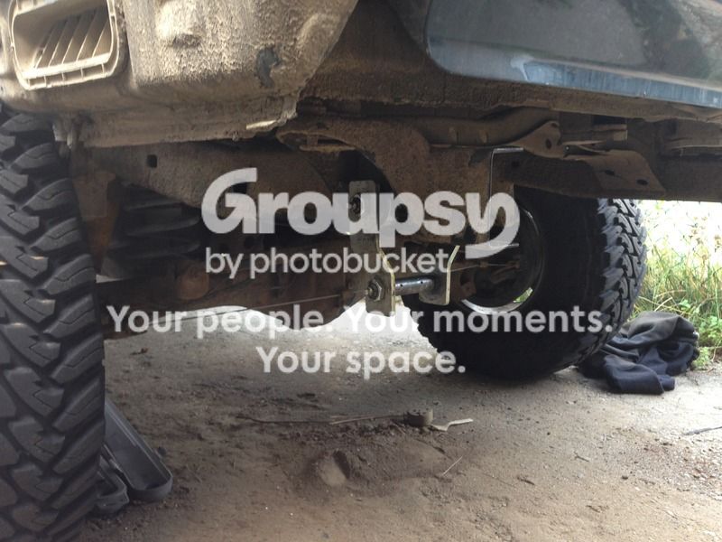

Not Much has happened since. but here are some pictures testing for shock length. No Shocks or Bumpstops. This ammount of flex would only use aproximatly 7" of shock travel when they are mounted just inboard of the leafspring and tilted slightly forward. I'll be using OME shocks for a FJ60 that have about 9" of Travel.
Notice how the tire does not suck way forward on droop :) and no low hanging tank or suspension mounts. Skid plates or not it nice to just not hit them.
Front doing nothing. I may switch to 882's from the 883's I'm currently running. The 883's are a shorter free height but higher spring rate. 881's will be too low.
