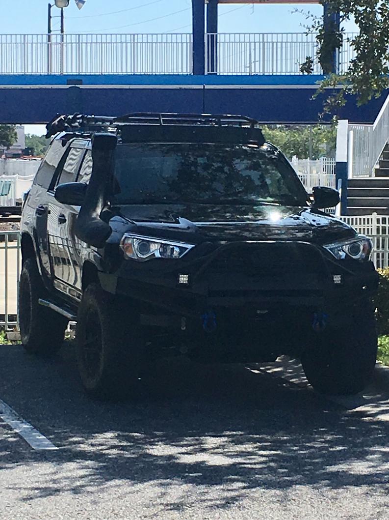

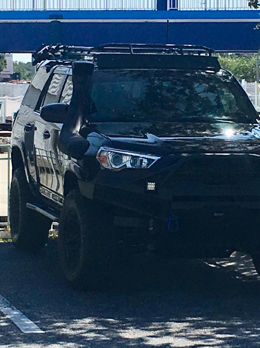

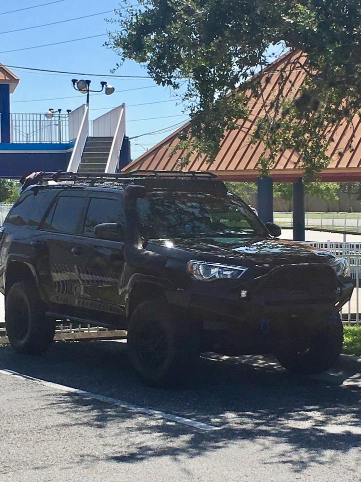

Crappy pictures but finally finished installing

[MENTION=137555]Sleeter[/MENTION] [MENTION=133021]propain[/MENTION] [MENTION=140508]DesertEagle[/MENTION]
can yall share some info on what ditch light brackets y'all used that work with the snorkel?
I think the CBI ditch light brackets place the lights further outward than some of the other brands available (Rago and CaliRaised are the only others i know of) which seems like a better mounting spot for a ditch light but likely make clearance tighter with a snorkel.

Im using the CBI bracket, I know others are running the Rago. I would went with the Rago if they had been available when I ordered.

Cody, I use the Rago ditch light brackets and never had an issue with space.
