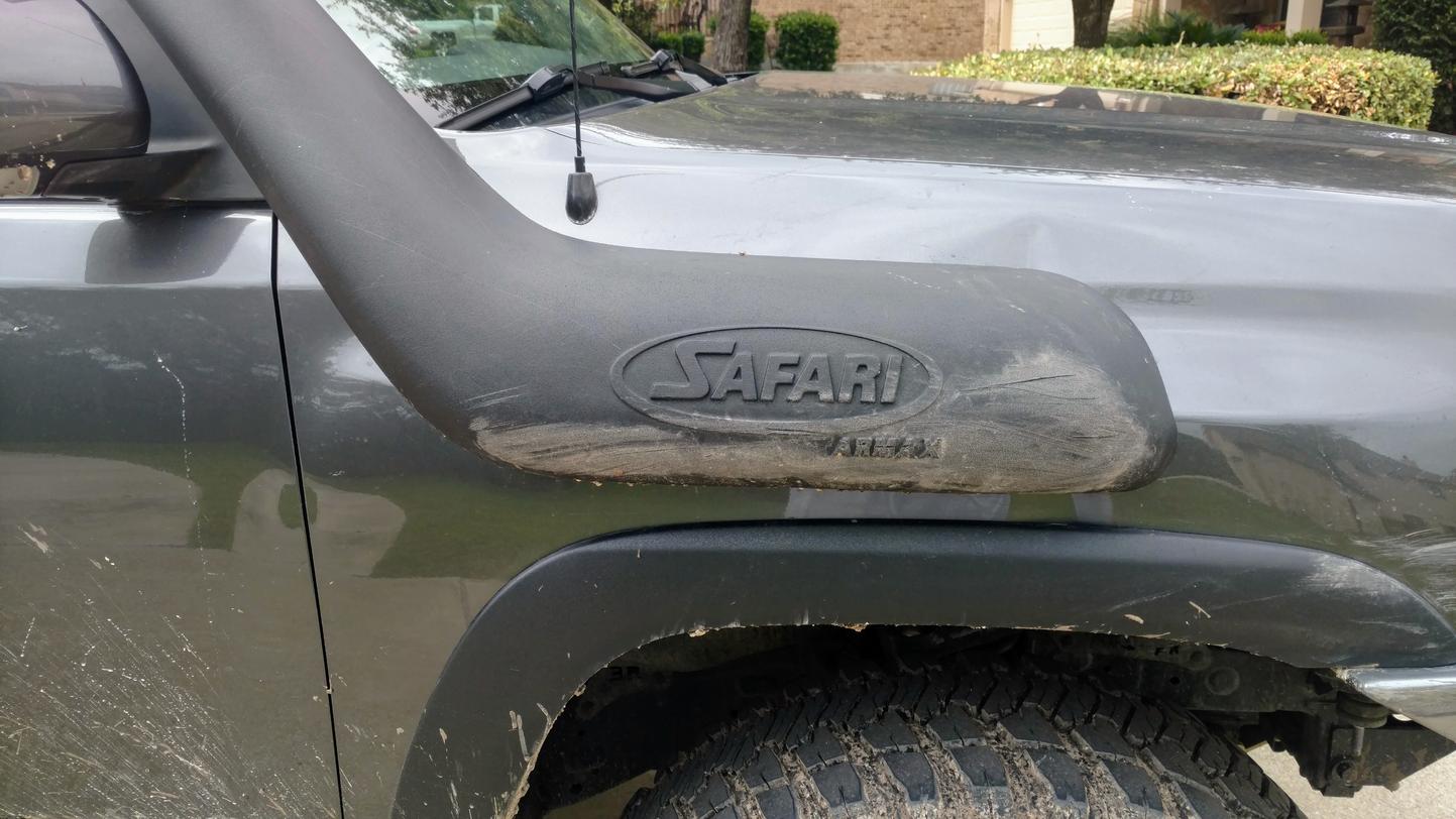

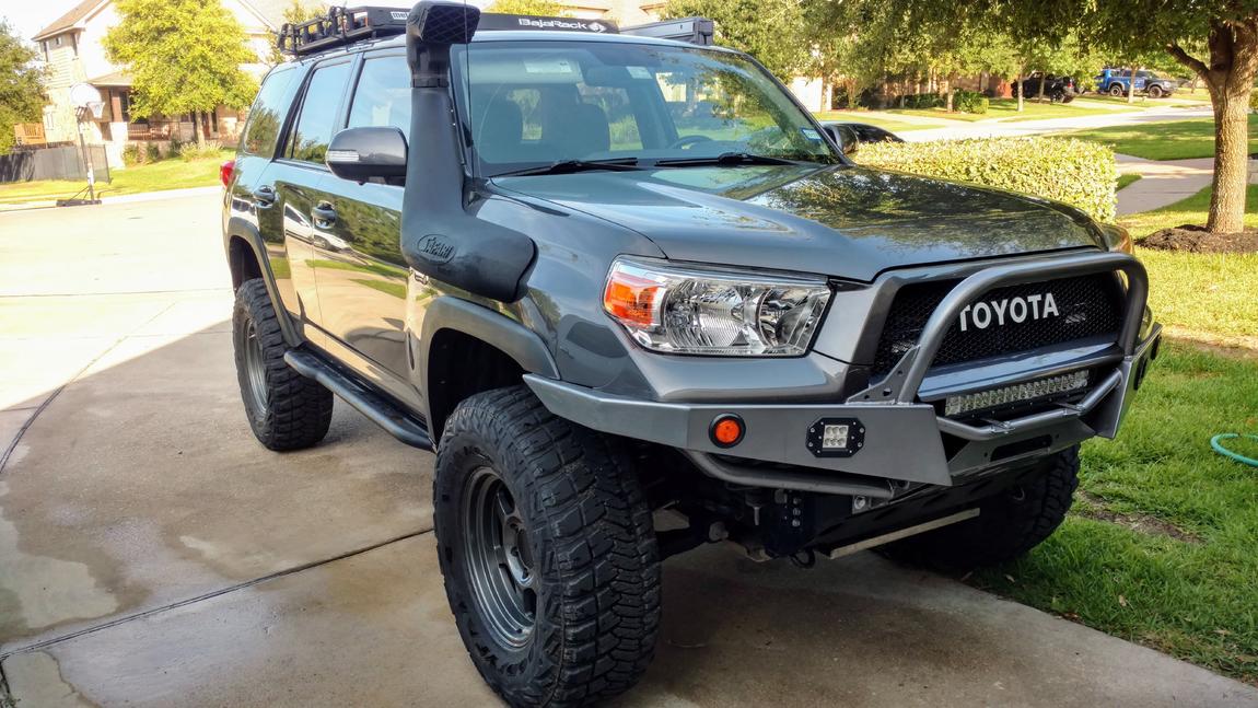

Warning on this snorkel if you wheel your rig hard on tight trails.
I wheel my truck very hard on a regular basis in rocky conditions.. but somehow I've always avoided body damage. Last week I was out on a very tight trail that I have run several times. I was in the lead without a spotter. I thought I had cleared everything as usual, but when I got done I walked around the truck and found that my snorkel had scraped a wall and dented in my fender. I never felt or heard anything....
Anyway... the fender is very weak once this thing is installed. There is no bolt holding the upper portion in place (towards the top of the fender near the front), so if you hit something it will dent the fender right there for sure. I really wish they would have added a stud there as it would have made a huge difference the strength of the fender against minor impacts. I found this problem on my first time out with it on. Sure would be a nice revision, but doubt that will happen.
I was able to get a PDR guy to fix the dent and was able to recondition the snorkel to look decent again.... The rattle can bed liner is a pretty good match to the snorkel finish...

wow what a design flaw!! I cant imagine why running into a rock wall would dent a fender... :confused:

I see it as a bit of a design flaw personally, but to each his own. Does not take a rocket scientist to figure this out.
If you don't push it hard.. not a problem. It should spread the load across the fender. The lack of an attachment point in that weak area of the fender after it is is cut is a small design flaw in my mind. It will always be the first thing to hit.... And you are going to see a lot of dented fenders.
Seems like real world use would be useful input... but I forgot this is the 5th gen forum where nothing can be improved on.... :confused:
Some good tape might be a solution worth trying.

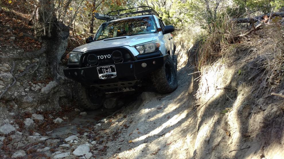

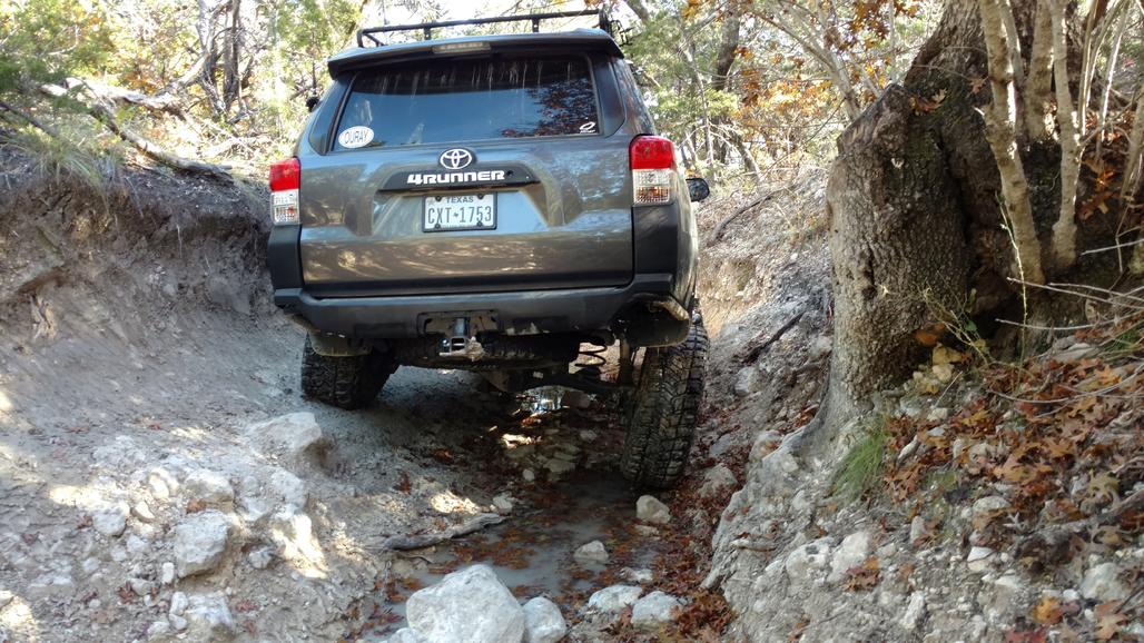

Yes, one way in... one way out.. It's an old creek-bed... It probably happened in a spot like this... The trail has about 20 tight off camber squeeze spots. Not that unusual on technical trails, but not ideal for 5th gen.. (Jeeps and anything with wide tires outside the body will more or less self correct....) Snorkel makes them all a bigger challenge. I've done the trail 5-10 times without ever having an issue. But this was first time with the snorkel and I guess I was over confident....
