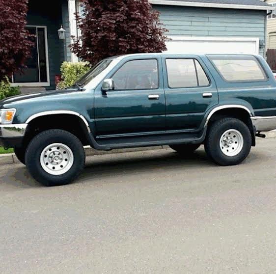

alright so im wanting to do a 3 inch lift up front. what should I do for the back to get it to level out? what coils?
You can buy spacers for the rear to level out, cheaper way. Or get springs that are 4"-5" lift that are stiff springs that won't sag when you have stuff in the rear cargo area. Lots of options. What are you using for the front?
